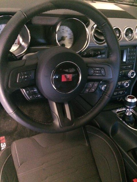

No more glare form the wheel- took off the trim pieces and plasti-dipped matte black. I might start doing other shiny interior pieces now....

how did you take the trim off? might try to wrap it in CF

Tinting is coming this weekend, and I'm going to attempt the door handles soon.
Trim removal is a breeze:
1. Disconnect battery
2. Remove airbag/horn by inserting a screwdriver or small object through the side access holes to compress the retention spring and pull gently on each side.
3. Remove the trim torx screws
4. Pull trim pieces gently from the edges to release
5. Disconnect the connector behind the trim
6. Remove 3x torx screws to remove the button modules
7. Enjoy, and repeat for reassembly.
