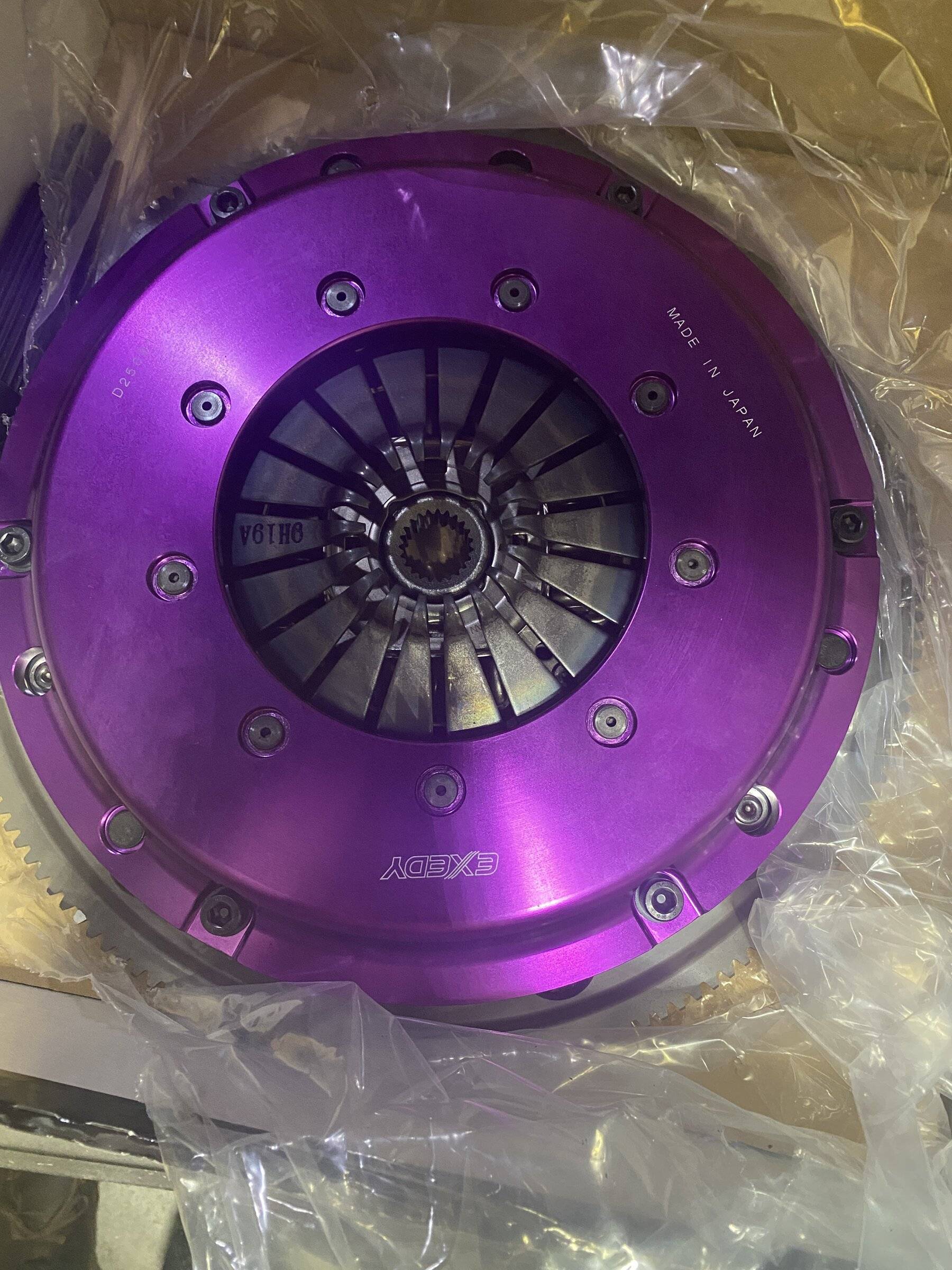

1) my TOB and slave cylinder went bad. It’s was causing a dead clutch pedal. I got it replaced under warranty and since they were dropping the trans, I used that time to upgrade to the Exedy Hyper Single Clutch. Amazing clutch but I quickly learned the difference between a track focused clutch and street clutch. Took some time getting used to. I have issues engaging first when the engine is running some times but I’ve been trying to fix it and no luck. Still under powertrain so if it goes then it goes lol

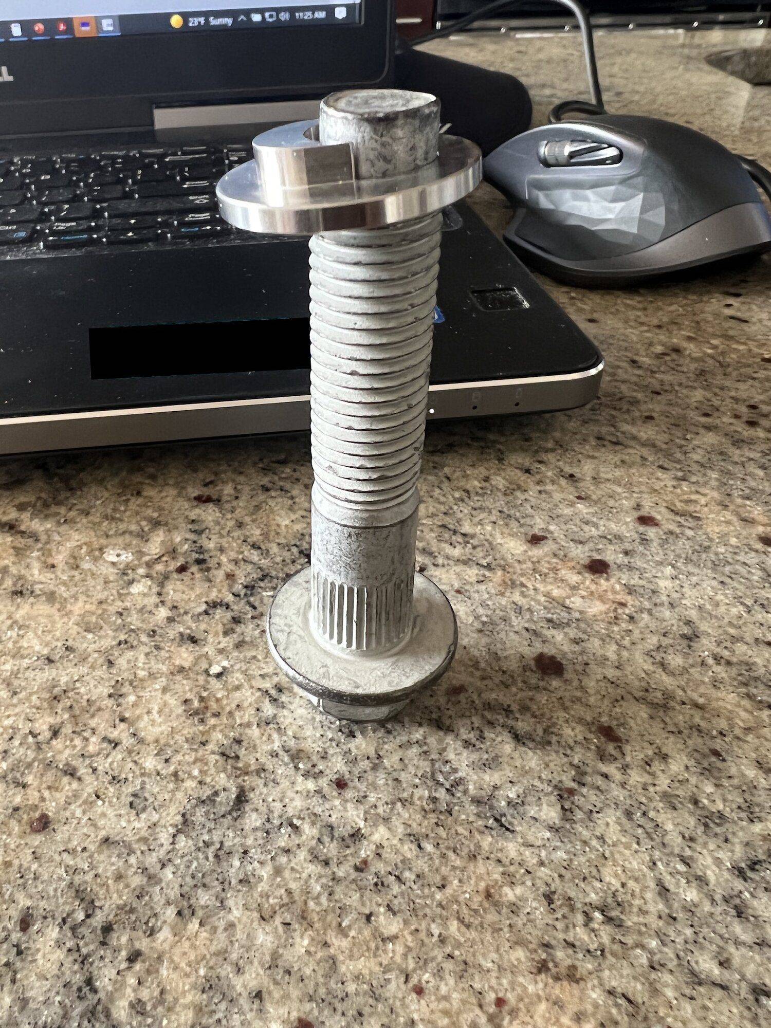

2) switch out the SPL links because I could not torque them down. The torque spec is 30ft lbs which I thought was too low but I ended up snapping one of the ends so they sent a new heim joint. Kept hearing clunking from it being loose so I replace with Whiteline links.

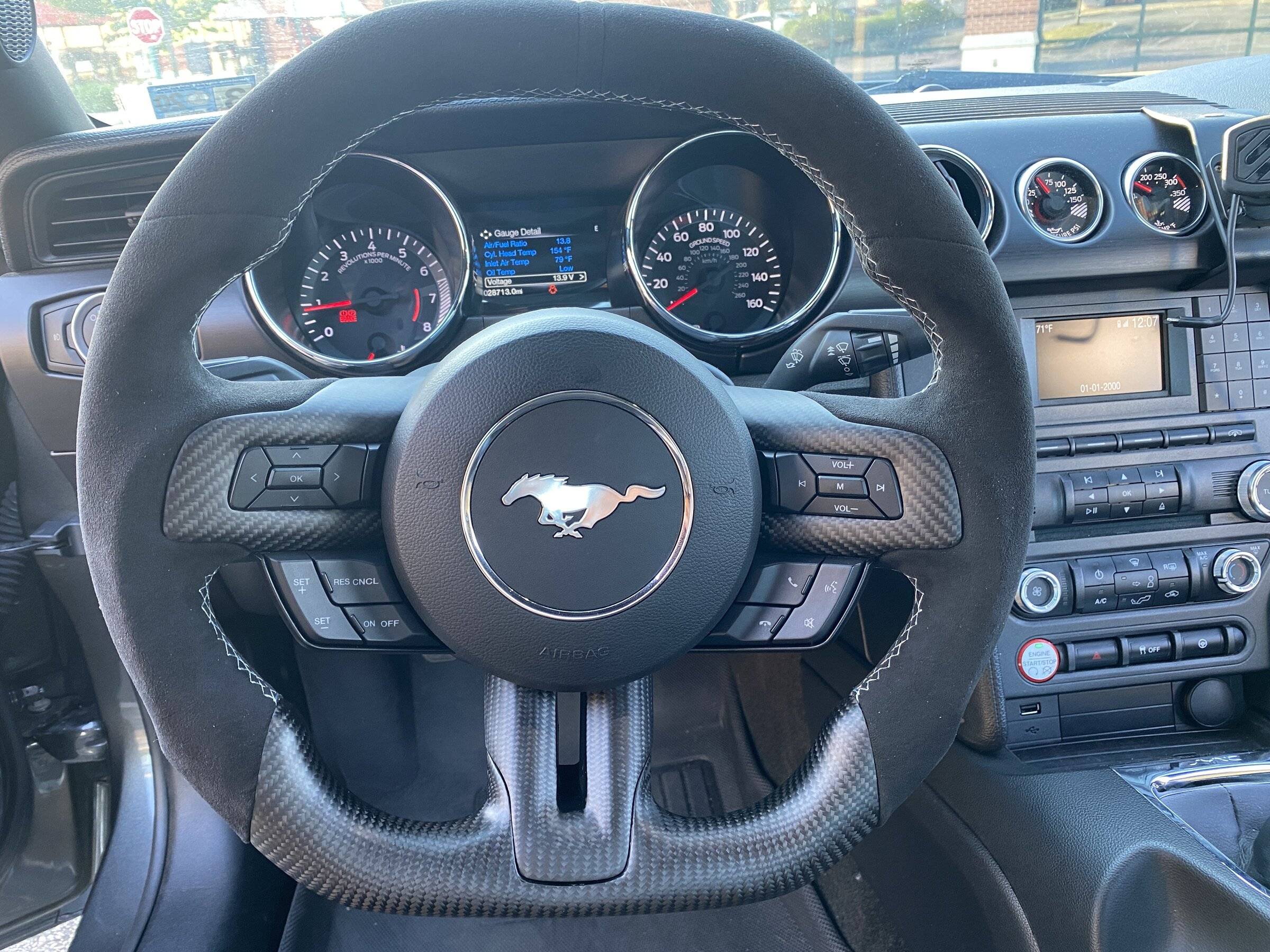

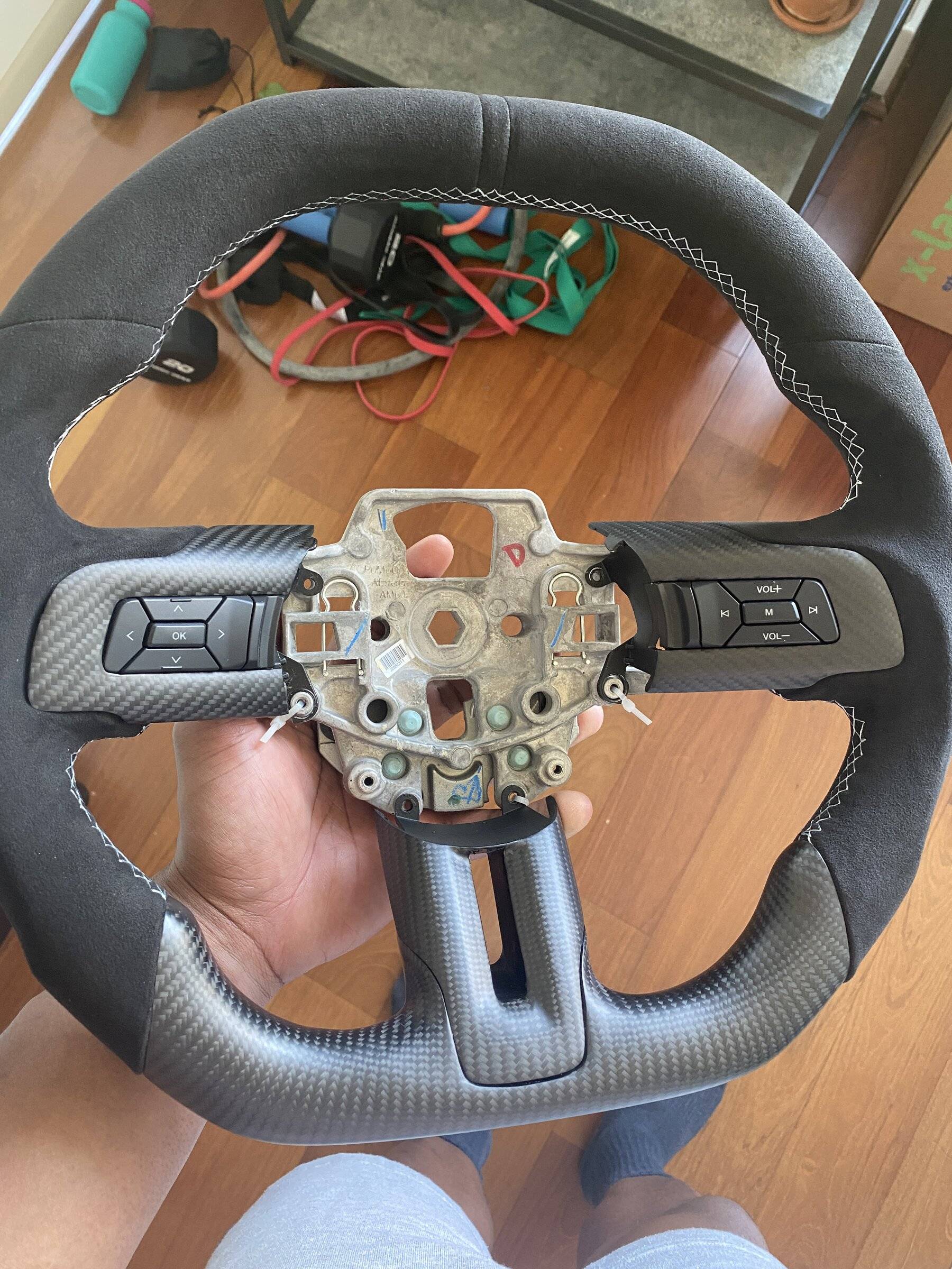

3) wanted an Alcantara steering wheel for track purpose but wanted a thicker grip than the GT350 wheel. SoCal Garageworks messed up my order so I went with Beith and it came out amazing.
4)replace my PP gauges with GT350 gauges and dash trim

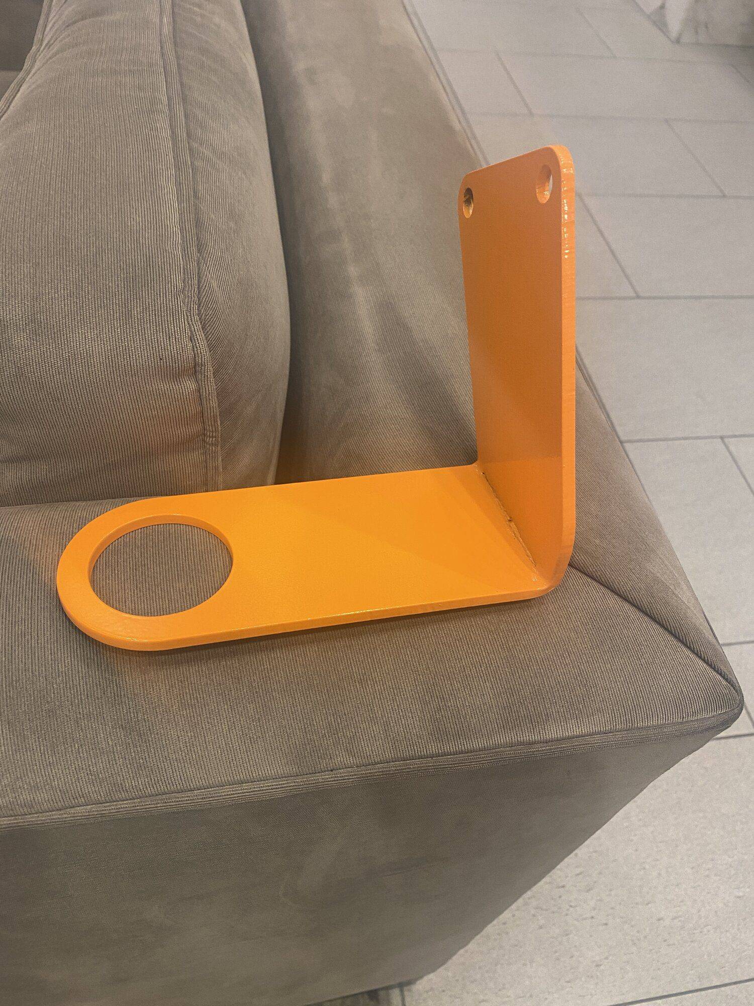

-install my rear Vorshlag tow hook

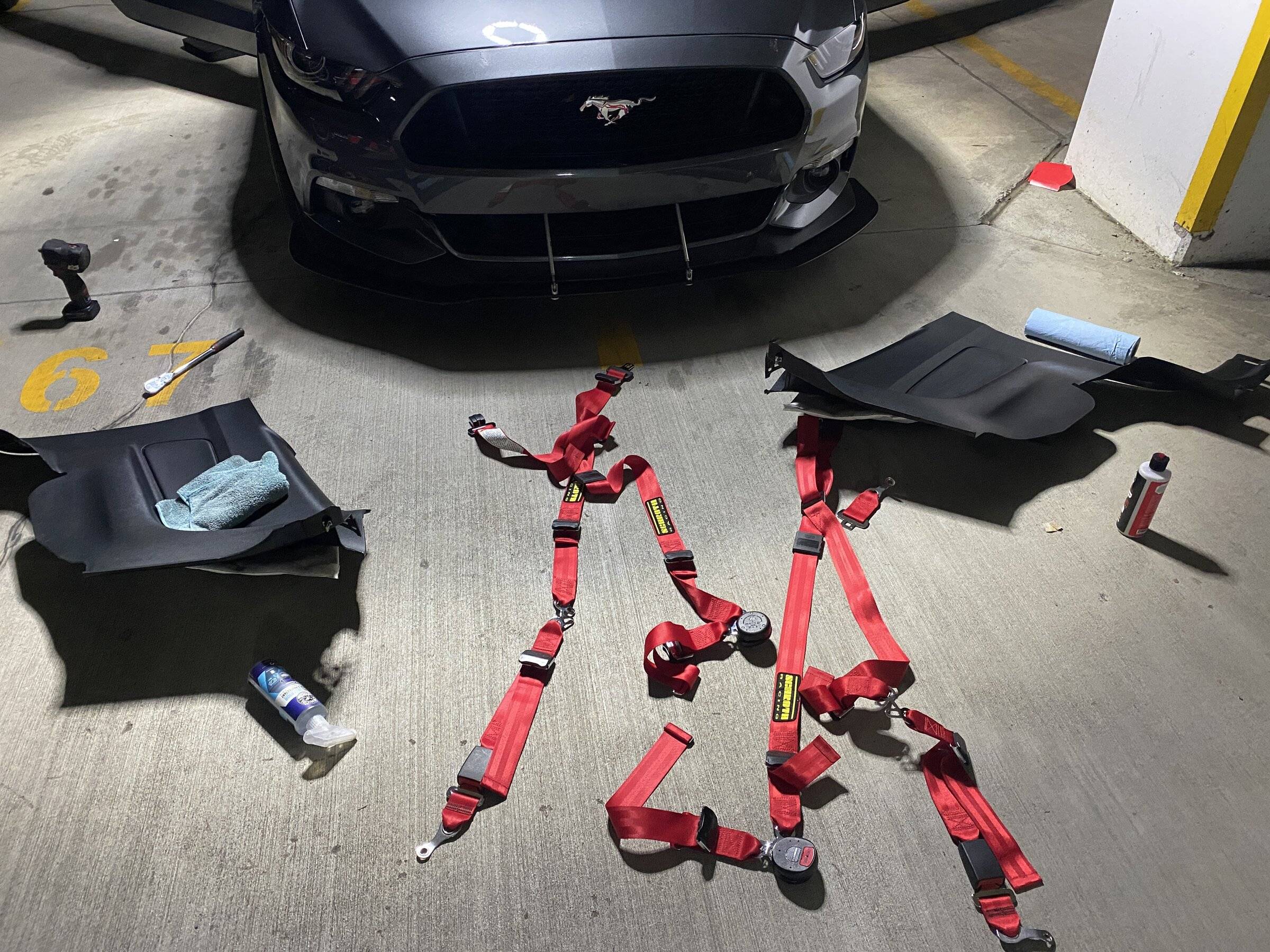

- purchase/install CMS roll bar, race seats and harness (should help with back and fatigue)

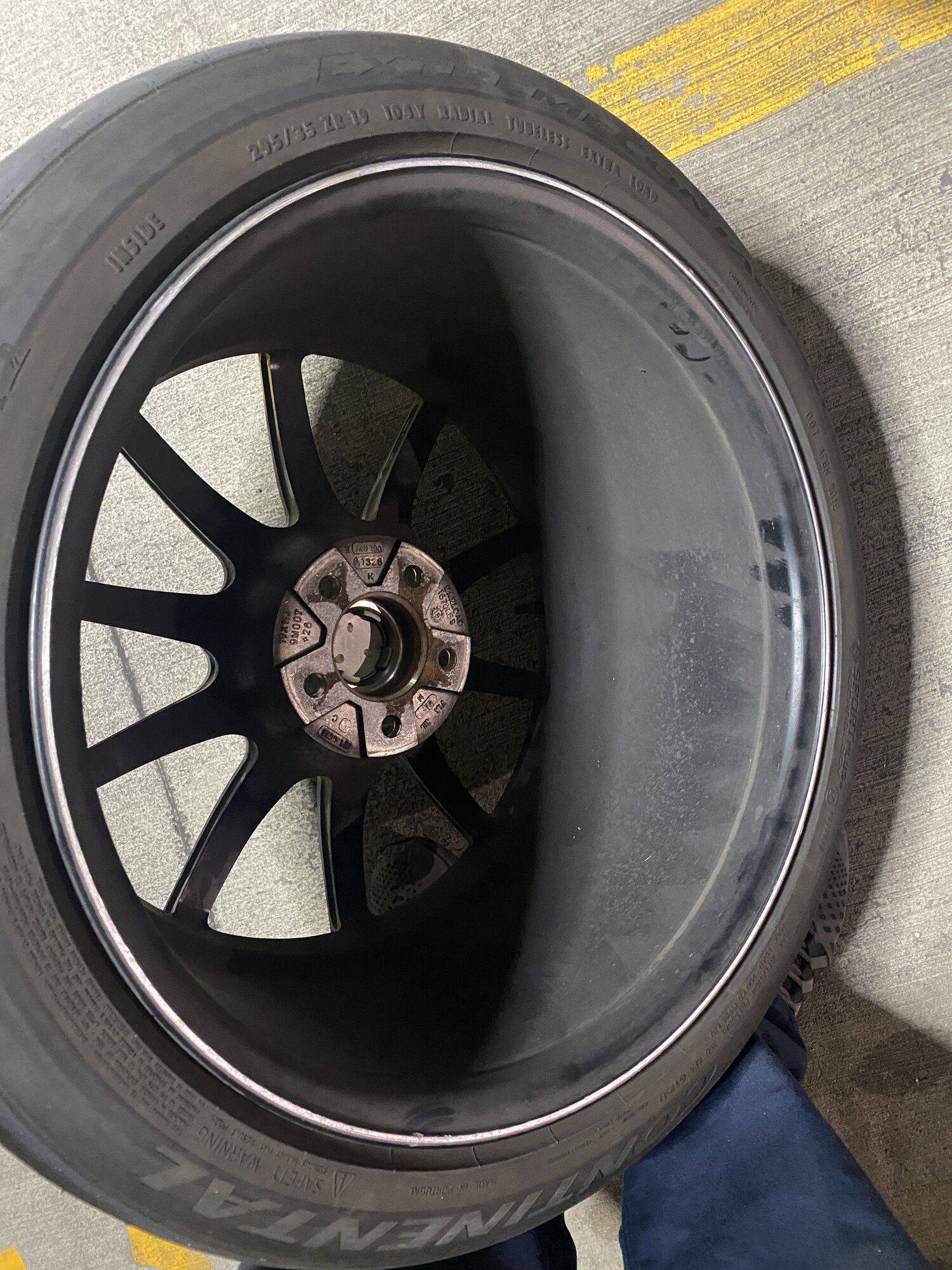

- run the new continental extreme contact force in 295/30/19.

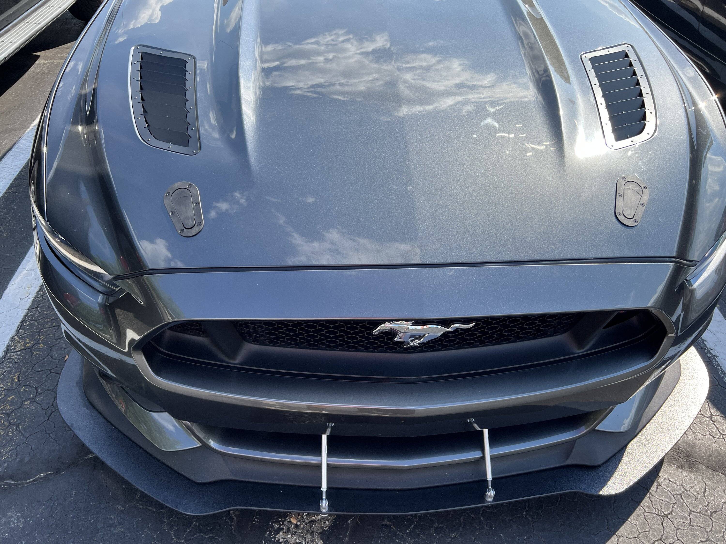

- APR GTC 200 wing with front splitter (don’t know which brand yet).
- Race Louvers Center hood vent

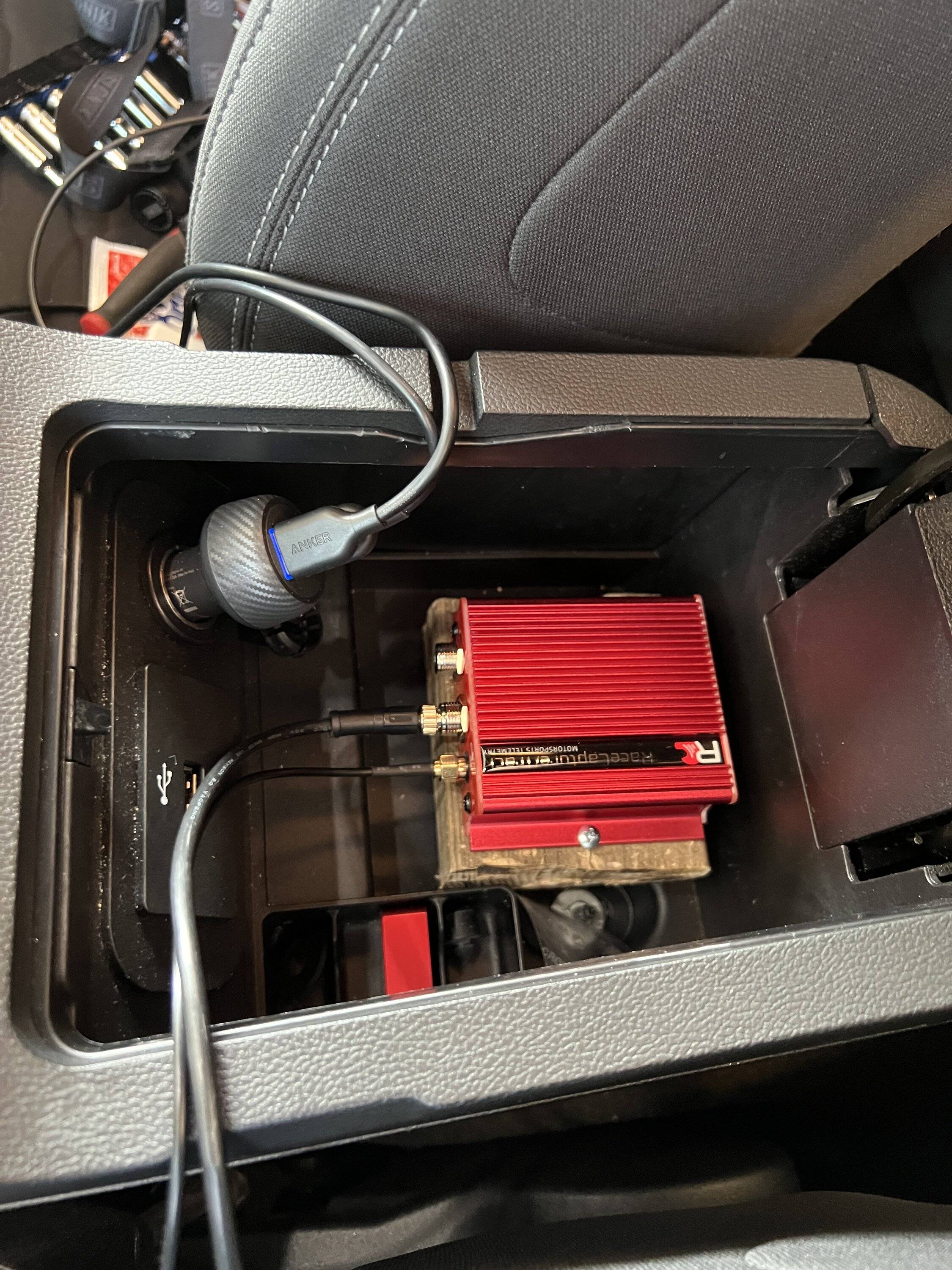

- RaceCapture MK3 for data logging
