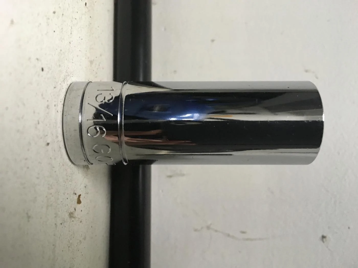

I know it is supposed to be 21mm but for MY sockets (emphasis on MY) the 13/16 one fits with less play than my 21mm. 13/16 is really 20.6mm so is slightly smaller. Most problems usually happen when the SAE is slightly larger than the metric equivalent.Do not use a SAE socket. Every OEM fastener on the GT350 is metric.
BTW, this is th socket in the picture above:Yes, it's 21mm but a deep socket is not absolutely necessary. I ran all over town trying to find a deep 21mm socket and none were available. Looking closely at my lug nuts it seemed clear that a standard depth socket would work fine and does. I used a 6" extension and it worked perfectly.
That's a great price. I paid a little over $6 for a Craftsman 21mm standard depth socket.BTW, this is th socket in the picture above:
