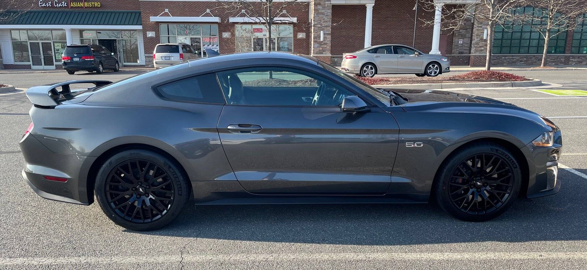

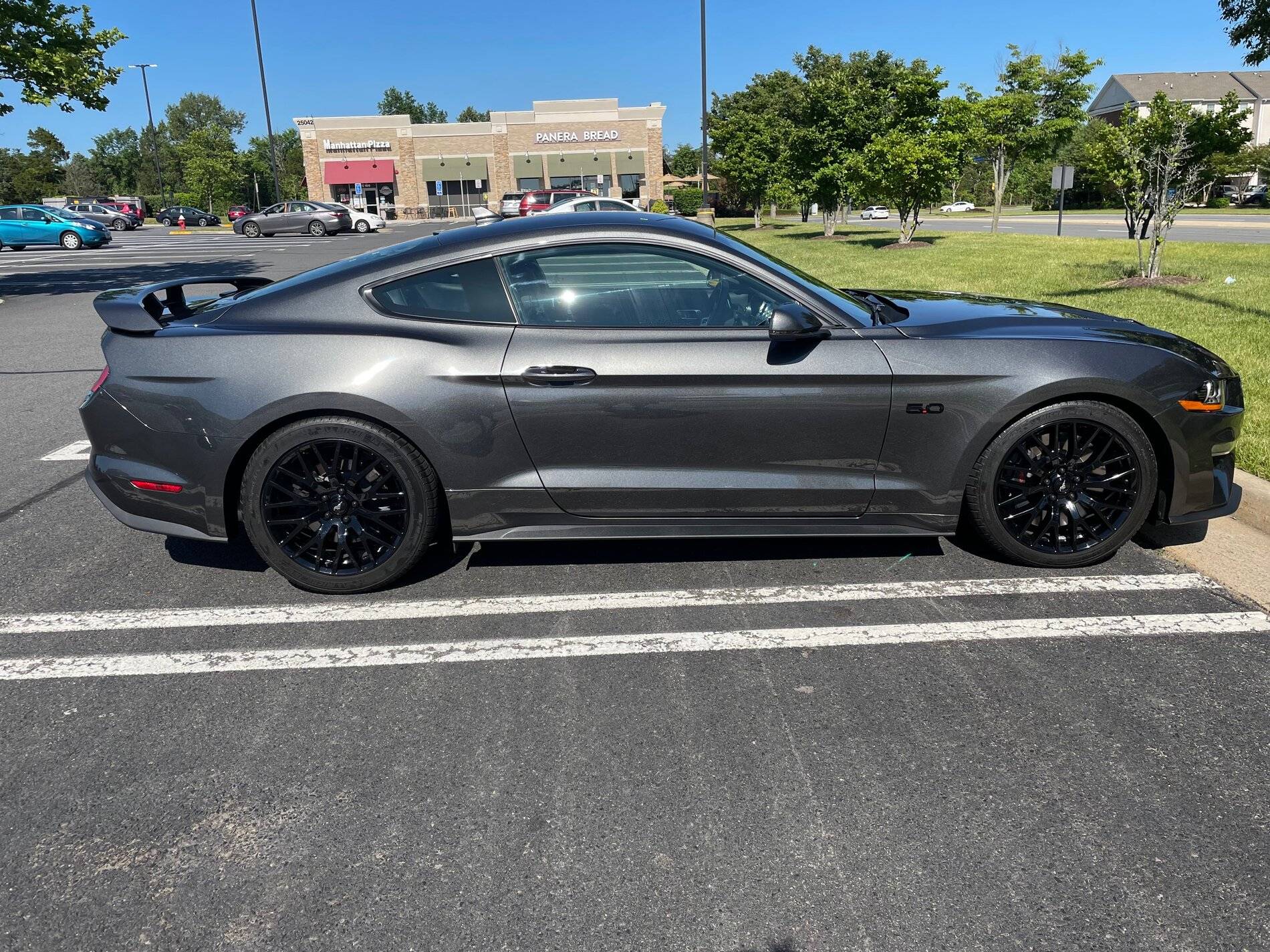

After narrowing my choices to BMR, Steeda, and FP I opted to go with the FP M-5300-W Lowering Springs only because if I have any future issues with magneride the ford dealerhip service can't claim that aftermarket springs caused the problem. Now, this is was individual choice (my car is only a few months old) and I am not trying to second guess what other vendor choices individuals are making out there.
I went with the W springs because I wanted a mild drop (especially in front) and installing these springs addressed that short-coming. I also feel that they ride is somewhat improved in 2 ways. The stang feels more planted during acceleration and hi speed cornering has improved. Obviously these are subjective but nonetheless that is how it feels to me. Finally, the suspension does not feel any harsher l but I live in a relatively pot hole free area.
I did the install myself and took me about 4 hours. I took my time. The hardest parts of the install (not in any order) was 1. removing the brembo caliper bolts they must have been torqued to 1,000 lbs or something from the factory 2. hammering the strut bolts out they were really well seated and 3. getting enough room on the rear to remove the springs (both sides) and install the new ones I needed a second person to push down on the subframe being mindful to not over extend the magneride sensor which I guess I could have removed but chose not too.)
I have attached before and after from far away just to give an idea of the new stand. I did not take any measurements or take close ups. I do not regret doing this mod in any way. Good luck with whatever you chose to do! JB

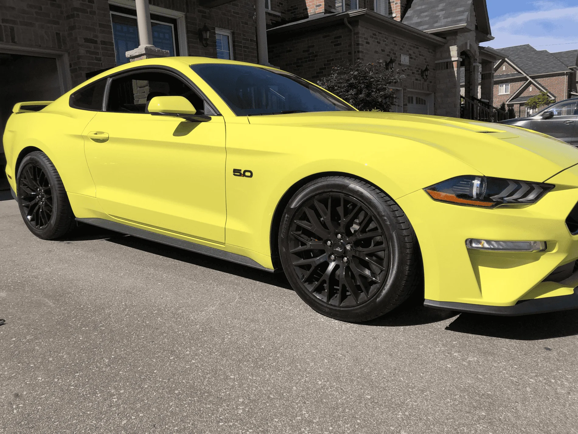

Looks great! I also went with the FP X springs (i don't have magride). And specifically for the same reason as you with warranty. My car is only 4 wees old. I love the stance, especially the raked look as the rear doesn't drop a whole lot more than stock. (i'm good with that). Did you get your alignment done? What is your front camber readings? I'm currently a -1.6 and -1.7. I have Camber bolts that i'm scheduled to put in on Wednesday so that i can get my alignment back into spec, but i'm on the fence. Alot of guys are saying my alignment is good for the street and won't cause tire wear. I might put them on anyways and dial back the camber just for piece of mind. Here is a shot of what mine looks like with the FP Springs
