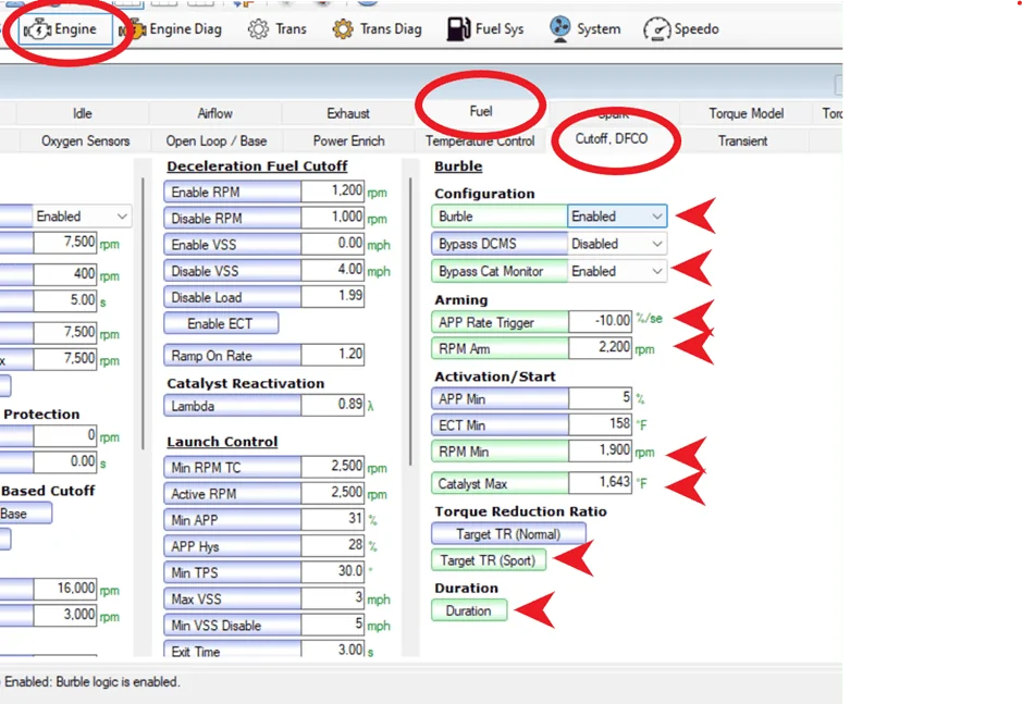

"There is an additional drive mode feature that can be enabled in the tune, and it’s the Bullitt burbles.
If enabled they will be activated in all modes except Normal.
Instructions for HP tuners :
First change these settings under "engine>fuel>Cutoff, DFCO" to the values shown below :

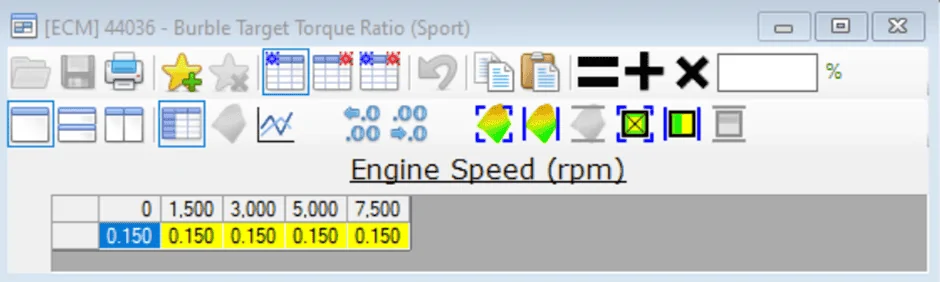

Then populate the Target TR (Sport) table as shown :

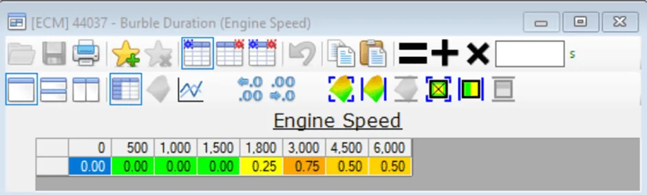

Then populate the Duration table as shown :
This is copied directly from the Bullitt mustang so I have confidence in its safety for long term use. I've been running it for a while now. You can mess with the Duration and Target TR (...) tables to make it happen more aggressively or for longer but I found that the stock values are very good not obnoxious and easy to control. I think if you copy the Target TR (Sport) to Target TR (Normal) then it will burble in normal mode too but I haven't tried it so it may work or it may not. I also prefer having a mode without burbles.
Also I do not know if this works on pre-2018 models, it is my understanding that this logic was designed specifically for the Bullitt mustang so it may not be present on operating systems prior to that car's introduction.

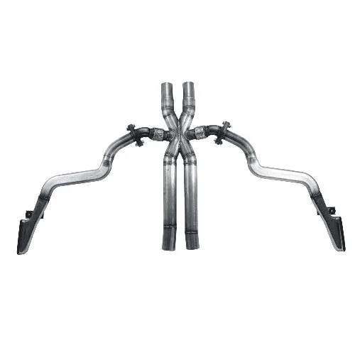

That's definitely not true. There's one model of the system, and it just replaces the mid pipe with an X, plus the added side exit exhaust. Perhaps you're thinking I'm referring to the rear exit exhaust.
https://performanceparts.ford.com/part/M-5220-M8
Look at my post history for pics and video if you want.
