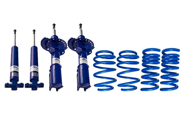

    Here is another option, our Steeda Dual Rate springs and Pro-action adjustable shocks & struts very popular among the HPDE enthusiast!
    Furthermore, the ride quality is excellent for a on track set up!
    Also, comes with a lifetime warranty
