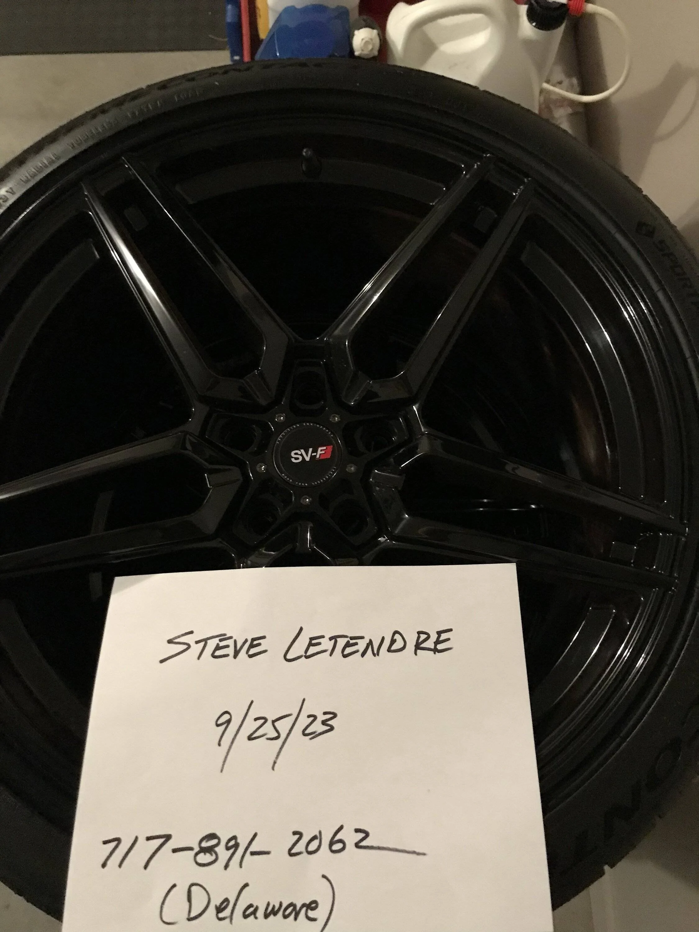

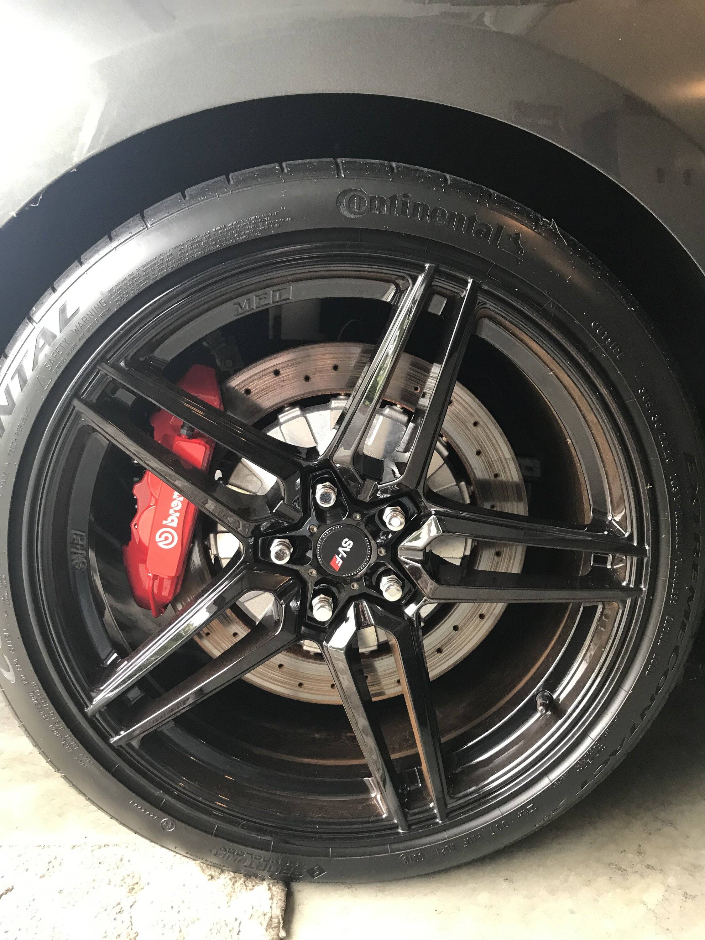

Here’s a thought: I just sold my gr350r and I kept the custom Savini (5 Double spoke) wheels and almost new Continental Extreme Contact tires mounted and balanced! I bought them for all season driving, then sold the car after 300 miles. The wheels are 20” x 10” front and 20” x 11” rear. They look new…and they practically are! I bought 20” wheels so cleaning around the brakes would be easier, it gave me a little more ride height so no scraping, and the Extreme Contact tires are excellent! Tires are 285/30zr20 front and 305/30zr20 rear with just 300 miles on them! I’m selling them all for $2800 OBO + shipping and in throwing in my hub centric 15mm spacers for the front end. But unless you have the “R” you won’t need them. 717-891-2062. Steve
