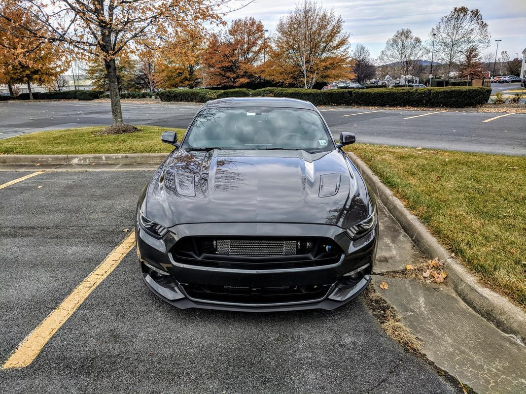

Some of my favorite pics of the car..
View attachment 238284 View attachment 306354 View attachment 335169 View attachment 350792 View attachment 350793 View attachment 238277

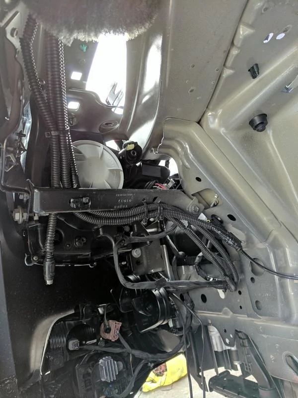

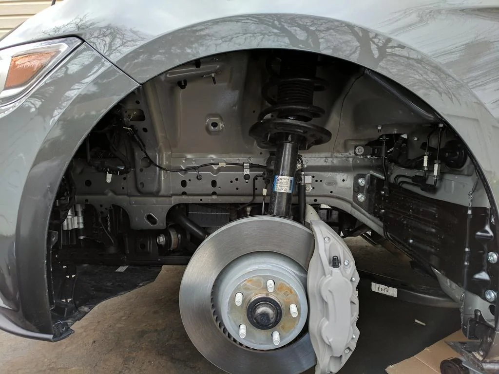

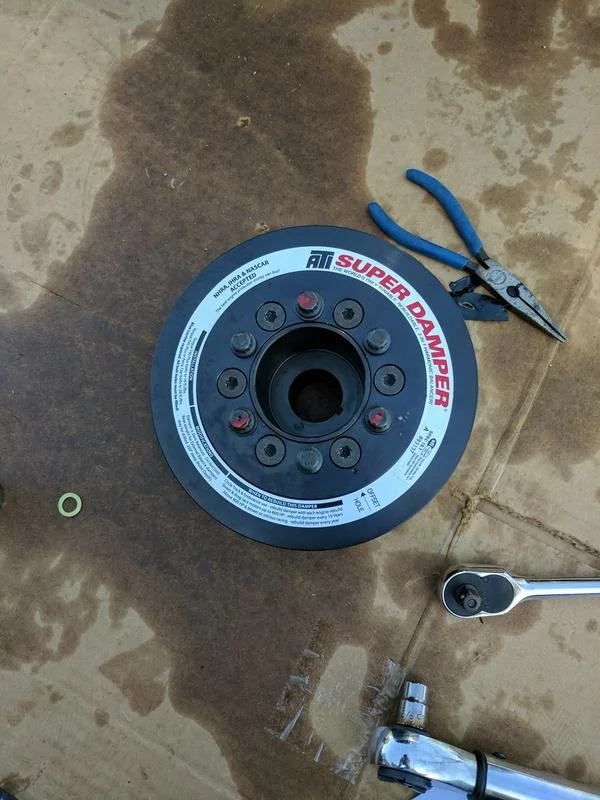

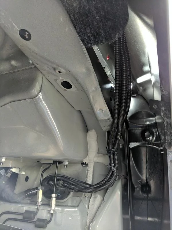

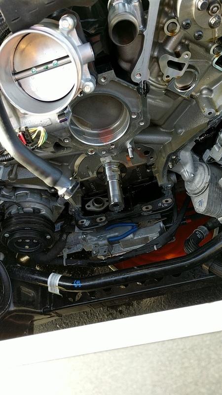

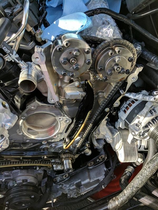

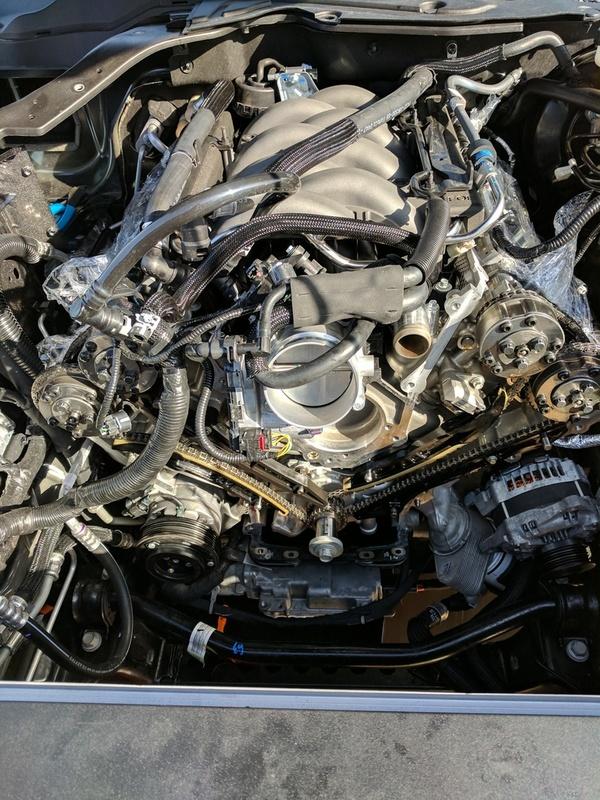

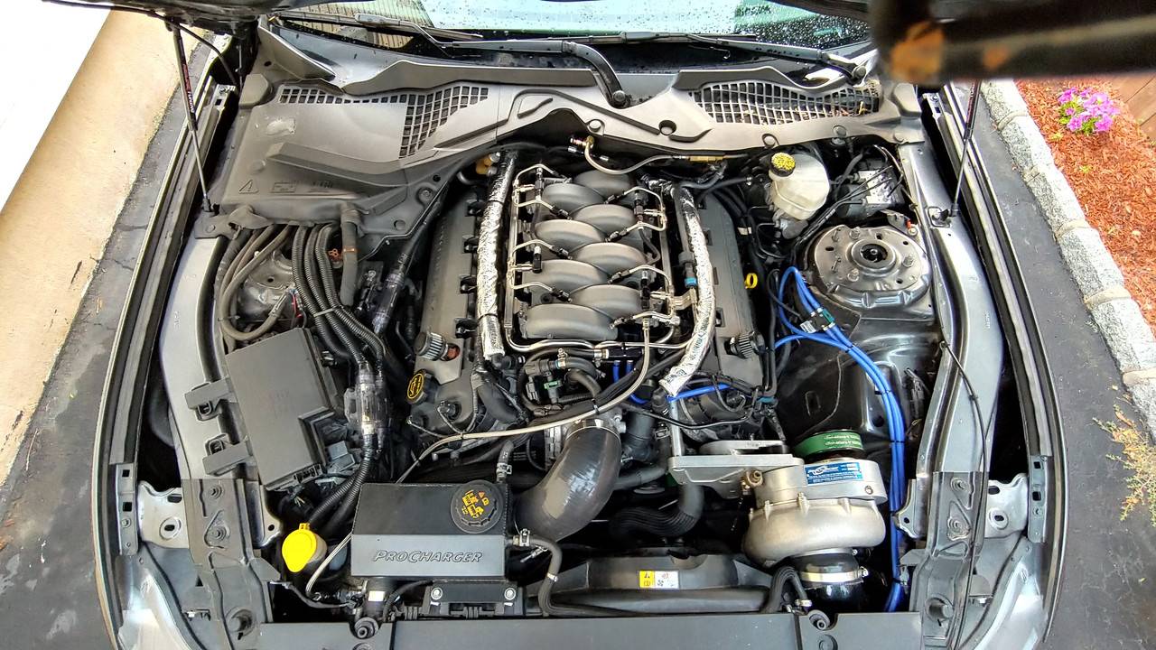

A few photos from the OPG/CG and ATI install last week.
Cables and wiring ran for 9500ci and ALP

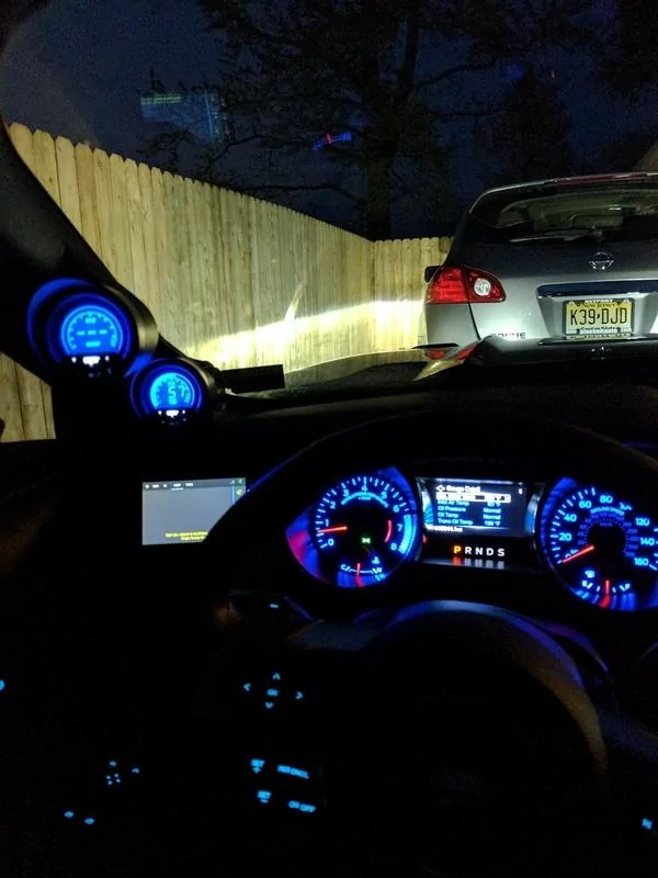

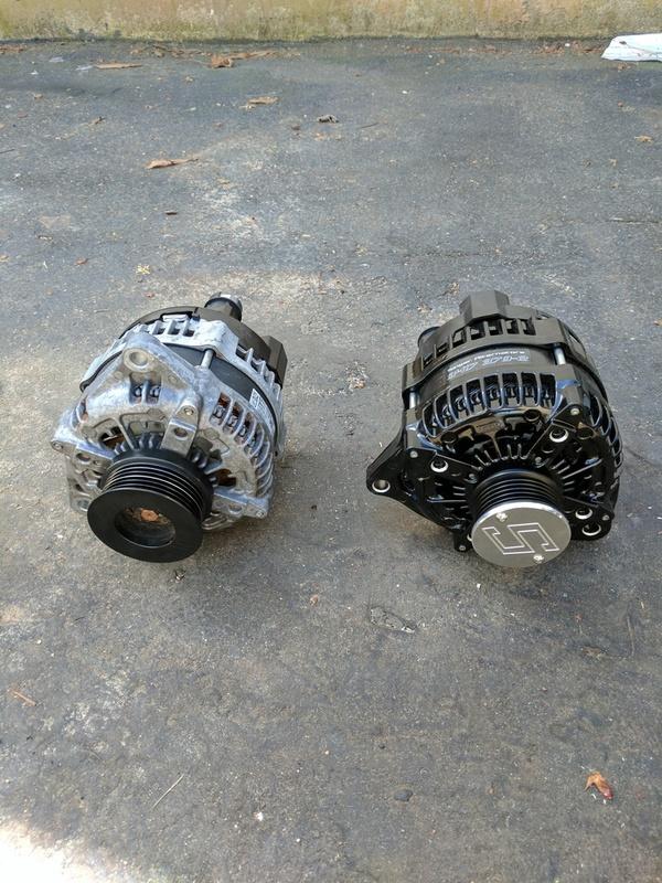

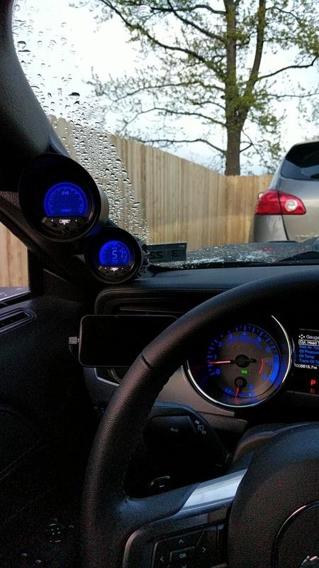

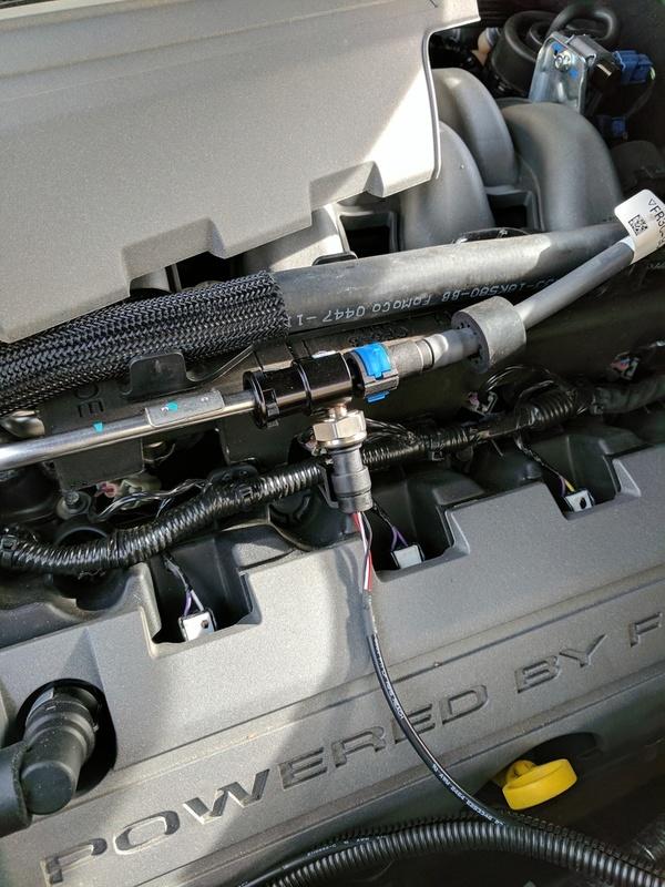

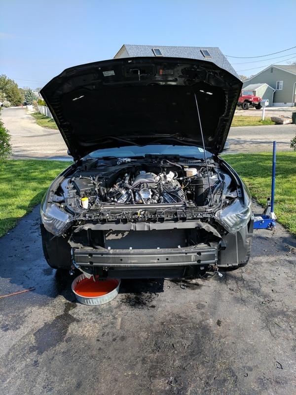

Got alot done today. I removed my sound tube, installed my Boost and fuel pressure A-pillar gauges, changed my differential oil, and installed my Singer 370A alternator.

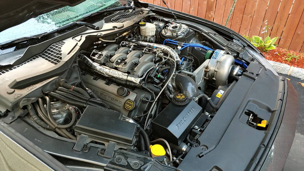

Supercharger installed! Updates to come tomorrow... :headbang:

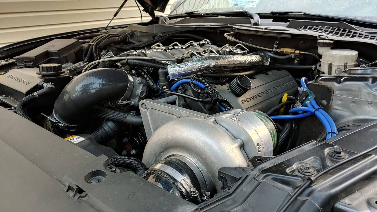

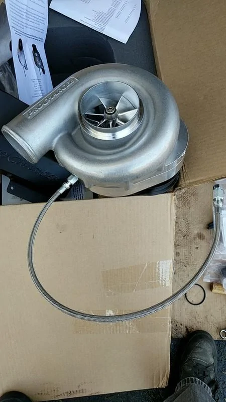

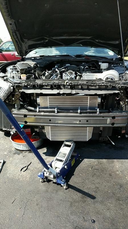

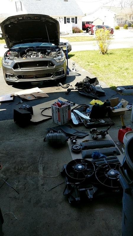

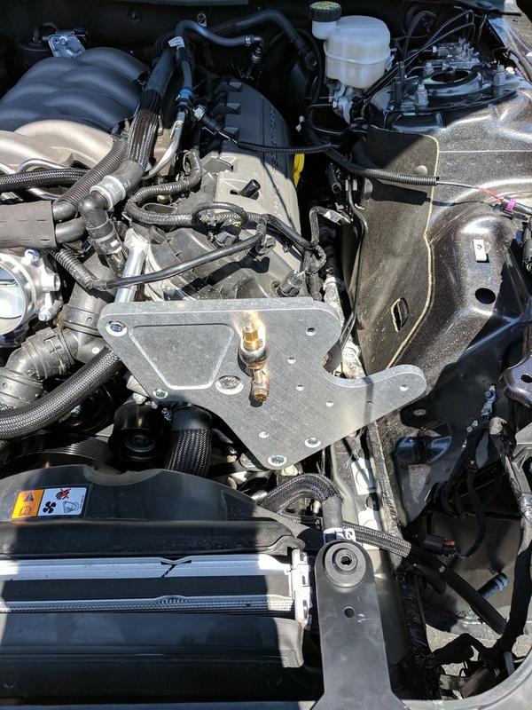

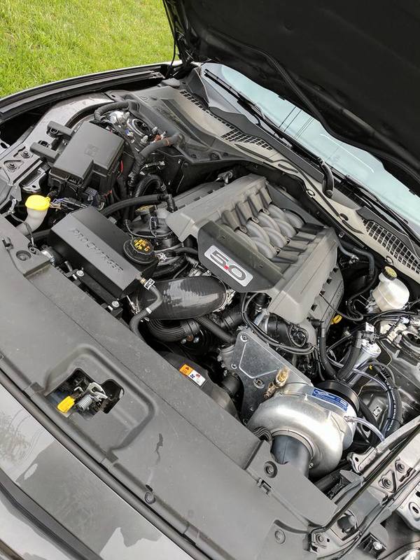

Installed my Procharger P1X last weekend! No final pics yet but these were some I snapped during install.
Tune through Lund is done, Dakota at Lund was great. Car pulls ridiculously hard and spins tires shifting into 3rd. I am eventually going to be looking into adding a wastegate however to get into boost faster. But for now, this thing is fine. It's a god damn rocket.
Should be hitting the dyno in a week or two. Goal is 650whp.

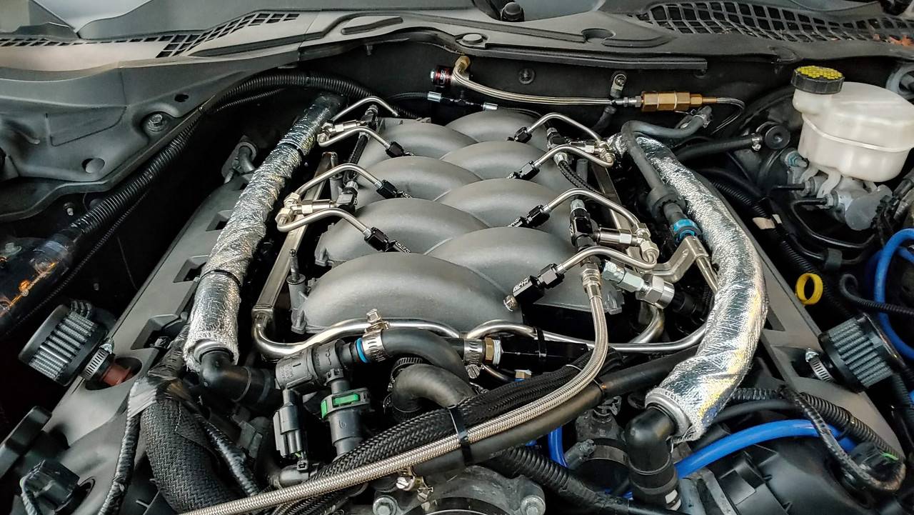

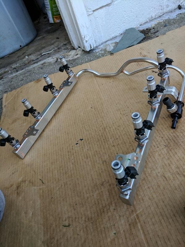

Question for you, I see on the photo of the new ID injectors you re-used the OEM injector mounting clips?
I recently did my Procharger install which came with the DW 1000 injectors, and you do not reuse the stock injector clips. If you do that, it stops the injector from fully seating into the fuel rail.
I'd check with @beefcake , but I think its the same with the ID injectors, you don't re-use the OEM fuel injector clips. Hopefully Terry can chime in to be sure I'm giving you the correct advice.
I may not be correct, but wanted to mention it just incase. Loving your build!
I did take a few minutes to look at them when I installed them, they didn't come with new clips so I believe you have to reuse the stock ones. The clips that you see on them below the factory clip holds a spacer onto the injectors (came that way). The injectors are physically the same size as the stock ones.
They felt like they installed securely, but thank you for pointing it out regardless just in case. Hopefully someone can chime in here.
Check this thread, looks like you don't re-use the stock clips as I suspected:
http://www.mustang6g.com/forums/showthread.php?t=60504&highlight=id1000+install

beefcake
Oct 18, 2014
1,145
11,078
3,600
Bethel
2015 Ford Mustang
clips really aren't needed
Thanks for the clarification. Mine fit without a problem so I'm not to worried. If im bored one day maybe I'll remove them lol. :D
