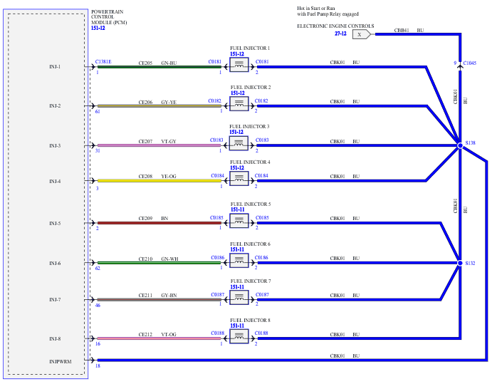

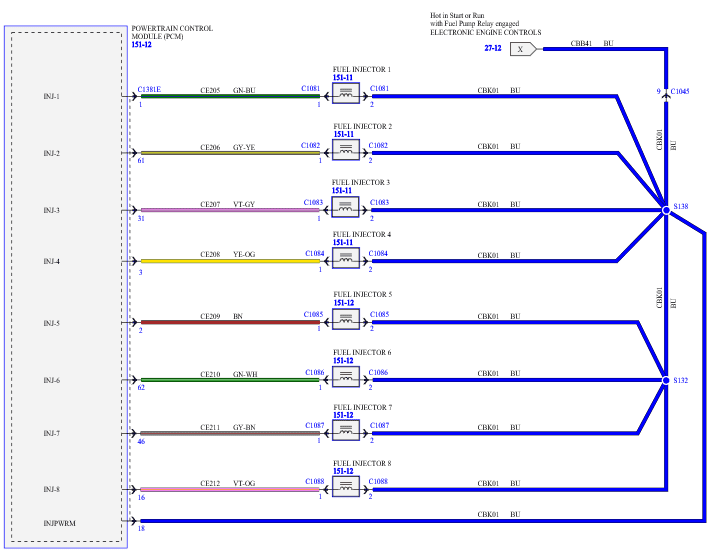

This is a perfect demonstration of why many great theories don't survive first contact with the facts. Aside from an extra wire to the ECU, the two different MY setups are substantially the same. On both, all of the injector pin 2's are hot when the car's running.
This is from an 18
@FLATPLANE - if you're getting this from the Motorcraft Service website with a subscription, could you pop up the 2019 version as well. @mmakam2's car is a 2019.
