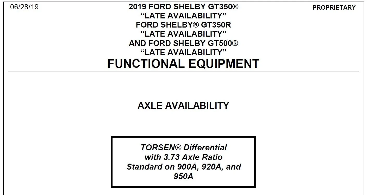

We don't. All of my calculations were ran with an assumed max rear end 3.73 gear set. Anything numerically lower would result in a higher top speed.
From the 2020 GT500 Order Guide.
TORSEN® Differential with 3.73 axle ratio in rear
