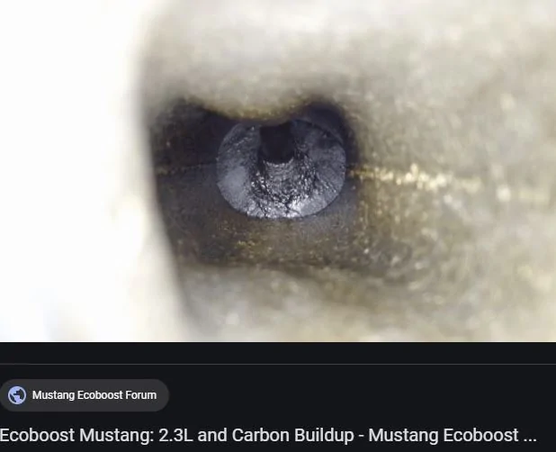

I do wish someone with a 75,000 mile un-modded 2.3 would come along and post some valve pictures. I only found a couple of pictures via Google, but they're not really verifiable.

2K Miles away from 100k and I'll be pulling the intake on video.
I'd love to know as well.
I just dont have the tools.
Maybe on my upcoming maintenance with Ford ill ask if we can take a look...see what they say.
