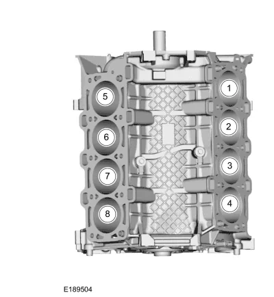

Interesting, the two that failed were what, 1 and 7 or 6 - 4. They were opposite ends.
Anyway, it is unwise to run E85 without a full return system at such big HP. That certainly could have been the cause. Everything else seems more of a stretch. Occam's razor and all that.
2 and 6 failed, they are both on the second journal of the crankshaft. 1-2-3-4 on the right (passenger) 5-6-7-8 on the left (driver)
