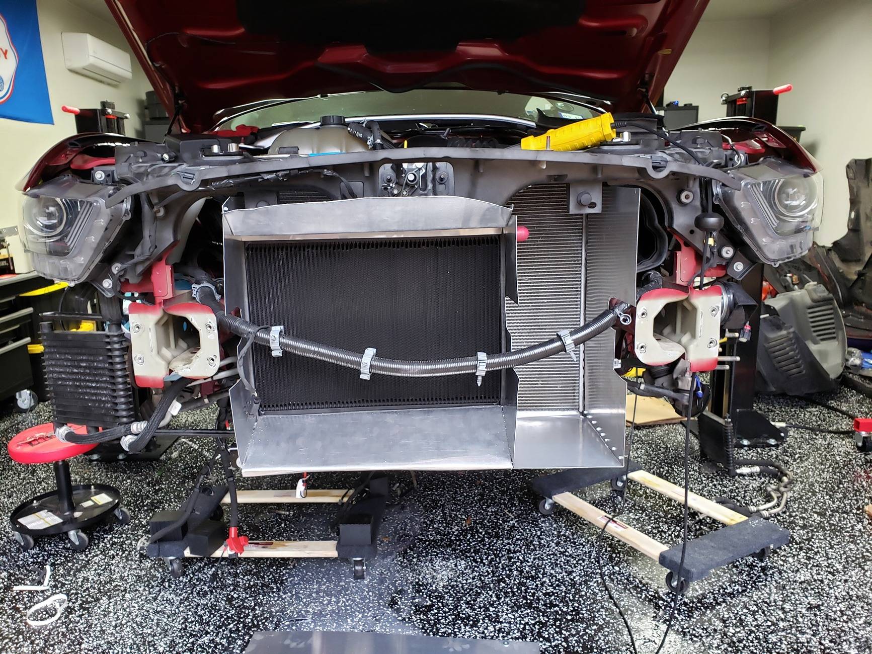

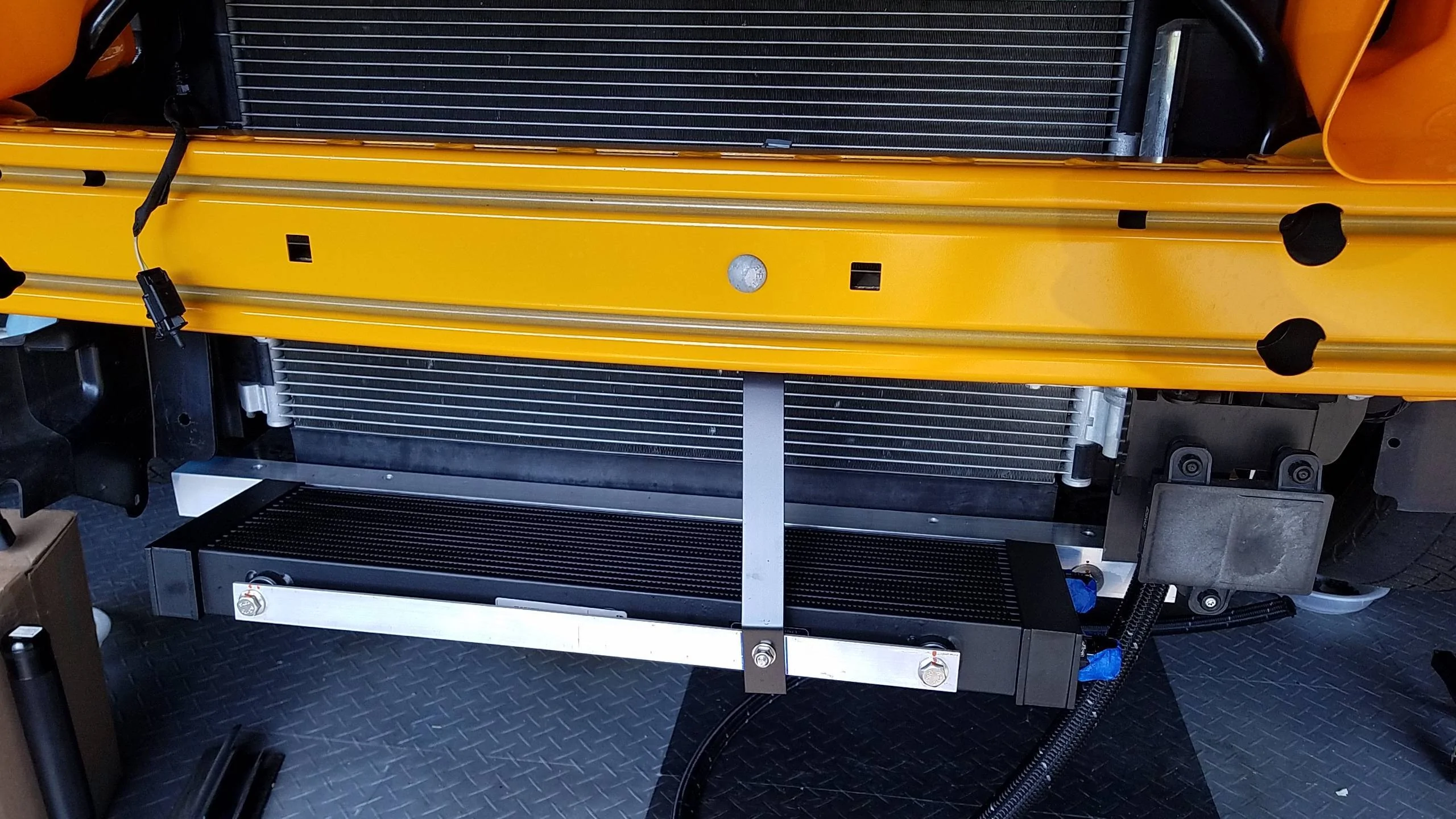

As to modifying your car, I have experience with that, too. I designed and installed oil, diff, and secondary trans coolers for my GT. It was a bit daunting at first, but my confidence grew and it became enjoyable by the time I added the third cooler.
I don't own a GT350, but based on my willingness to go "off script" for cooling, I would consider installing a larger oil cooler in the low/horizontal position. I use the Setrab Proline COM 52-12965-01 2-pass cooler, and my temps run steady as tested up to 45min session.
Then I would consider repurposing the OEM oil cooler as a second trans cooler by running a crossover line between the two.
