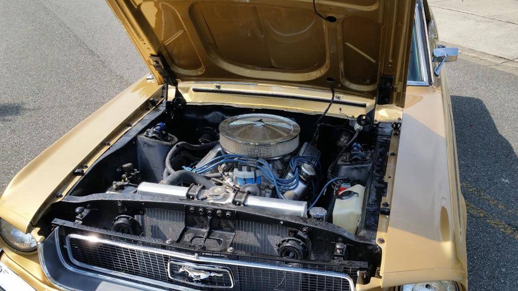

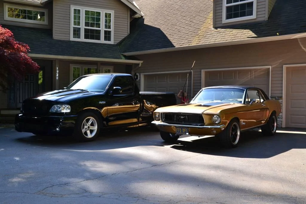

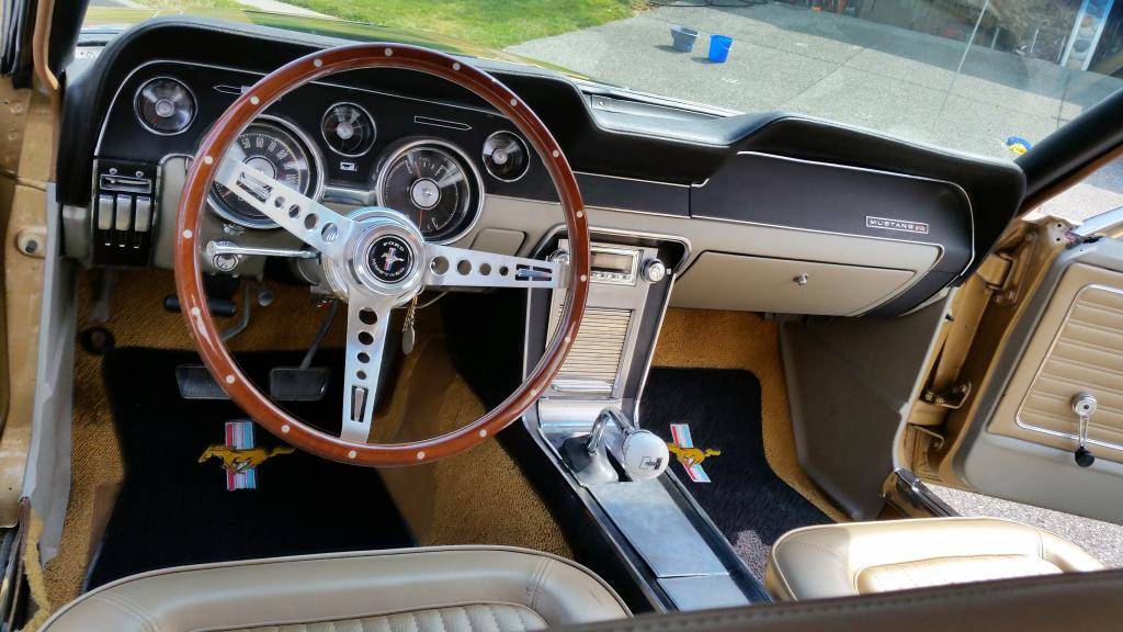

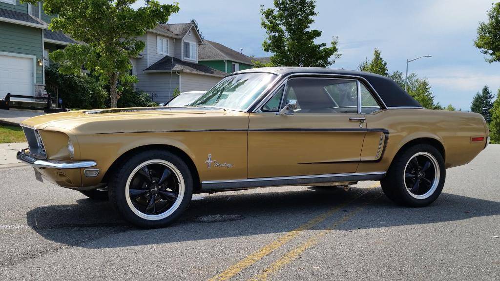

    Here's a few
    20140801_143518_zpscqhlds7t.jpg 20140801_143537_zps78ocmszx.jpg 20140801_143624_zpsch1ltykd.jpg DSC_3180_zpssqjlokcz.jpg

    0   0   0
    Very nice. I prefer the style of the fastbacks tho. Just saw one today during a bike ride, looked and sounded great.

    0   0   0
    As do i. But my grandma didn't buy a fast back lol
