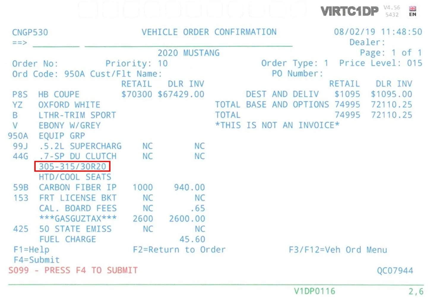

Let's hope! Hopefully the 295/305 reference in the Ford guide was a leftover from the GT350.
May have been just a mistake.
However it wouldn’t be the first thing they have changed on the base car.
If the base car has 305s in the rear I will get the handling package to get 315s.
I think all GT500 cars will have 315s in the rear though.

According to the Michelin size guide, the optimum rim width for a 315/30x20 tire is 11”:
https://www.michelinman.com/upload/michelin_us/specifications/specs-pilot-sport-4s.pdf
Line #60304 on the last page.
Thanks for the attached information and nice to see that the overall height for these tires is only 27 1/2" which certainly won't hurt any of us when it comes to a little help with acceleration.
I have used a tire/wheel guide in the past that is not Michelin specific therefore these posted numbers are to their specs and obviously more accurate and if I read the information correctly Michelin is showing that even a 10 1/2" wheel will work for this size of tire as well.

Snoopy49
Jul 24, 2019
55
4,013
6,028
California
Earl
2013 GT500 - SOLD and 2020 GT500 - SOLD
This is a VOC of a base GT500 with 1 option, CF Dash Panel.
