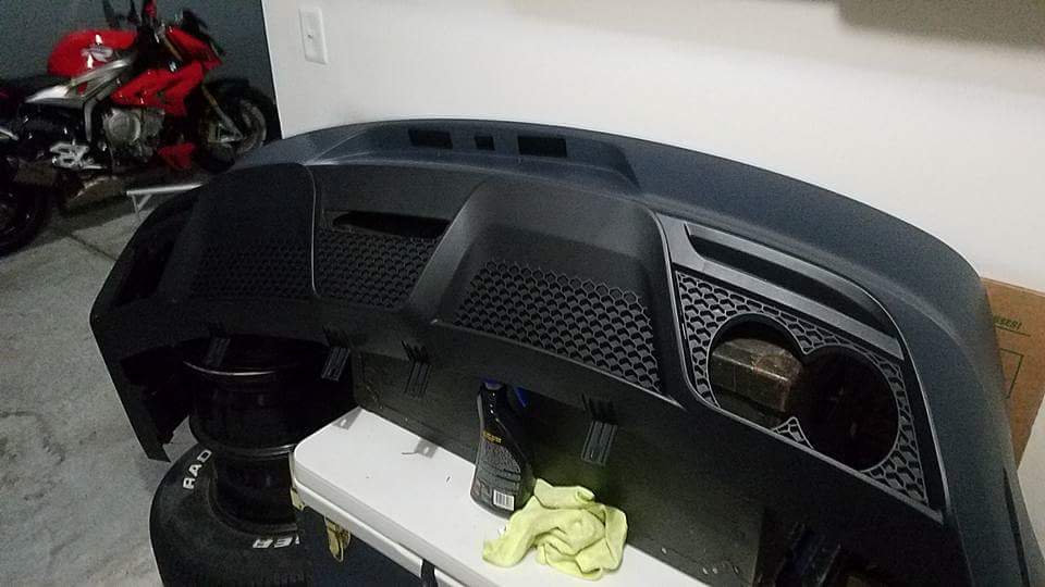

Finished the rear end, premium bumper painted, trimmed, and gt350 valance installed.
Need an exhaust shop to finish the piping, and i'm throwing on the X-pipe next weekend.

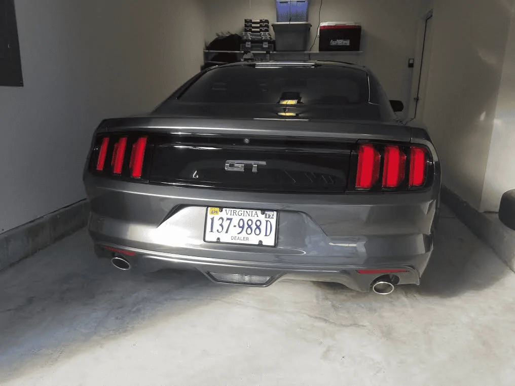

Small updates. Installed the mud flaps from the gt350 kit sold by levitown ford, and switchback turn signals. Just ordered the metra dash kit and a buttonless jvc double din with android auto. Torn between a cold air intake or springs next. I'm leaning towards springs since I plan on a supercharger soon anyways. I did some minor engine parts painting to give a little pop. A metallic red, with a hit of orange flake. The final photo is the completed back end with the exhaust trimmed and fitted. Thanks to borla for the hook up on the mufflers!

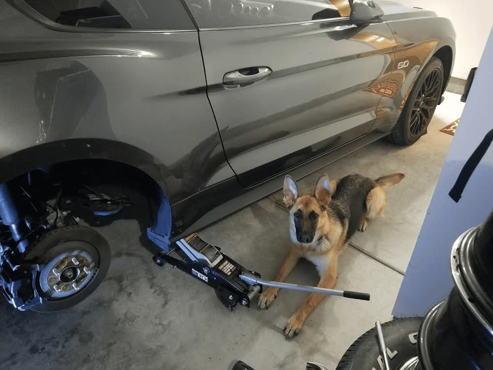

Lowered the front with the RS progressive springs and installed the BMR camber bolts. Plan on doing the back soon. Took care in aligning the springs to the old spring stops locations. No additional noise or vibrations. Car does not pull, and actually feels very stock.It did drop it from 28 or so to 27.3 from ground to fender well. I do expect over time for that to settle around 27. I will need to add some spacers up front to push the wheels out slightly. The back springs seem to be the most strait forward. Ill be dropping the exhaust and lowering the subframe hopefully next weekend weather pending.
Additionally I did the blowfish sound tube delete. I could not get off that nut on the long bolt. I tried for nearly 2 hours with all sorts of sockets, universals, etc. I could get a socket deep enough and on it, but not fit the ratchet to turn it. Ended up just ripping it out and plugging it, which was a pain with my large hands to fit around the strut tower brace and rear of the block.
