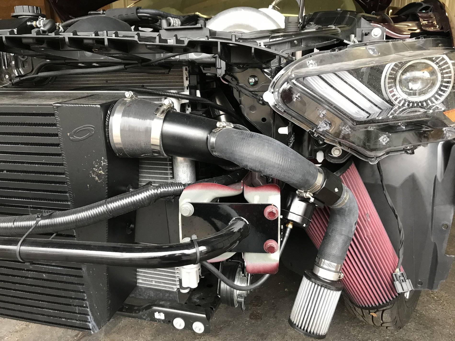

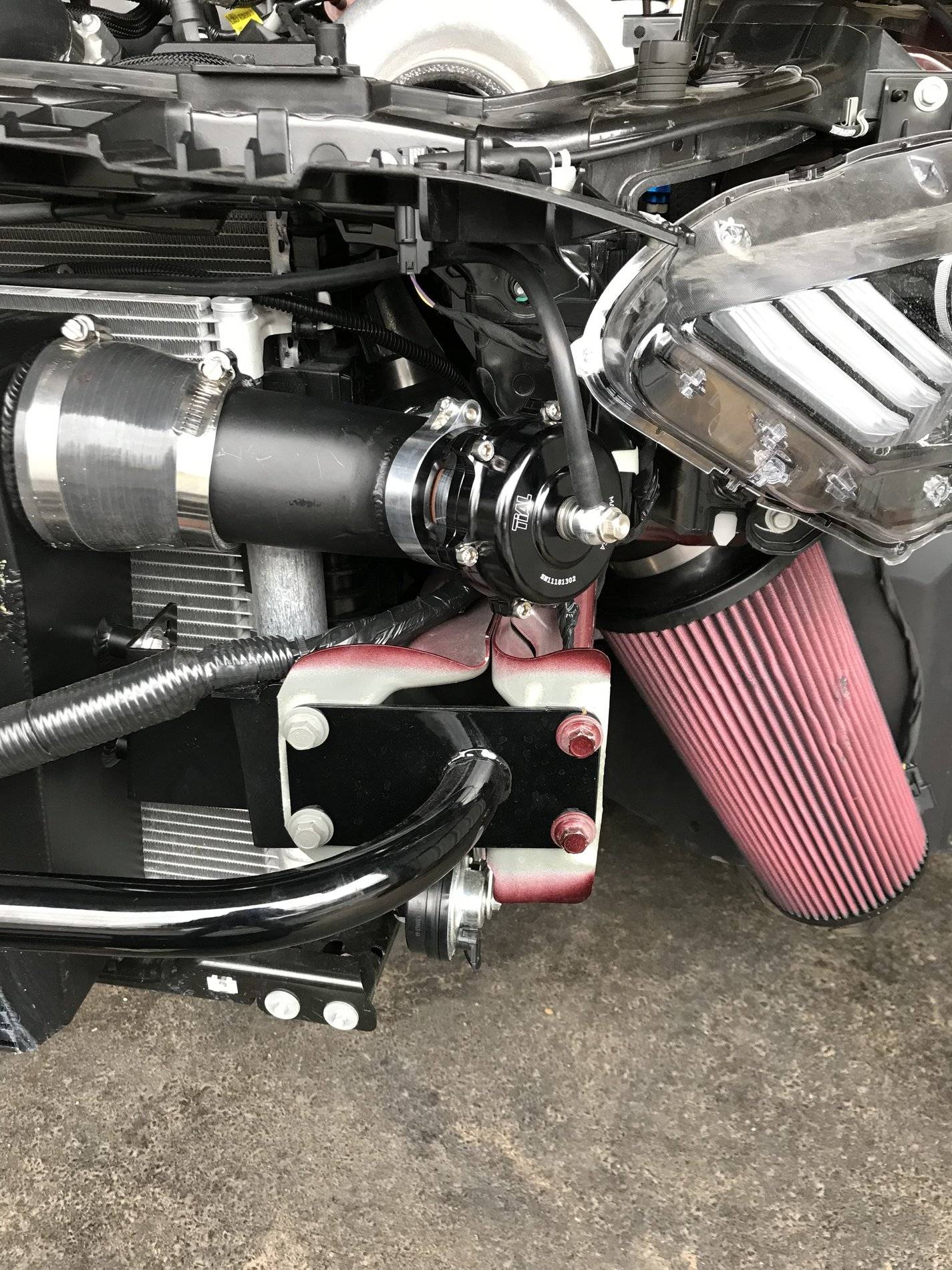

I j stalled a TiAl q50 in the exact same location as the factory bov pipe with great results. Score and after picture for comparison.
Nice.buying one right now.. what spring are you using?
About install a turbosmart in that same location. Did you need to do any trimming when reinstalling the front clip?
Non at all. It just replaced the nipple where the stock profile valve went.
