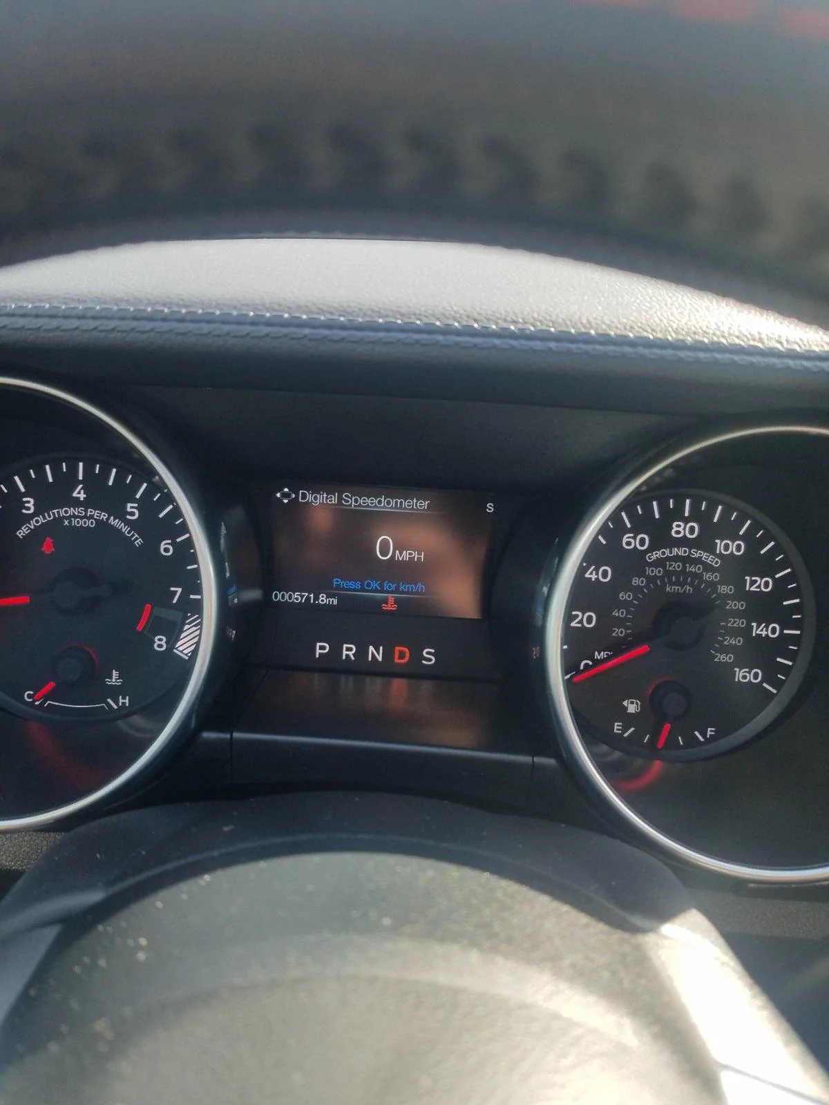

I am having a similar issue with my 2019 Mustang with just over 1,150 miles from new. Had car on cruise at 70mph, temp gauge dropped from normal temp to zero followed by an overheating warning despite block temp still reading as around 90c.
Got recovered to dealership and after 2.5hours with the engine off the issue is still present.
Dealership found multiple fault codes due to a shorted electrical wire (mounted poorly on a sharp bracket) but seems the short has caused the coolant temp sensor to fail. Intake manifold (and several other key components) need to come off now for them to access the faulty sensor and assess if pcm is also faulty.

Thanks for the info! Seems it’s not so much a bad batch of sensors but poorly mounted wiring loom. This causes a short on the sensor circuit and then blows the sensor (and potentially can damage the pcm too. Still waiting to find out on that one).
