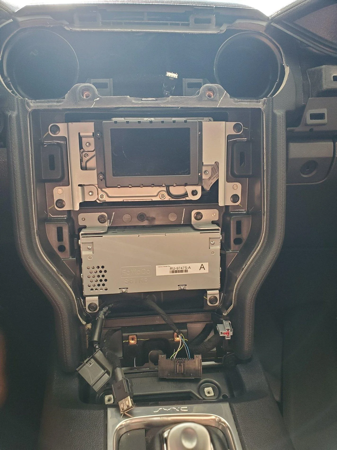

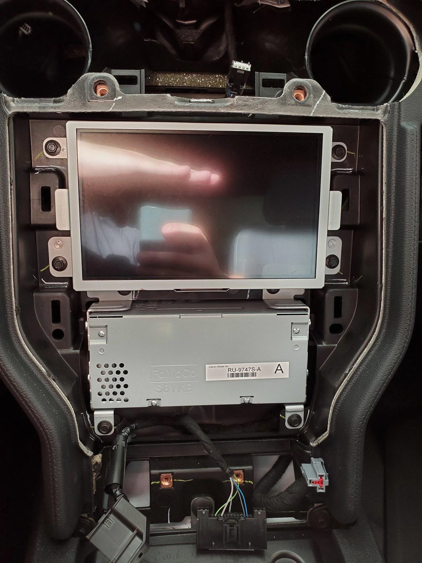

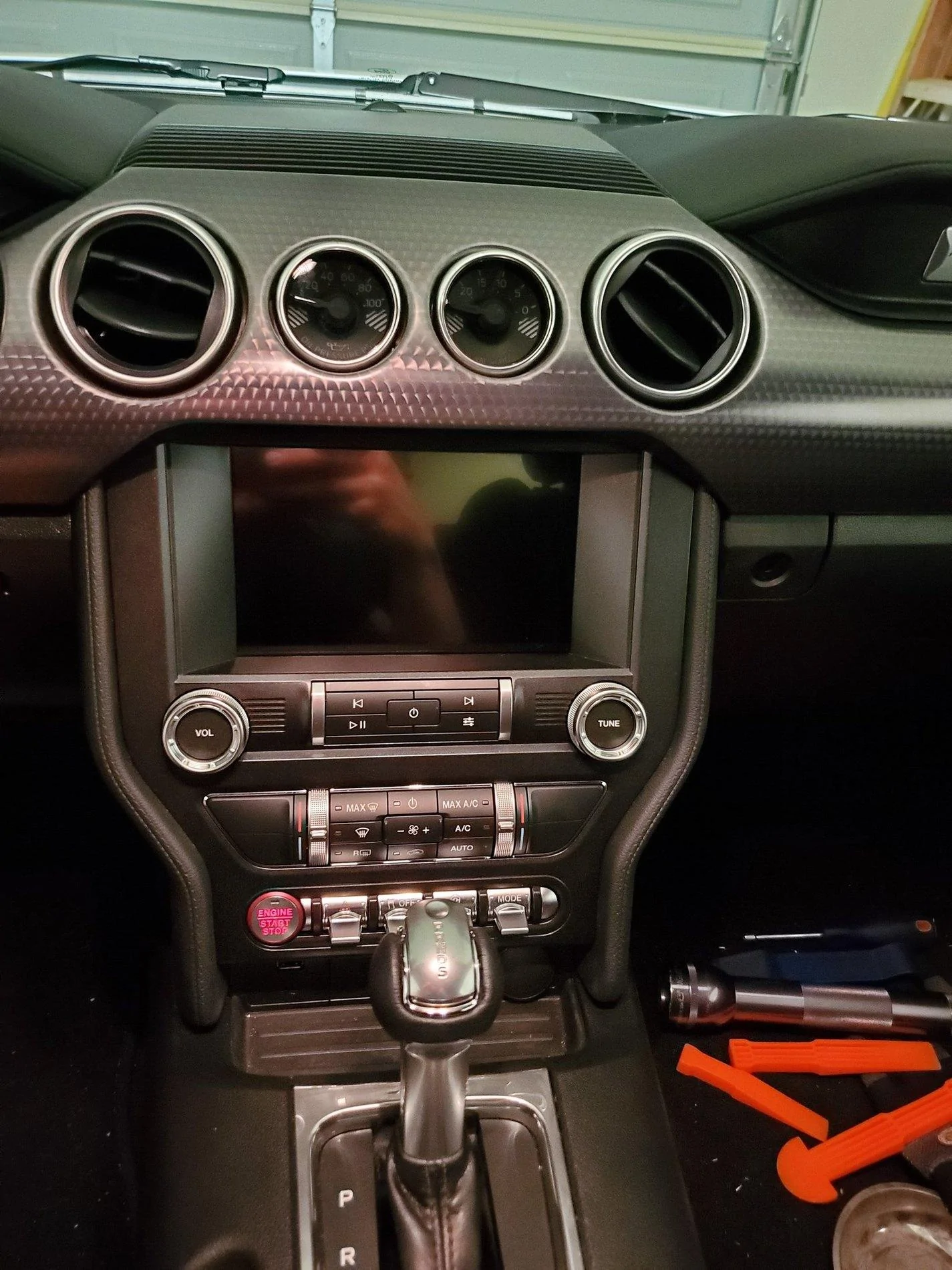

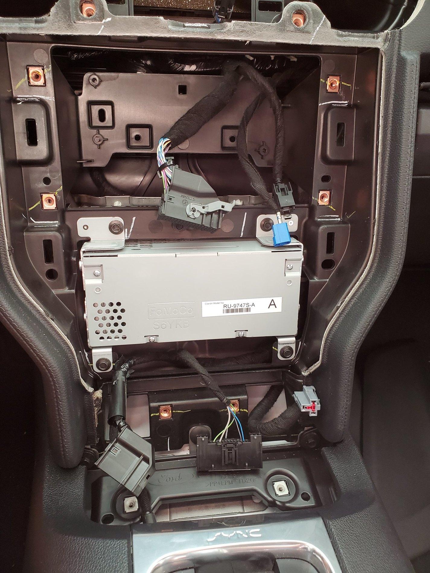

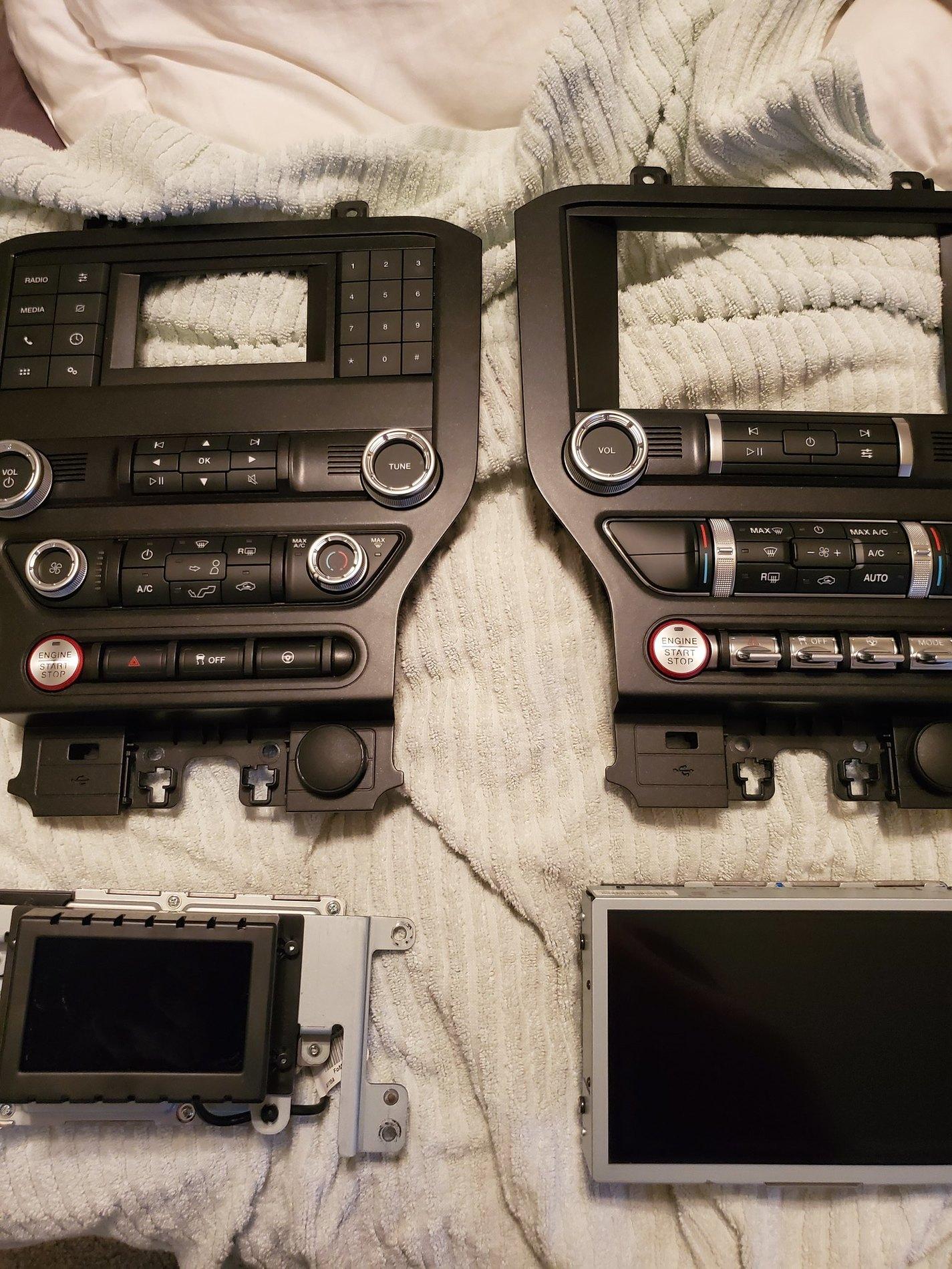

It did take Ford awhile for my bezel as it was on back order, but I received my kit last week and installed it myself in about 30 min (very easy!).
I then do a remote session with Hextall and wham! I have Sync 3.3 and all the drive modes!
