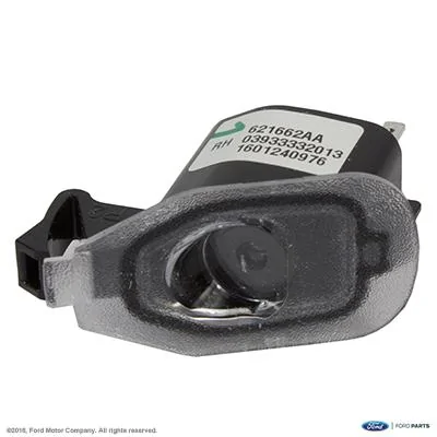

What are the part numbers to replace entire mirror housing left and right with cobra lamps ? I have a 16 GT350 . Do they fit the same ? Thanks , Wendy

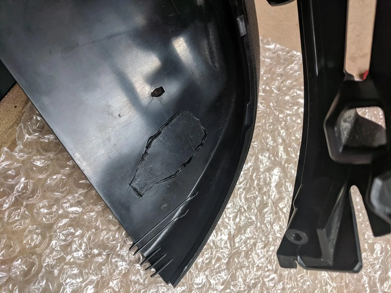

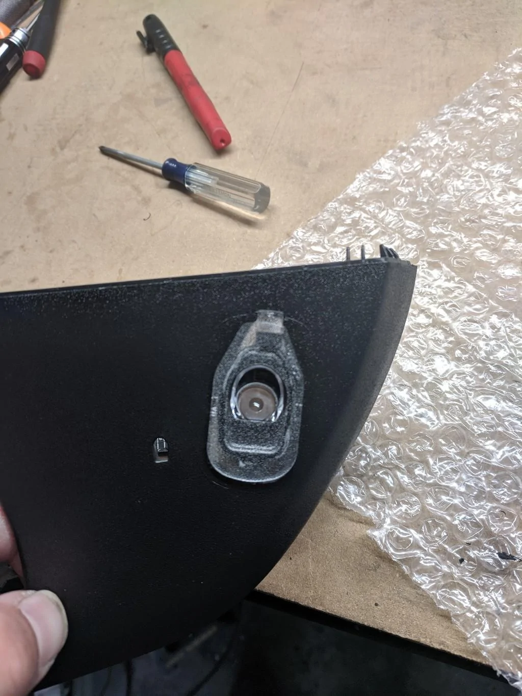

You have to cut out the existing plastic on the bottom to install the light.

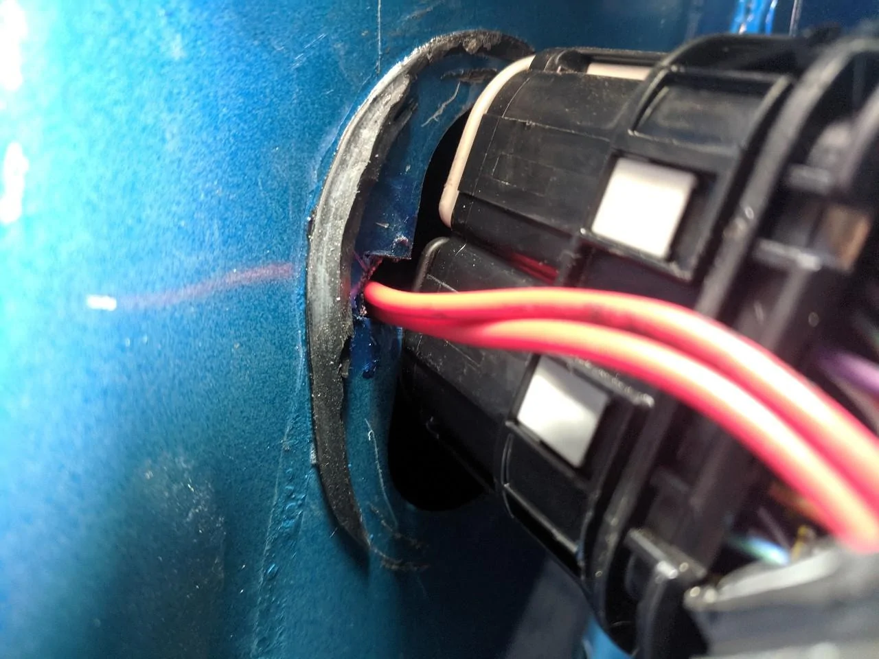

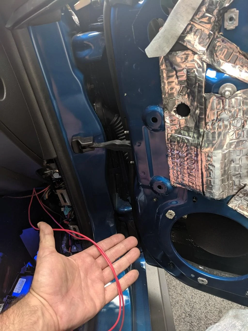

No harness at all so you have to run the wiring.
In order to get the wiring through the body you have to notch the body so the wires can fit through the hole as you can see in the first pictures.
It is lots of work.
Can the piece in your last two pics (the bottom piece that has to be cut) be ordered separately? Mine does not have any makings on it (at least not on the outside) to use as a template.
Also, do you have a write up, or is there a video on how to disassemble the mirror to do the cutting? The front cover was pretty easy to get off. Beyond that, I didn’t want to risk busting stuff.
My mirrors had markings and when I traced them they were way off. I ordered a new set of mirrors off eBay for 200 bucks. The reason they’re so cheap is because the advisement on the mirror is in Arabic. I’ll use my old mirrors so it’s no big deal. The mirrors I ordered come with the pony lights so it’ll be a quick swap. Unfortunately, you can’t order just the piece that has the cut out. You’ll have to order the complete mirror assembly.

Those mirrors are straight oem 2019 mirrors. They are $350 for a complete mirror with everything including the cobra lamps. I pretty sure the wiring harness is plug and play as it has a plug built in the harness to power the puddles.
I tried looking up the mirrors with the cobra puddle lamp but a few come up on Ford. Does anyone know the part number to the mirrors with the built in cobra lamp?

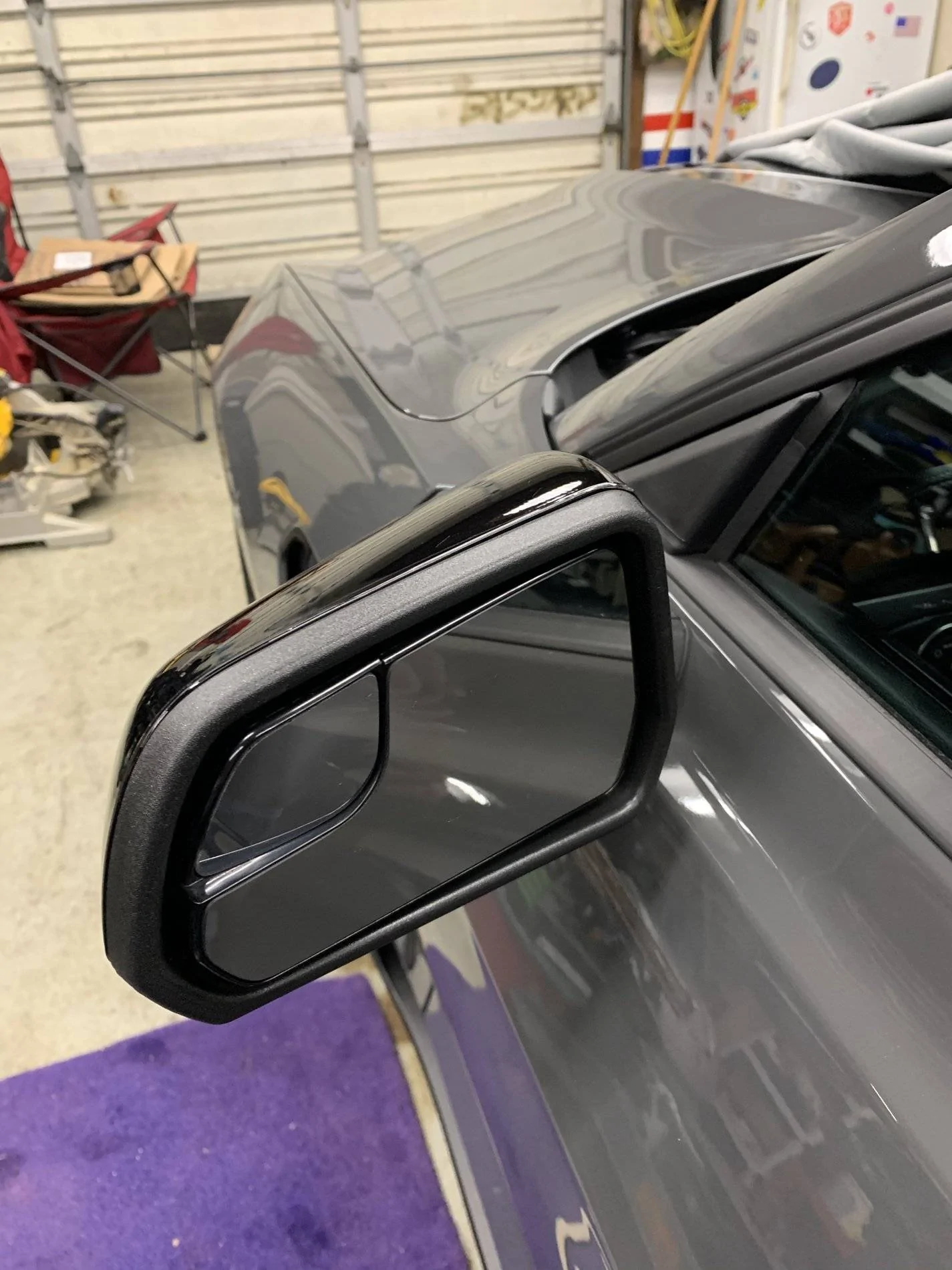

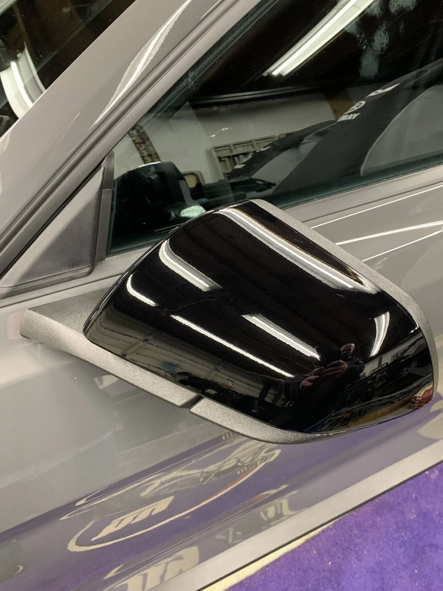

So I can 100% confirm that a 2019 GT350 mirror is plug and play to a 2018 GT350 . I got a really great deal on a pair of 19 mirrors off a wrecked gt350r the options on the mirror where blind spot , defrost and puddle lamps. I removed my 18 mirrors and also removed my caps and glass the 19 mirror needed caps. I than removed the 19 glass and unhooked the blind spot and defrost. Installed my glass and cap and put everything back together and it all works perfect.

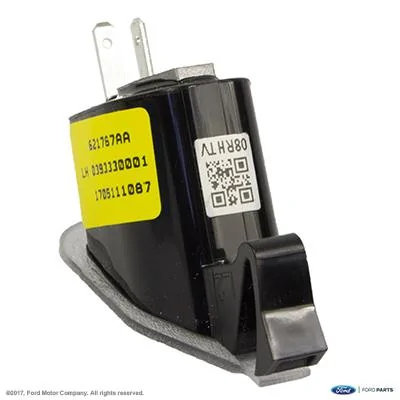

can you please provide the part numbers for right and left - will the cobra lights fit on a 2016 GT350 / GT350R ?? I appreciate your assistance
