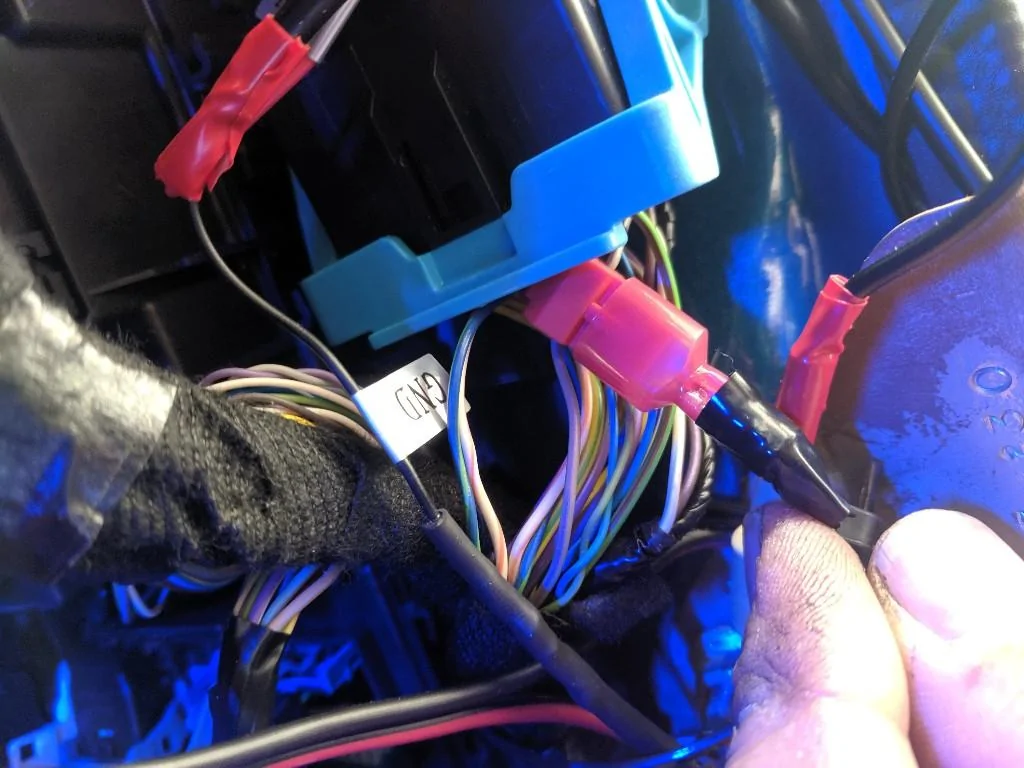

I am also running 2 footwell led bars on the same terminal.
I will probably change it out to 2.5 amps just to be on the safe side. If it blow than I will gradually up the amps.

You have to be very careful and percise when the cutting the housing . Make sure you follow the inner outline lines on the mirror housing so you will have a nice fit. If it is too small gradually make it bigger.
Also, when running the wires in the door, make sure to run it on the existing wiring harness and zip tie it really good and away from the window rail. It is very tight and not really much space to get the zip tie around but it is doable.

I used a fuel line hose from my rc nitro engine to shield the wires going through the opening where I notched it.
