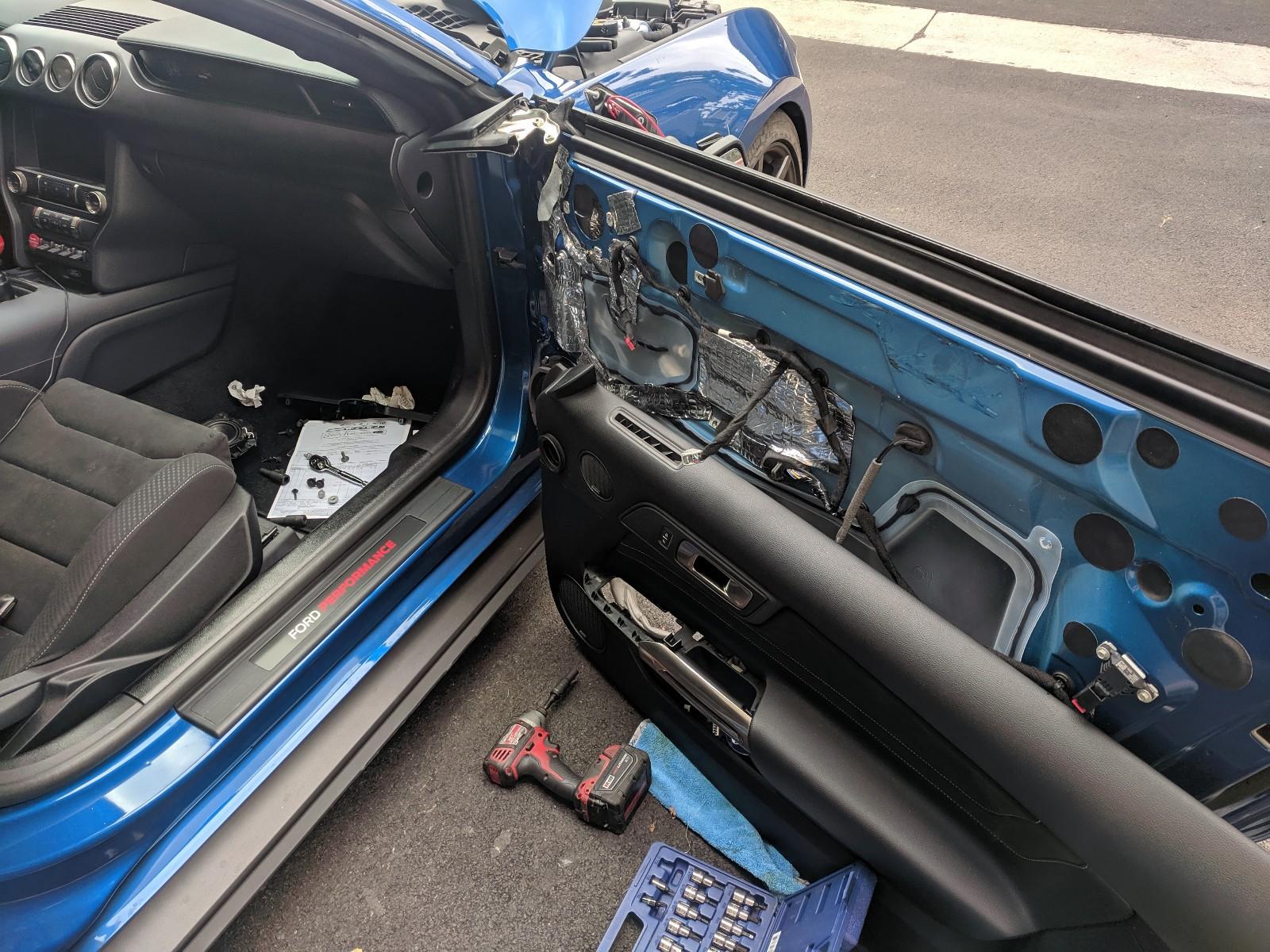

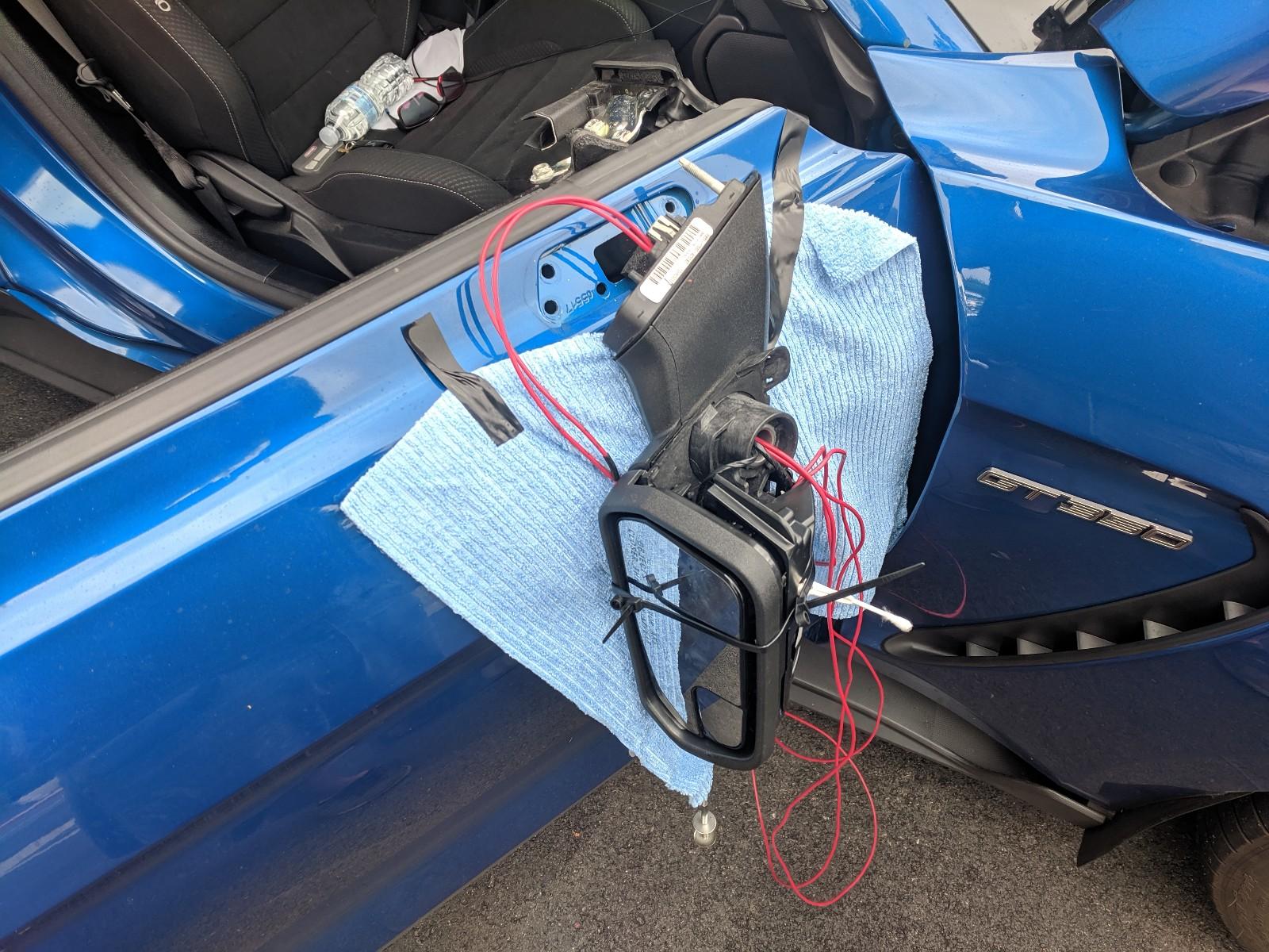

You have to cut out the existing plastic on the bottom to install the light.
No harness at all so you have to run the wiring.
In order to get the wiring through the body you have to notch the body so the wires can fit through the hole as you can see in the first pictures.
It is lots of work.

Grey wire with purple strip for positive connection and ground it on the bolt. I also ran a inline fuse.

If I'm understanding correctly, it's not plug and play to install the puddle lamps on a 2016 GT. You would have to update the entire mirror assembly to a 2019 MY?
Not only that you also have to run wires.
Or you can do what I did.

Nice job.

Damn that is so awesome! But tons of work. I hope there is a better/easier way.
