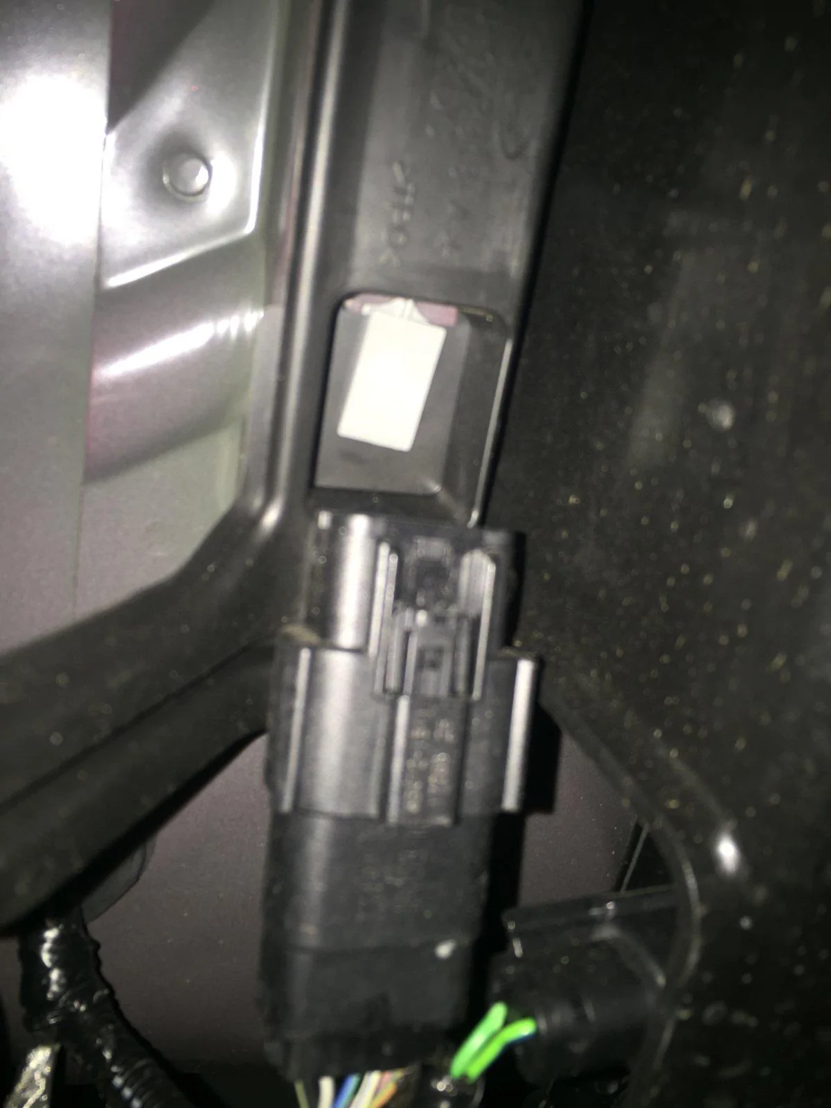

Here’s the picture of the wiring harness in the back of the car by the exhaust left side.

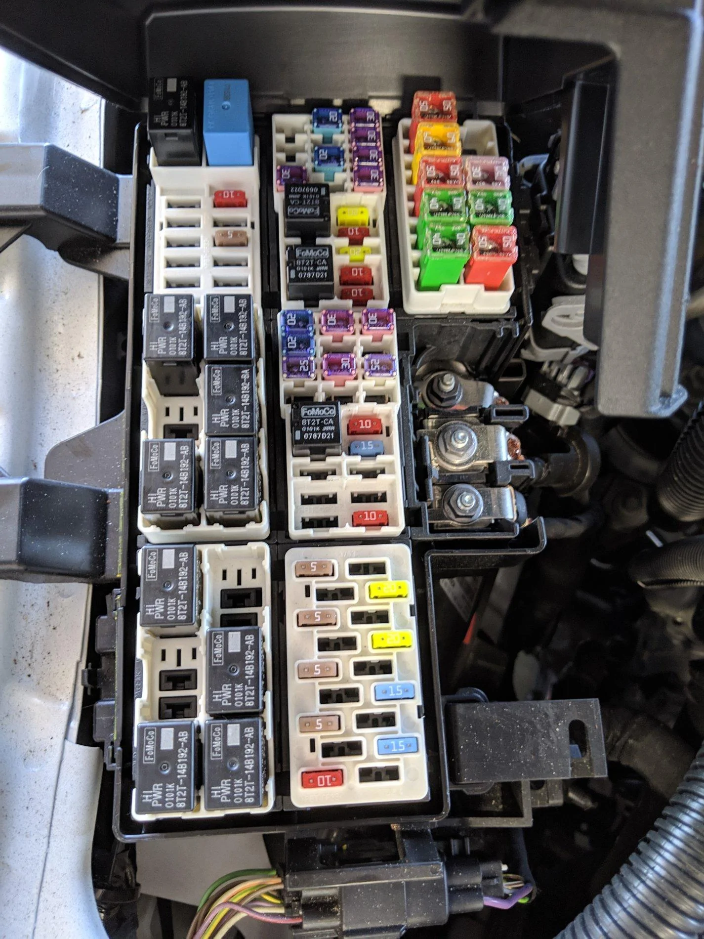

So the one circled is relay 59 (active exhaust). See how it’s turned 180 degrees? Are you saying that I need to turn it 180 degrees and reinsert? All of the others are going the same way...
So the 2019 Mustang Ecoboost active exhaust and valance swaps directly on to the 2018 Mustang Ecoboost. Only thing left is to get the OBD-II module and Forscan to see if I can activate it via the digital dash.
So the only thing needed to do the swap is the exhaust itself and the valance. Literally nothing else.

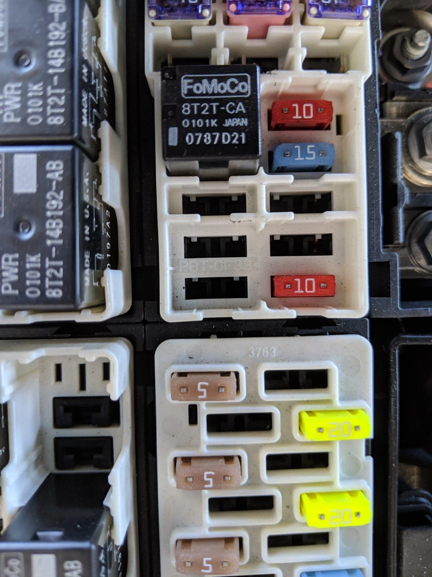

Some guys in the GT AE retrofit threat are talking about a relay 59. Mine doesn’t have it installed, so I guess I won’t be able to do the retrofit.
Can you verify if you have it installed? Thanks
I'll verify. I ordered the obd module. Just waiting for it to arrive.

Hit a speed bump... The fuse is not there on the 2018. It's a blank area and there's no metal contacts for the fuse either. Essentially, putting the fuse there does nothing.
