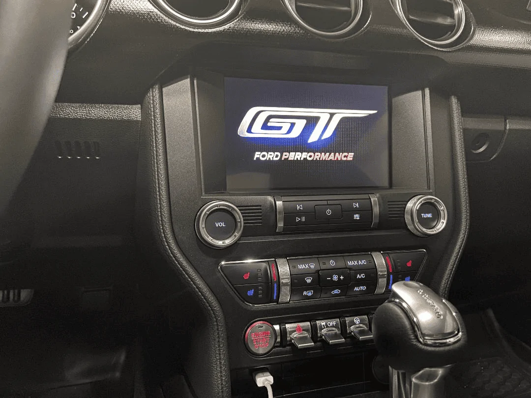

My Sync 3 APIM, Bezel, and Screen, all from 2019 came in yesterday. I installed it into my 2021 GT with no issues. Everything was plug-and-play, and it worked right away. Did not run into any Ford Pass issues, as I already had it linked to my car prior to the installation. I don't know if this is what happens to other people, but my Sync automatically recognized my car's VIN, now it has my car's vin in its setting. I changed around 3 lines of codes and my hazard lights and drive modes work perfectly. Thank you all for the great information on this thread.

Your issue was the same one I had. For me, I went to line 726-41-01 (bdycm as built) and changed the second digit from 1 to 0, which got my hazard lights working fine.

Enabling Drive Mode Selector Toggle with FORScan:
Connect your OBDII Coding Tool to your car and computer. Switch your tool to the HS-CAN feature. Turn your ignition on, but do not start the car.
*I purchased This OBDII Module and it was compatible with windows 10 and my car. No drivers were needed.
Open FORScan and follow the prompts. It will ask you to switch it from HS-CAN to MS-CAN to read the modules in the second position. Do this and press OK.
Click the "Computer Processor" image and select ABS (As Built). Press the blue Play button and let the module load. Find line "760-02-02" and change the following numbers:
xxxx-3xxx (ONLY change the fifth number. Leave the numbers in the X slots be)
If you own a performance package car, change it to xxx-7xxx instead.
Hit WRITE.
Select the STOP button at the bottom of FORScan.
Now select "IPC" on the same list as before under the computer processor. Find lines: "720-06-01" if you have an automatic. Change the code to 6C7F-8000-18B1. If you have a manual, change the code to 786F-0664-1897.
Hit WRITE. Turn off ignition and wait a minute or two. Start the car and enjoy your new toggle switch!
Thank you so much brother, you have no idea how much this post helped me in the process!
I just changed my old 4" screen for a 8" with CD and I had no problems at all! Like you, it was plug and play for me (I own a 2019 s550) just changed three lines of code to enable drive mode selector & fix the hazard lights. Really happy with the outcome!!
