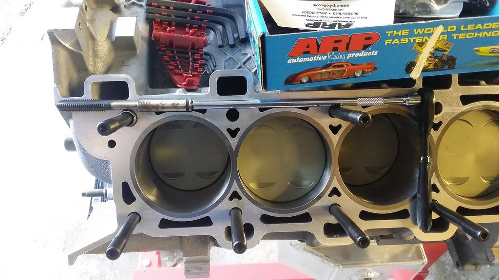

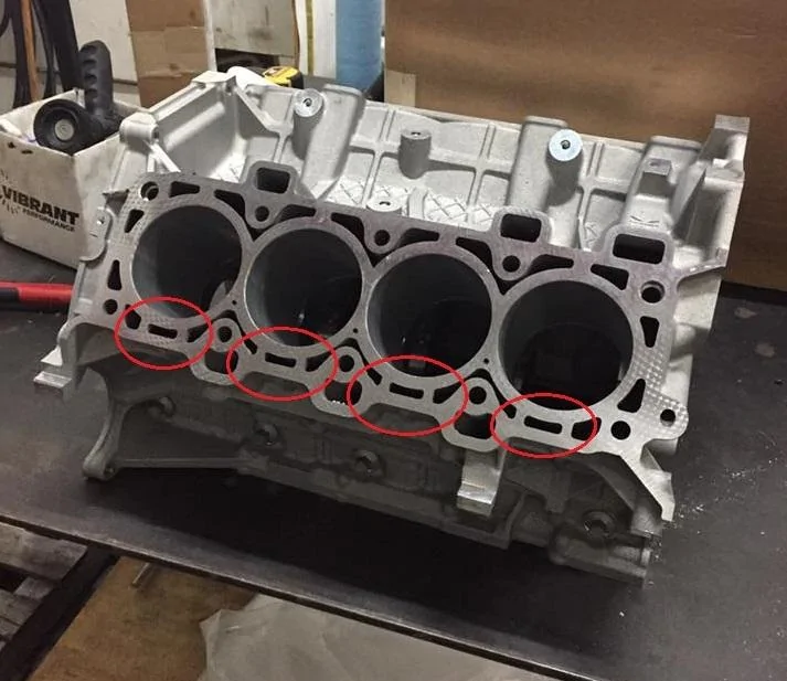

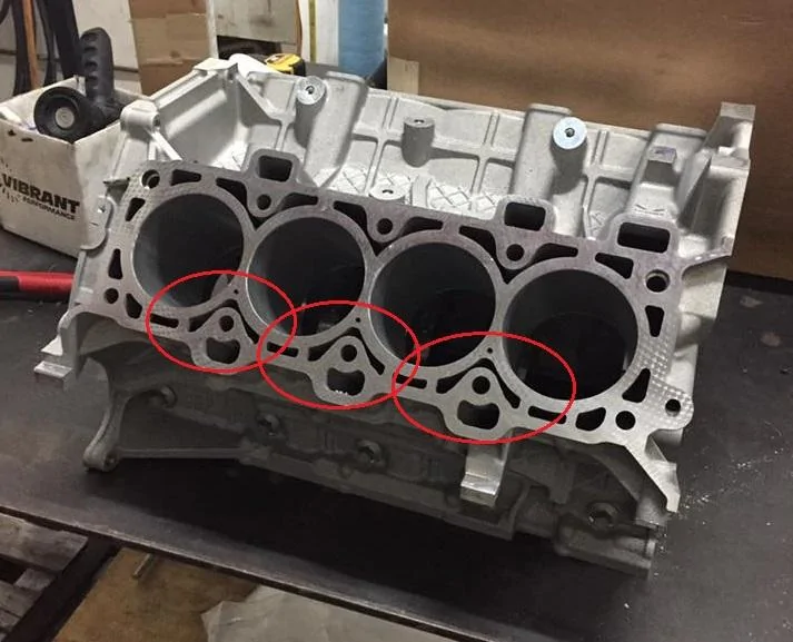

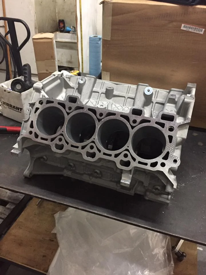

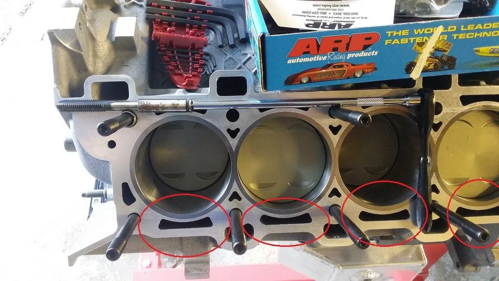

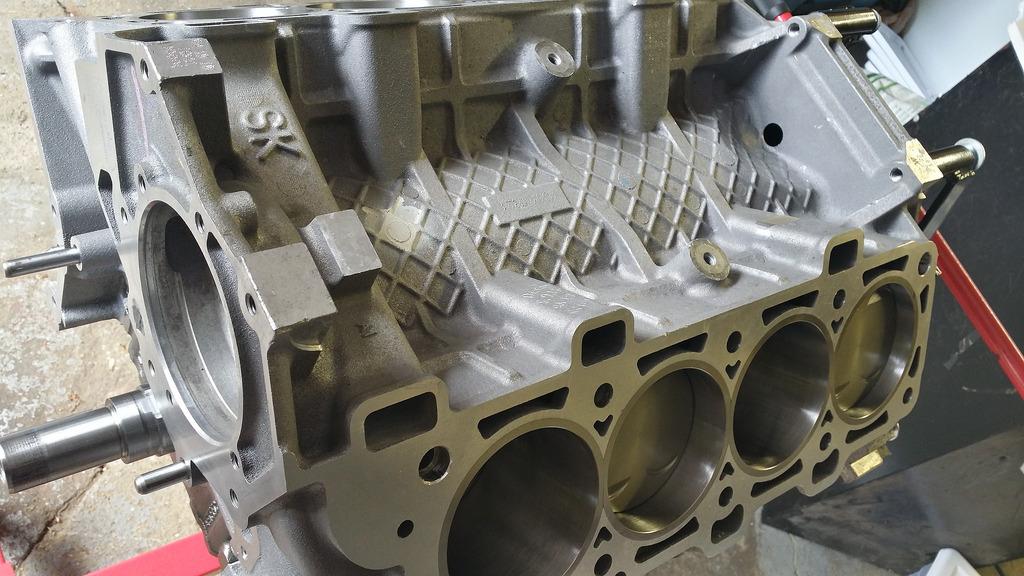

It looks like Tim over at MPR got his hands on a 2018 block. The engine looks like it received a pretty drastic update from Ford. For reference, this is my sleeved 2011 block. It looks like they put some added material along the top of the cylinder bore to try and prevent the bores from cracking when approaching the boost necessary for achieving 1000HP as well as completely revising the water passages of the engine. This block receives the plasma transfer wire arch spray bore that the 11-14 GT500's & GT350 received as well. Pretty interesting what Ford did just from a very limited glance at the engine. I don't remember seeing a cut away of the engine on display at any of the auto shows.
