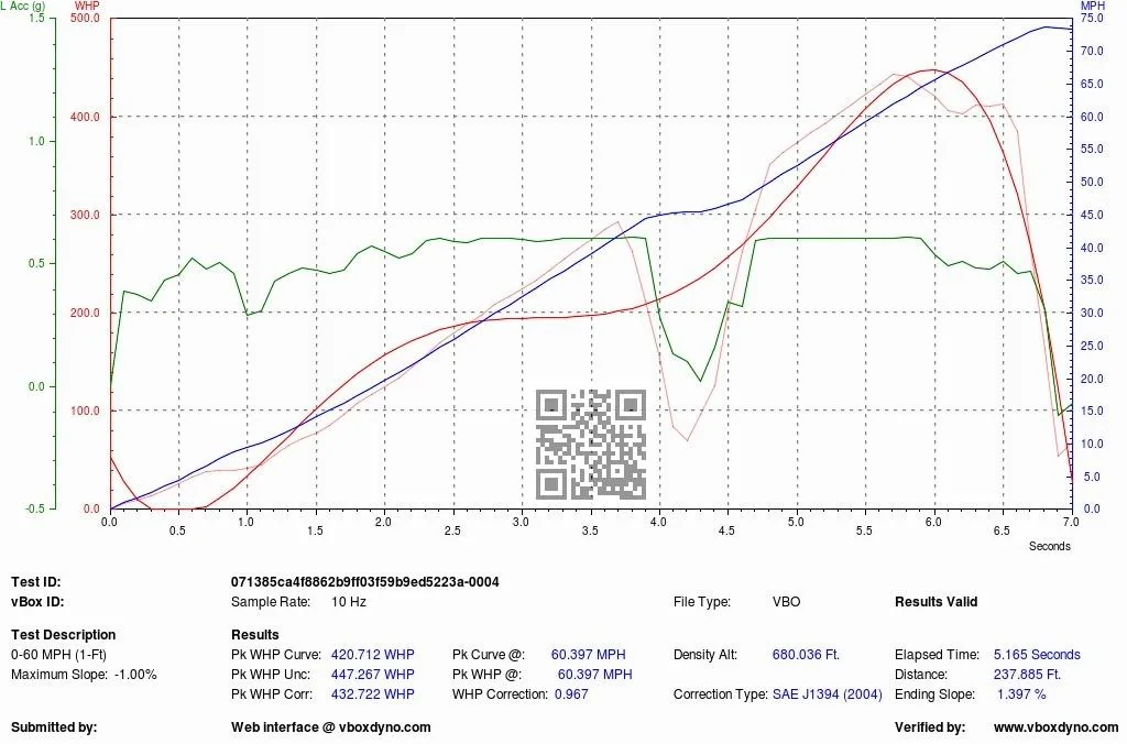

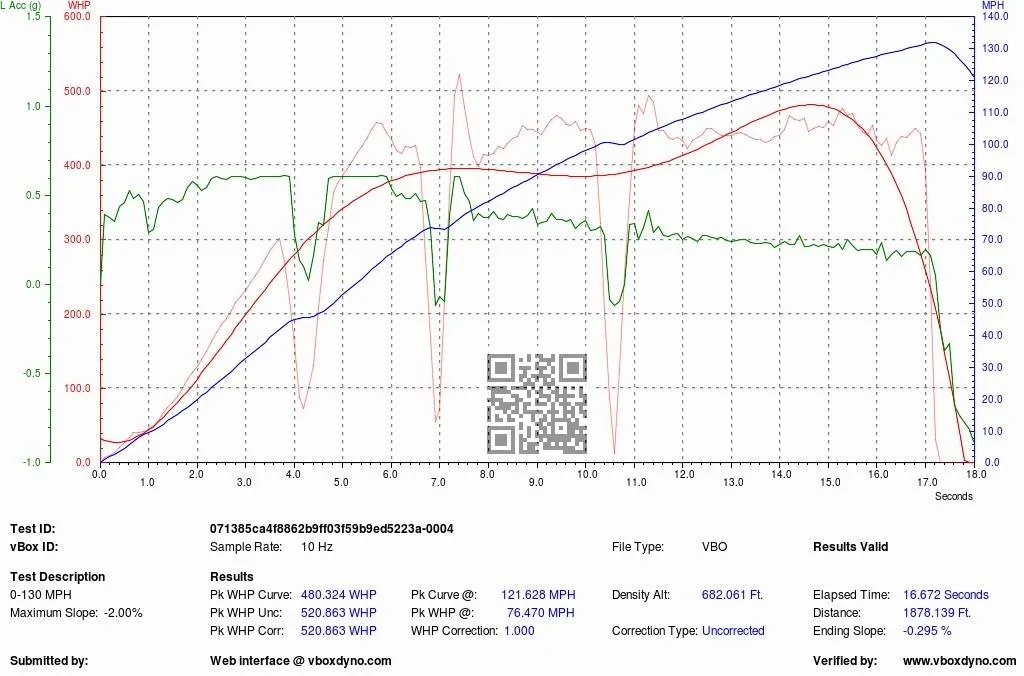

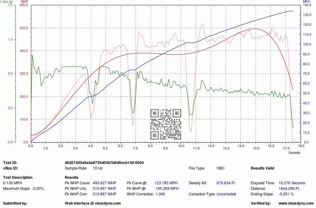

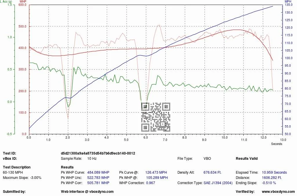

Earlier today, I took the car to Mexico for some vBox runs. The first run was botched and the results were not valid (more on that later). This is the redo of my earlier vBox runs. I made two 0-130-0 MPH runs.
Equipment:
Location:
Results shown:
About these tests:
vBoxDyno settings:
Conclusions:
Earlier today I posted a single 60-130 MPH run showing a 9.2 second result. That result seemed way too optimistic and required some extra scrutiny. After analyzing the CAN bus logs, I determined those results were in error. As of now, I haven't looked at the vBox file itself to see if it shows any signs of error. Those signs are usually due to the loss of satellite reception. Regardless the cause, I took the car back to Mexico and tried again. Please ignore my previous results.
The vboxdyno.com and vboxtools.com software analyzes far more tests than the ones I've posted. For a complete summary and graphs of all of the runs, please take a look and follow these links.

Results: 0-60 MPH (1-ft rollout method)
Run-1: 5.165 seconds @ 420.7 whp
Run-2: 5.016 seconds @ 391.0 whp

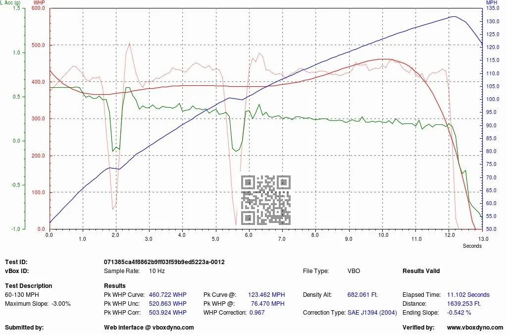

Results: 60-130 MPH
Run-1: 11.102 seconds @ 460.7 whp
Run-2: 10.959 seconds @ 484.1 whp

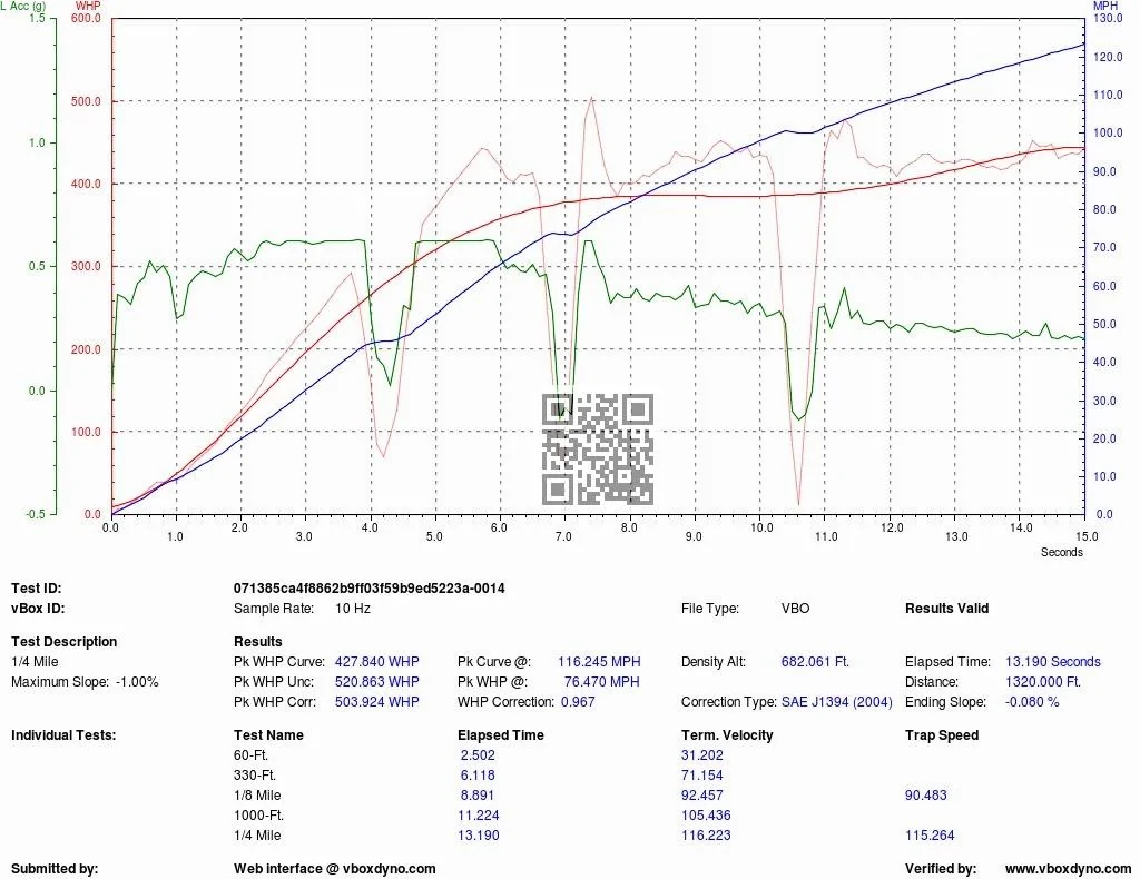

Results: 1/4 Mile
Run-1: 115.2 MPH @ 13.190 seconds @ 427.8 whp
Run-2: 115.0 MPH @ 13.081 seconds @ 445.7 whp

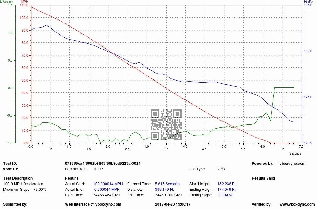

Results: 100-0 MPH Braking
Run-1: 5.616 seconds @ 389.1 ft
Run-2: 5.521 seconds @ 376.7 ft

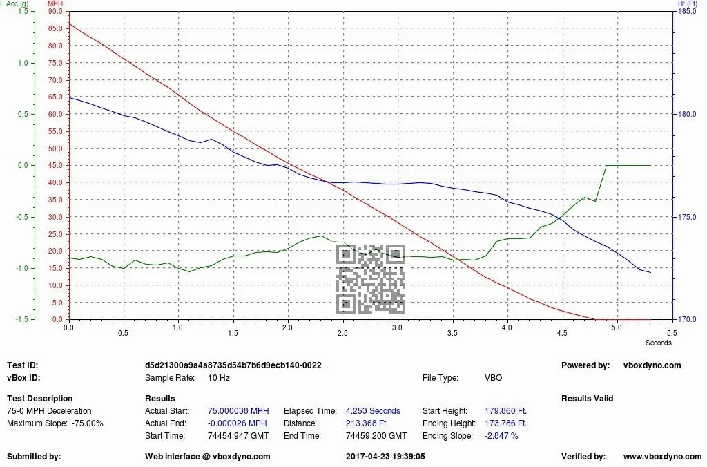

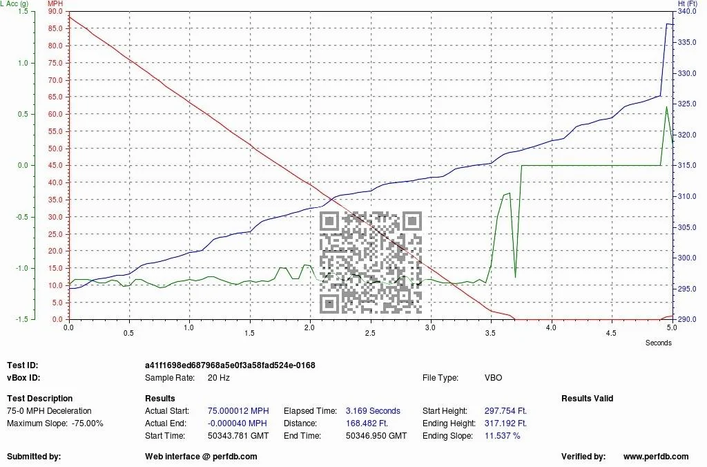

Results: 75-0 MPH Braking
Run-1: 4.265 seconds @ 214.7 ft
Run-2: 3.557 seconds @ 213.4 ft

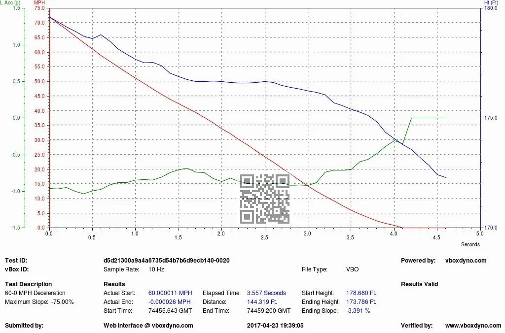

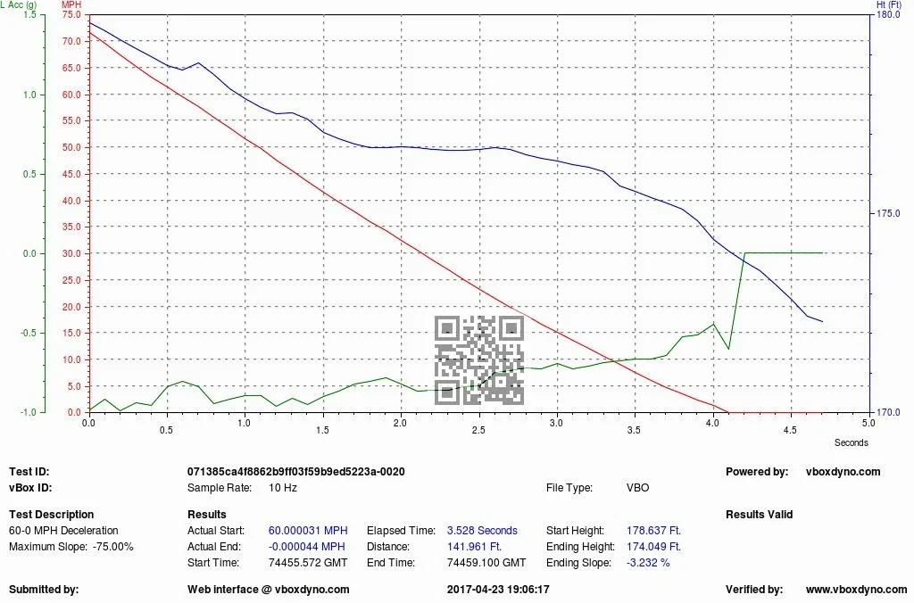

Results: 60-0 MPH Braking
Run-1: 3.525 seconds @ 142.0 ft
Run-2: 3.557 seconds @ 144.3 ft
Equipment:
- Video VBox Pro, 10 Hz
- Vehicle Spy running on a laptop to capture the car's full CAN bus data. These are full speed, full data collections.
Location:
- Mexico, of course!
- A place some of us know as "Steve Dinan's Raceway. It's a perfectly secluded 4-lane highway with protective high guard rails on both directions, with no side streets in one of those directions.

About these tests:
- One pass northbound
- One pass southbound
- Northbound road surface is smooth. Input in vBoxDyno as "Performance tires" with "Concrete" surface.
- Southbound road surface is not smooth; in some way's it's worse than asphalt. Input in vBoxDyno as "Performance tires" with a little extra tweaking to make it more than concrete, but less than asphalt.
- Braking tests were not full-force. The road surface strongly pulled the vehicle. For the sake of safety, it was not a full mash-the-pedal type of test.
vBoxDyno settings:
- Weight: Vehicle: 3710 lbs
- Weight: Driver: 195 lbs
- Weight: Gasoline: 36 lbs
- Vehicle: Frontal area: 24.2 sq-ft
- Vehicle: Coefficient of drag: 0.35
- Tires: Size: 315-30-19 (rear)
- Tires: Coefficient of Rolling Resistance (Crr), Run-1: 0.01875
- Tires: Coefficient of Rolling Resistance (Crr), Run-2: 0.02500
- Tires: Pressure: 32 PSI (from onboard computer)
- Tires: Weight: 28 lbs (Tirerack)
- Tires: Sidewall ratio: 2.00 (this setting isn't related to aspect ratio)
- Tires: Wheel weight: 22 lbs (Carbon Revolution GT-R weight + 3-lbs)
- Tires: Wheel weight distribution: 65%
- Weather: Ambient temperature: 66.2 deg-F
- Weather: Ambient pressure: 30.03 in-Hg
- Weather: Humidity: 46%
- WHP Correction Type: SAE J1349 (2004)
- WHP Correction Factor: 0.967
Conclusions:
