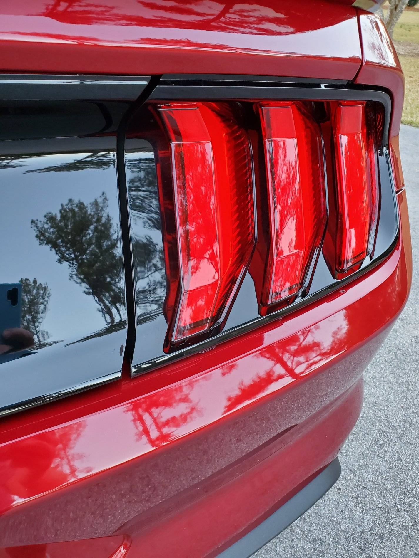

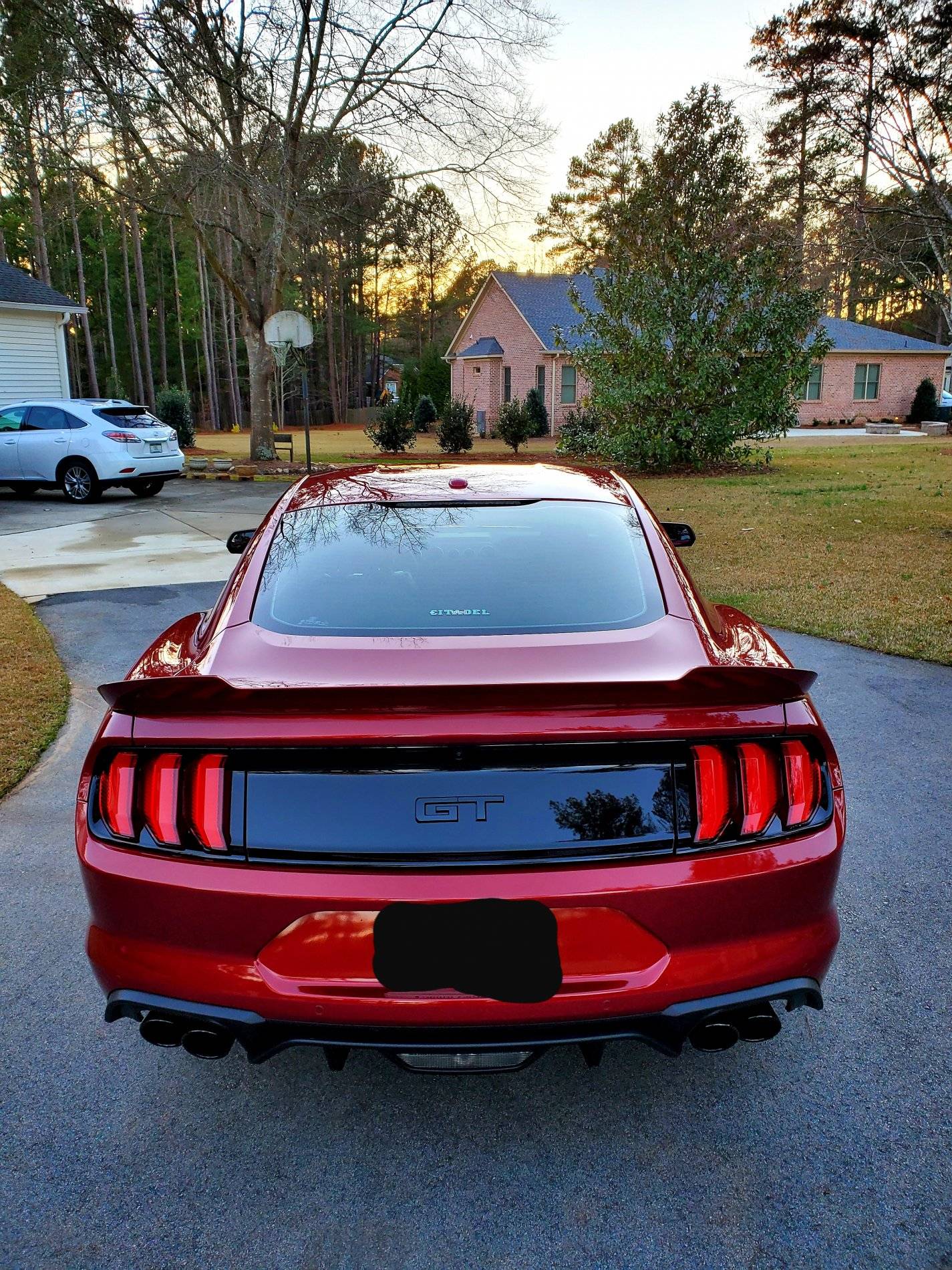

So I installed the decklid. I have the exact same gap that you do on the passenger side.

Sorry for the delay. Took a few pics tonight after I got the car all cleaned up. The gap is there... But like you said, it's something only I will probably notice. I may switch back to my Ford Performance decklid eventually, but for now I'll leave this one on.

No worries. Doesn’t look so bad. Hard to tell honestly. Car looks great and that color is beautiful.

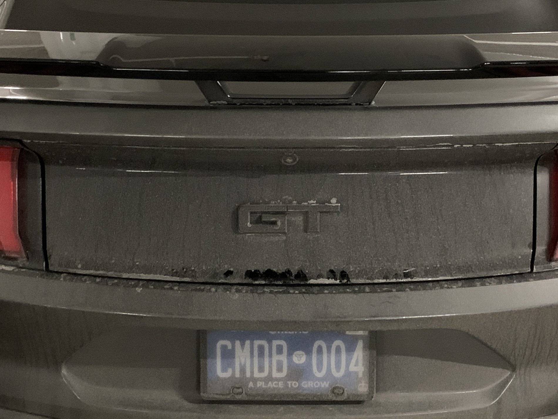

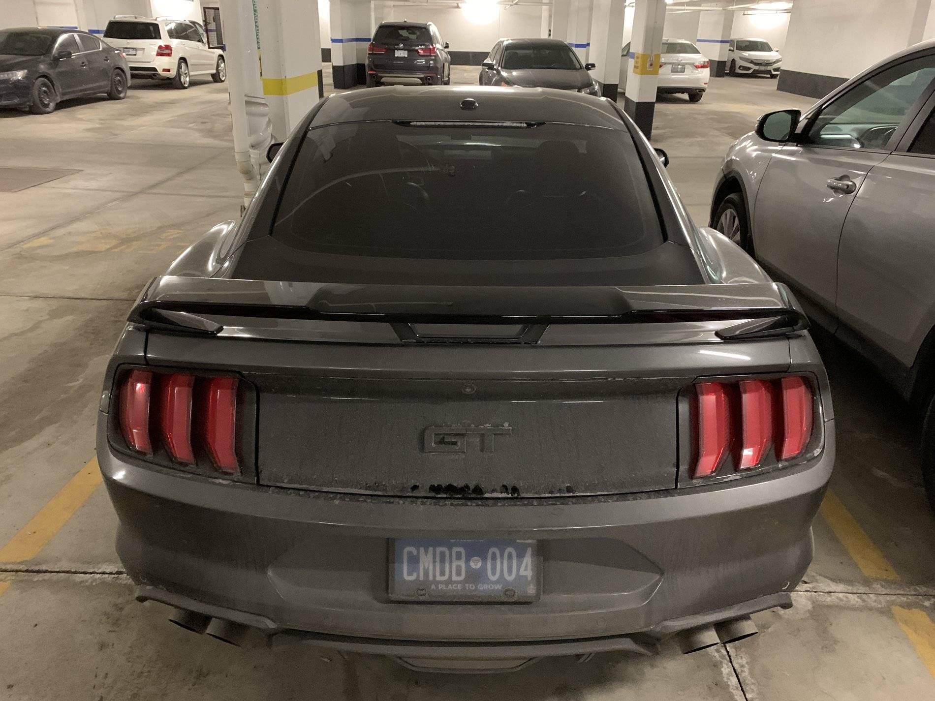

Update for you. With help from boos550t I adjusted the trunk latch and now the gaps are much better. It’s not a hard job, just takes some patience. There are two 8 mm bolts that you unscrew and then adjust up, down, left and right.
Here are some photos after today. Don’t hate me to much I literally just cleaned the car and then it snowed again. Stupid Canadian winter.

Exactly. Take off the plastic cover in the trunk. It has four black retaining things. They just screw on and off. Then I loosened the latch so I could move it. It’s going to be counter intuitive but moving it up and down also affects the gap on the left and right. Just be careful not to slam it closed. You can just bring it down to see where it sits. It’s going to take some time to play with it until it gets where you want but it’s very easy.

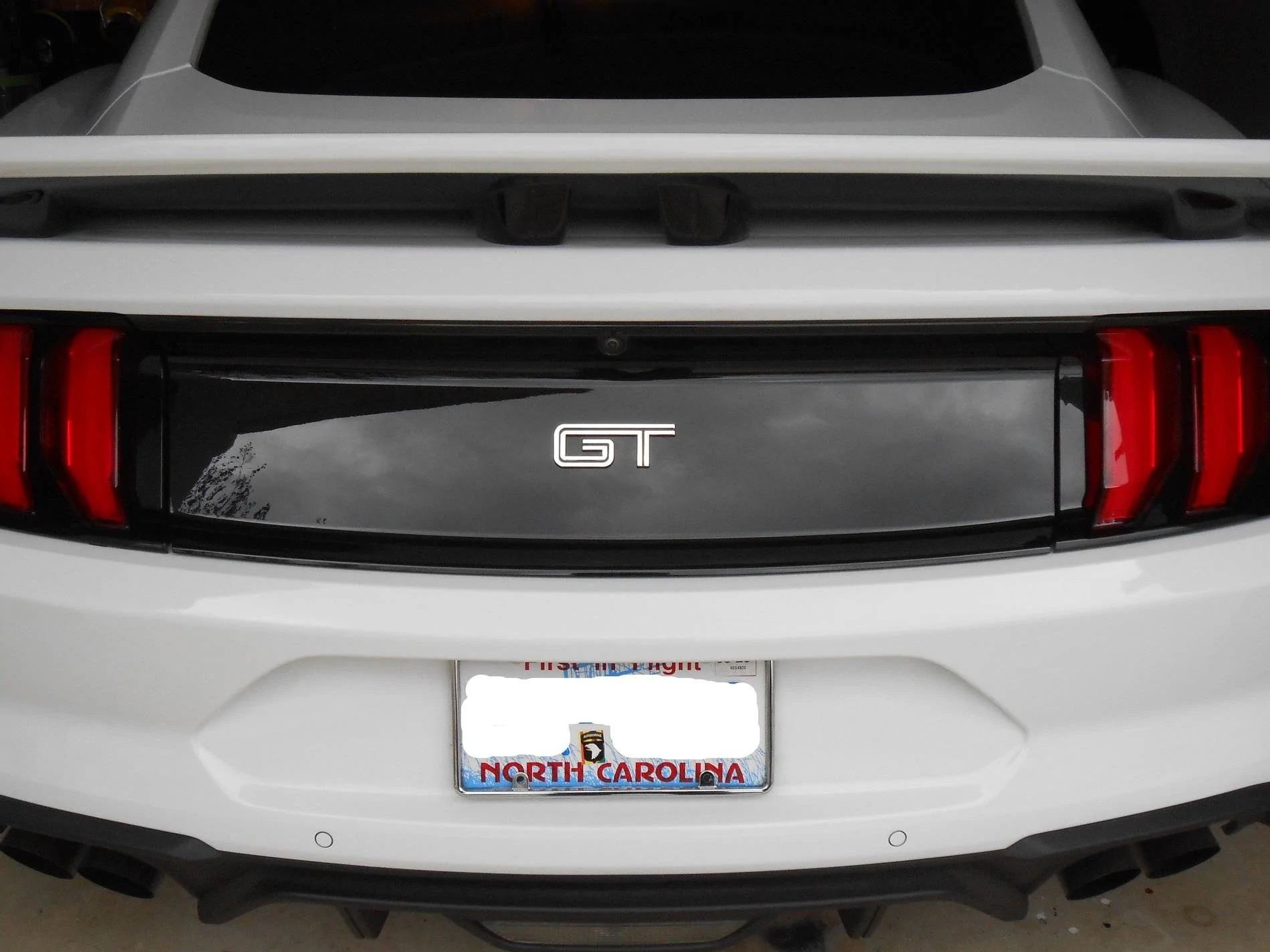

I didn't like the huge GT emblem so I replaced the rear panel and added a 2010 GT fender emblem. Changing the rear panel also got rid of the line on either side of the emblem. The black insert also looks good with the black panel

Looks good. Great idea.

Looks like the Mach E GT emblem.

Where did you get this decklid panel?
