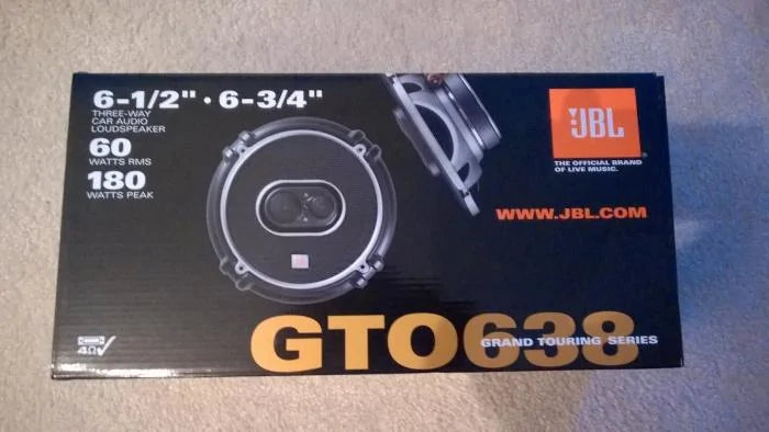

2. Rear speakers. #2 thing to do, if you like sound. I have the upgraded system with the subwoofer. I love the system. The only issue I had was the rear speakers, which had no treble (and the base was not needed since there is a sub in the trunk. I upgraded to JBL GTO638 and could not be happier. Those speakers even out the sound. Speakers were like $60 to $80 at the time. http://www.amazon.com/gp/product/B003KN2TF8?psc=1&redirect=true&ref_=oh_aui_detailpage_o06_s00

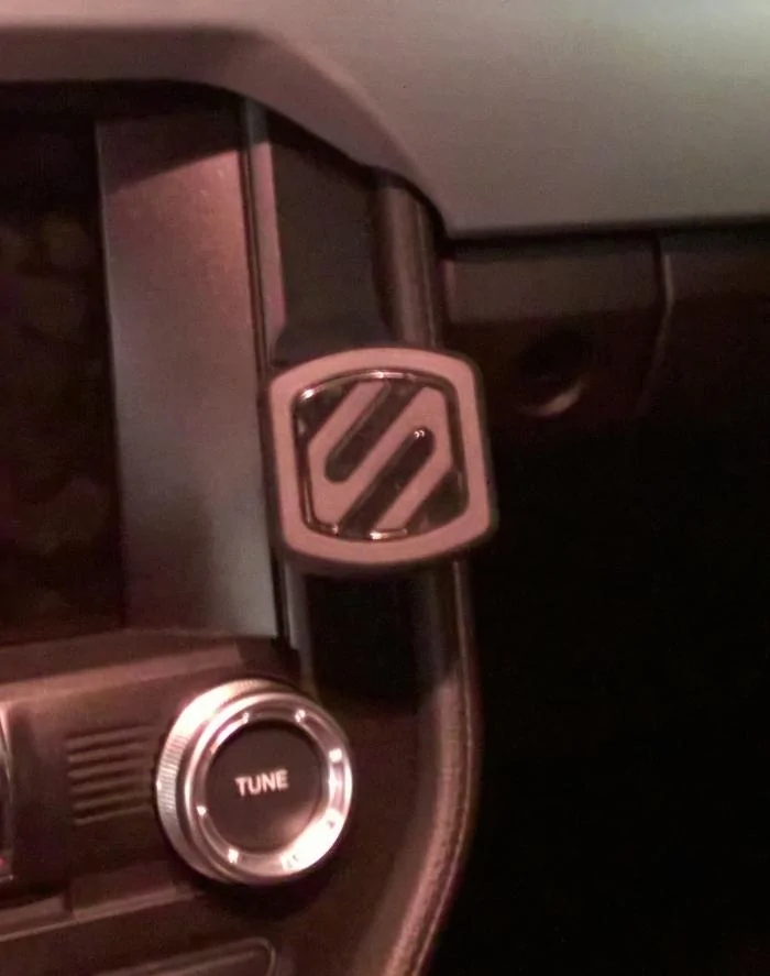

4. Scosche magnetic mount: mount your cell phone in your car. This is absolutely great. $14 http://www.amazon.com/gp/product/B00I608BJ8?psc=1&redirect=true&ref_=oh_aui_detailpage_o09_s00

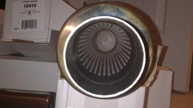

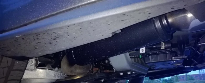

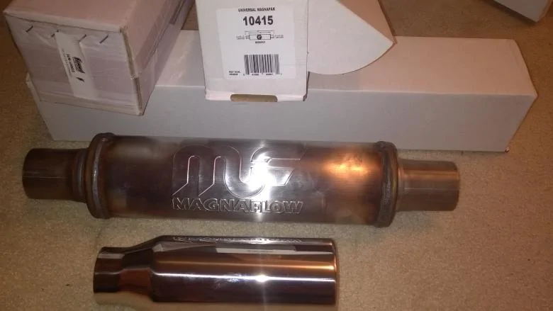

6. Magnaflow mufflers and tips: SummitRacing.com: Magnaflow #10415 ; Tips: #SUM-690032. Total cost: $200. Cost to install: 150 (tip included): $350 total. I left the resonator after speaking to a Ford tech who recommended I not delete for warranty purposes (if I took the car to them). The mufflers sound great, exactly what I wanted. BUT, if I had it all over to do again, I would leave the mufflers stock. Shop who performed the job: Fast Lane Performance Muffler, 12409 Crain Hwy, Brandywine, MD 20613, 301-782-3737

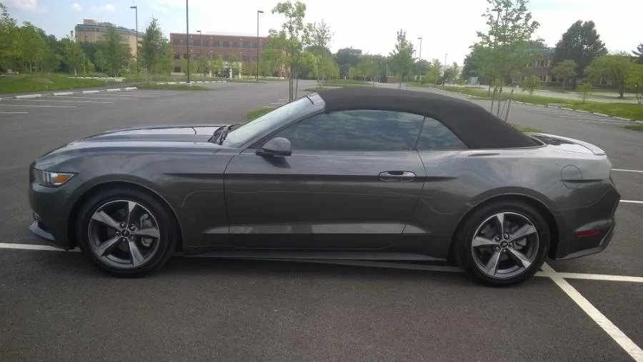

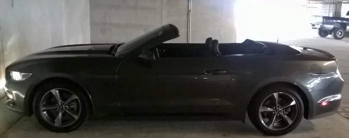

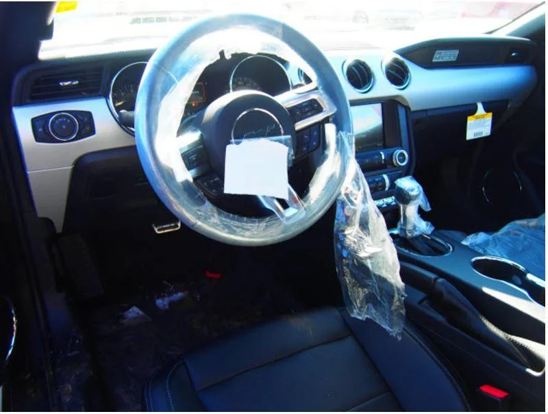

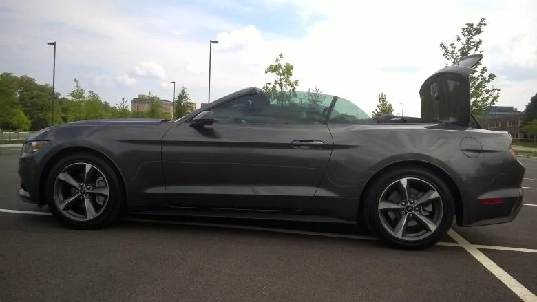

First time I saw the car (an online pic):

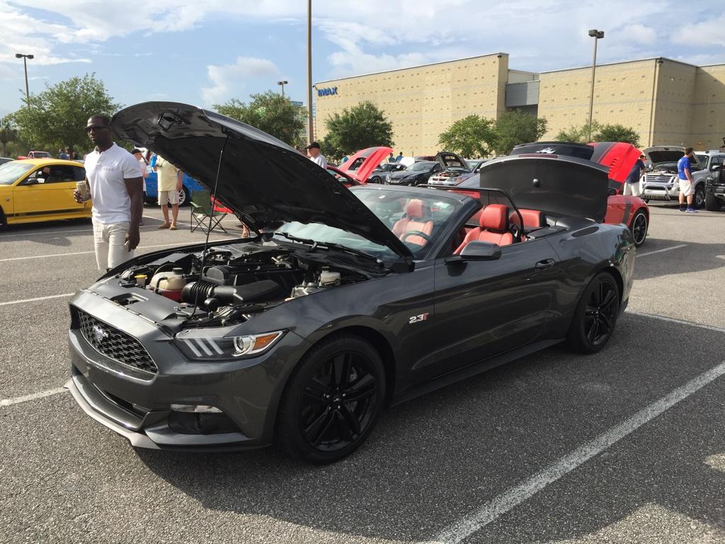

My first pic:
Phone mount. Very small... you can't really see it. Great for holding your cell:
Rear speakers:
Mufflers:

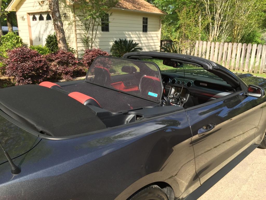

With focus on a cruiser, consider a windscreen - aero of the car is pretty good, but windscreen reduces buffet, noise, and extends the top-down driving season. Have always had these on euro verts, all prior were factory options (Porsche, Audi, Saab). I went with "Love the Drive". Works great - easy install. Flips up and down pending preference. Top will cycle with it up or down. And for all vert owners I suggest following this thread. http://www.mustang6g.com/forums/showthread.php?t=23687 Many verts are seeing this problem. BTW, what sort of gas mileage do you get. Mine is PP, and prob only averaging 21-23 mixed on my commute. Not as great as I hope, but plenty of smiles to the gallon! Great car color!:D

could not possibly agree more with the suggestion of the wind deflector. of all the mods I did to my last stang, it was far and away the best one, made driving so nice.
I kept it when I sold mine to put on the '16 I'll be ordering soon.
