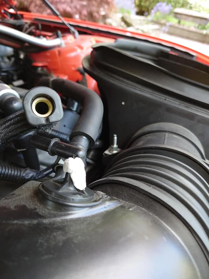

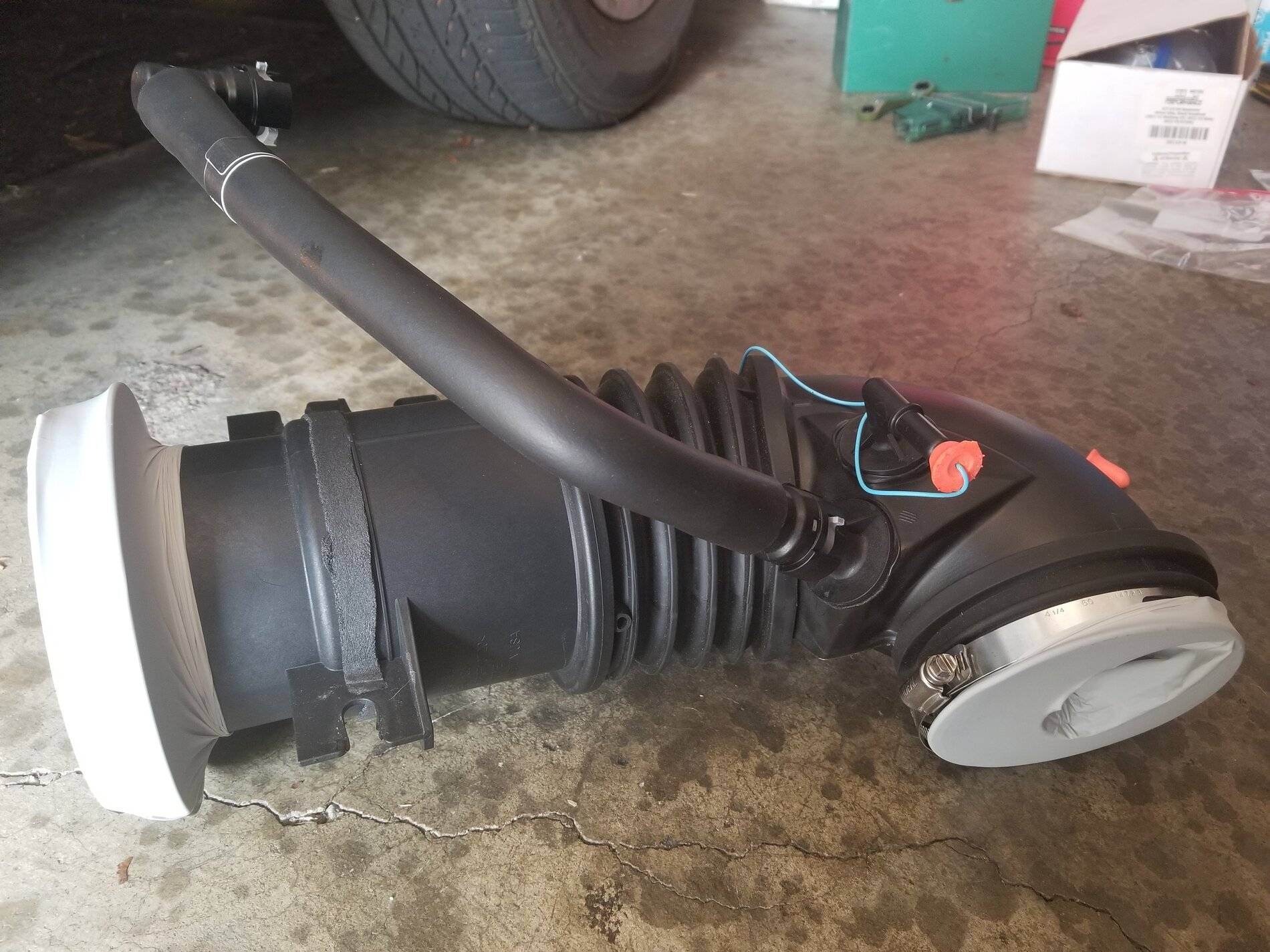

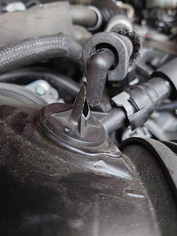

Did you have pinging with Power Pack or without or with both? Mine only pinged with PP, but no issues without whatsoever...Yep, I had pinging at low RPM due to a vacuum leak on the hose that attaches at 90Âş to the intake piping past the sensor. Some plastic weld fixed the issue. Easiest way to tell that you have a vacuum leak is to look at live OBD2 data for short term fuel trim on both banks using an OBD2 scanner. If it's more than 10% at idle but goes down as RPM increase you have a vacuum leak.
