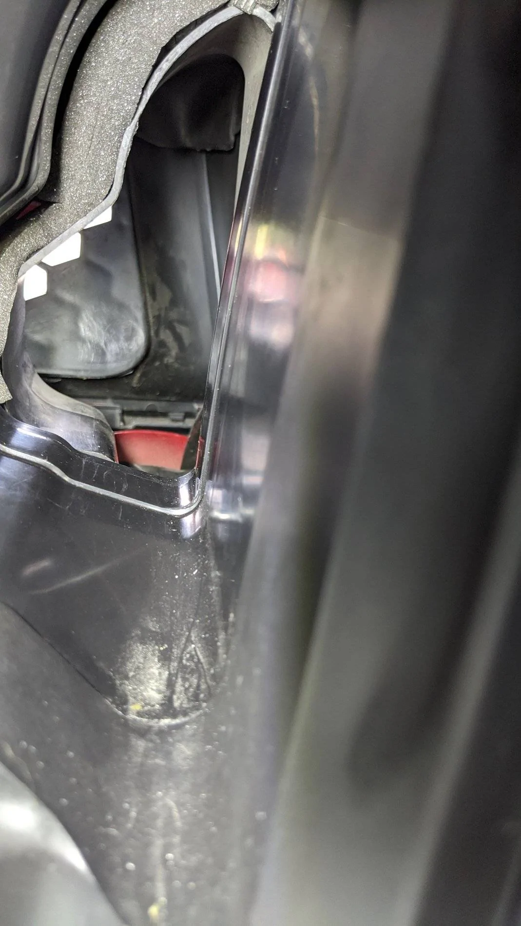

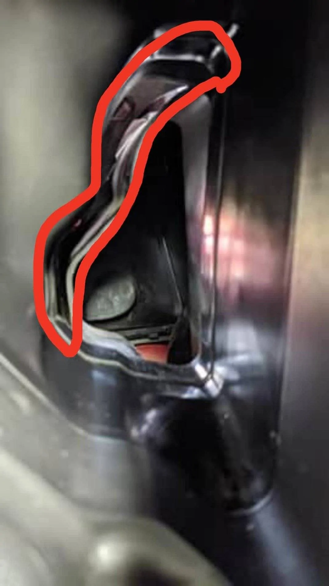

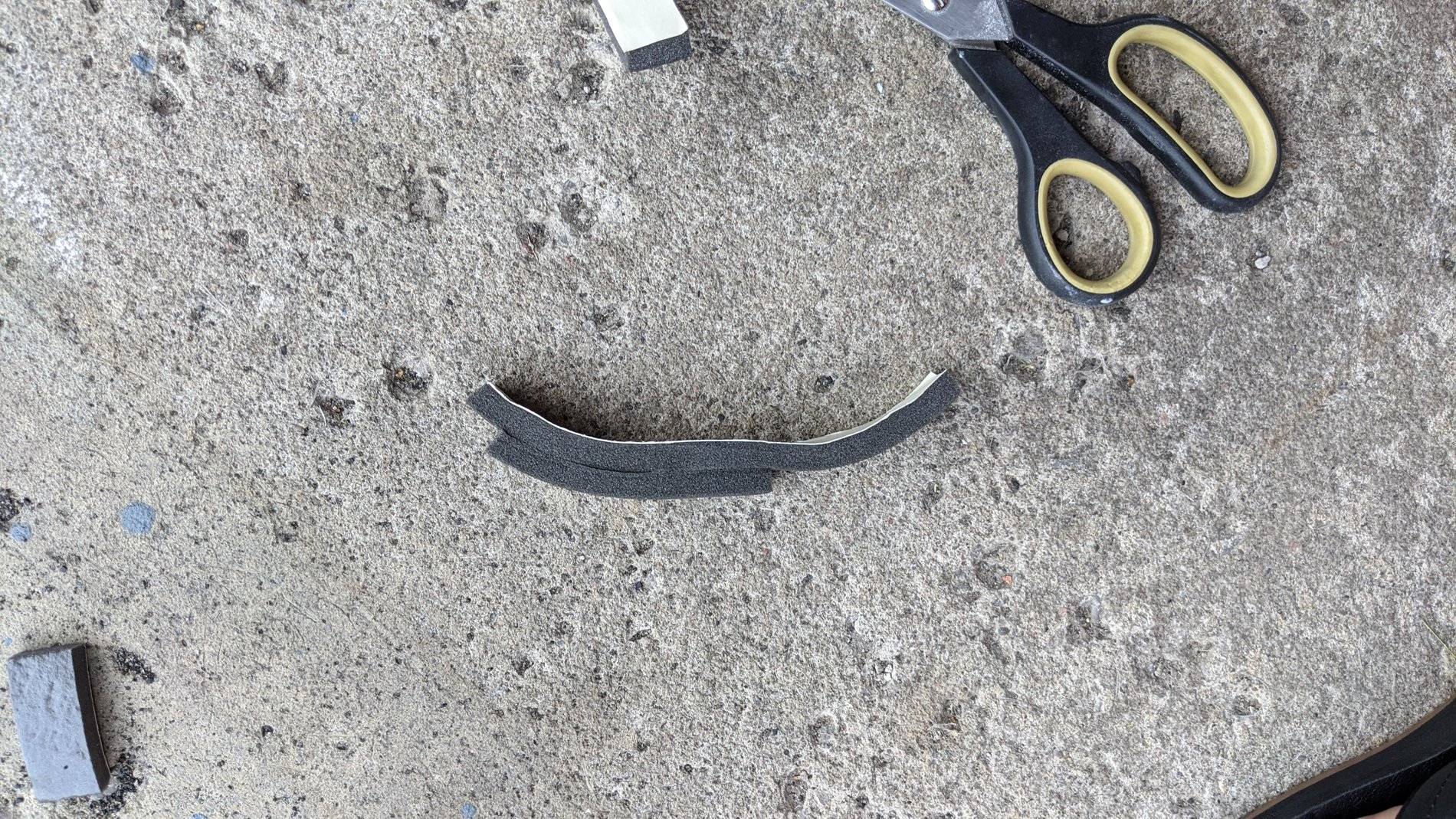

I've taken some time to start better sealing my intake. I have a 3 pronged plan:
1)seal the gap where the gt350 snorkel meets up with the gt radiator support opening (see photo)
2)seal gap in snorkel where the gt350 snorkel is cut (gt radiator opening is larger)
3)improve the sealing to the hood.
The above can be done without removing the bumper...if you're patient.
1) I sealed this gap using self adhesive rubber foam strips used to seal drafts. (see 2 photos). The seal isn't perfect but a significant improvement.
2) using some thick duct tape (black to be less visible if I run a velossa tech) I made a ramp to close off this opening. Another member did what they called the "flashing mod" but this didn't require bumper removal and could be done by sticking your hand down the snorkel from the airbox (with the filter removed of course).
The above 2 changes brought cruising AITs from 5C over ambient to 3C over ambient. It seems to recover better as well. A but of heavy throttle at lower speeds increases IATs quickly so I suspect the intake begins to ingest hot engine air from the back of the airbox that isn't sealed to the hood.
3) I have not completed yet. Using some tape pieces on the rubber seal of the airbox, I identified that the rear portion of the rubber seal is not contacting my hood liner.
My plan is to use the same foam from 1) and stick it to the liner in the right location. The colour matches the liner almost exactly so I'm hoping it doesn't look too goofy (so long as I can apply it in a single nice strip). My challenge is determining how to exactly place the foam rubber. I'm considering going back to the store to find wider foam so placement is less sensitive.
Will update as I get more done!
