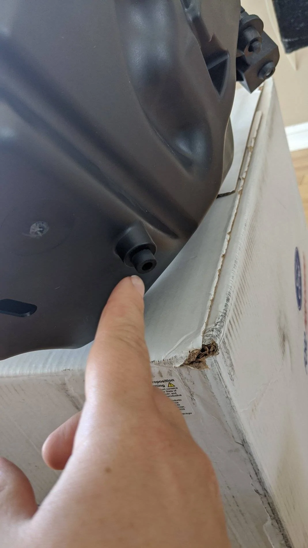

Sorry,another question. I was exploring the box of parts and found a small rubber plug (maybe 3/16 in. in diameter?) In the bottom of the box. There are 2 holes in the bottom of the filter housing, a slot and a round hole. It looks like it is supposed to plug the round hole. Do you guys know?
See page 3 of the instructions booklet. It plugs the hole left by the sound tube in your firewall. The filter housing gets its air from the front of the car via the slot and the small hole on the bottom is the drain hole for water entering it.

Right, I wasn't talking about the firewall plug. Here's a photo of it in the hole I think it belongs in:
