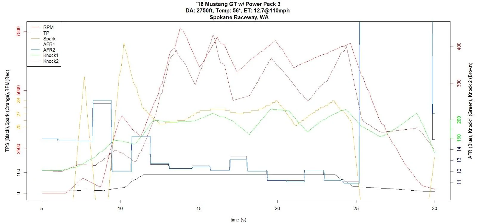

So I was looking for the factory plugs today and found that the part number has been superseded and the new Motorcraft plug is a platinum not iridium? Anyway I've read that people are having good results from brisk racing plugs. Main concern is the timing drop up top from 3-4 shift. I have a upr catch can. Was running 92 with octanium. Powerpack 3 car with the Ford Racing Calibration.

All of that information is on the graph above. Times are low because of the altitude and my 60ft needs work. The dealership had sportline springs installed and I haven't put good drag springs or shocks on it yet. I do have the cb005 kit and upgraded end links. Currently cutting 1.9 60ft. I have run 12.4 at a no prep deal but was still at about 1000ft in Yakima Washington at Renegade Raceway. Once my suspension is dialed in I'll make a trip south for some real times in good air at a well prepped track.
