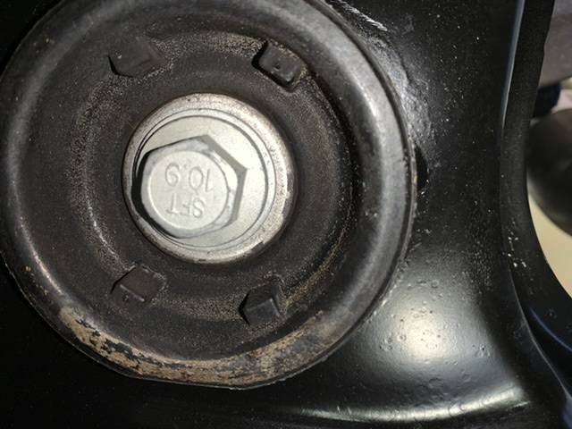

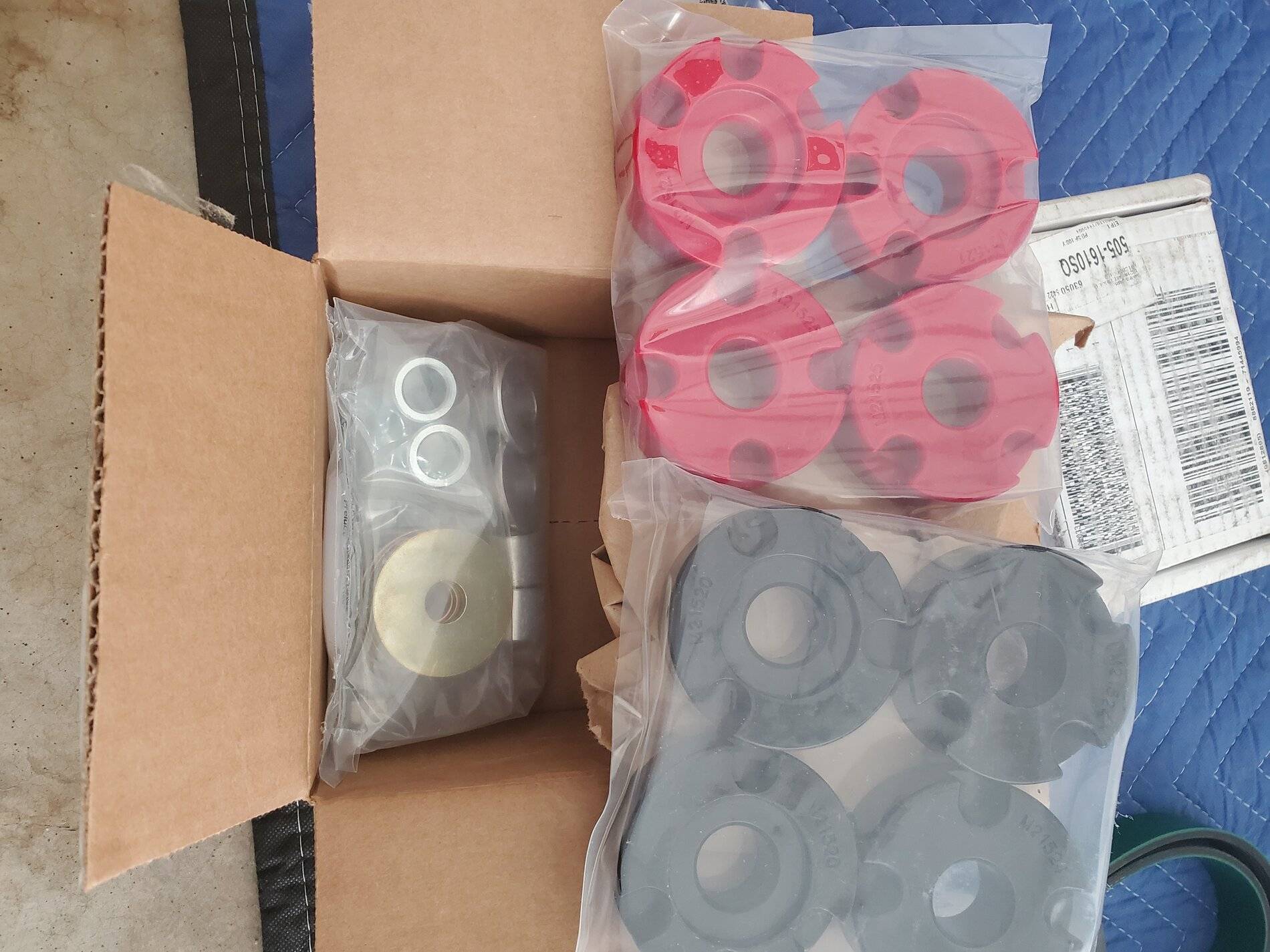

You will find one of the rear diff bushings doesn’t match the Steeda inserts. This is what the bushings look like. Don’t remember which side was different.The bag is just an install kit for the pipes. Has bolts and instructions. One box is the rear diff mounting bushings
I used a knife to slice out the slot in the red insert to make it fit. Don’t have a pix of that.
