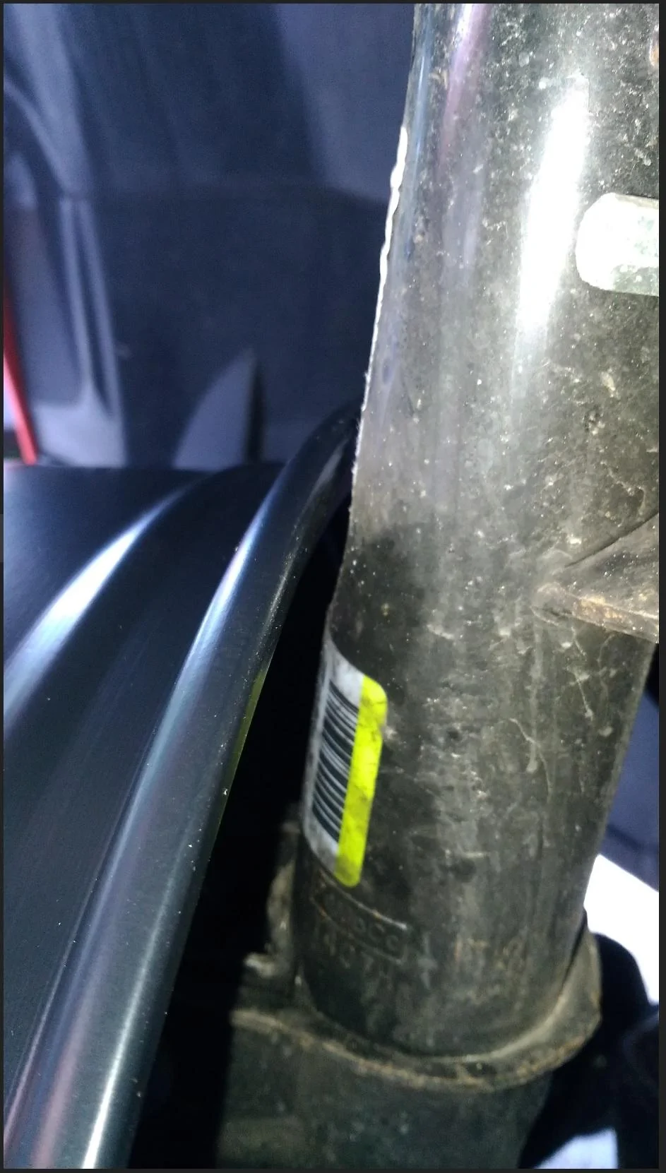

Clearance to the strut is like a credit card or 2 thick.

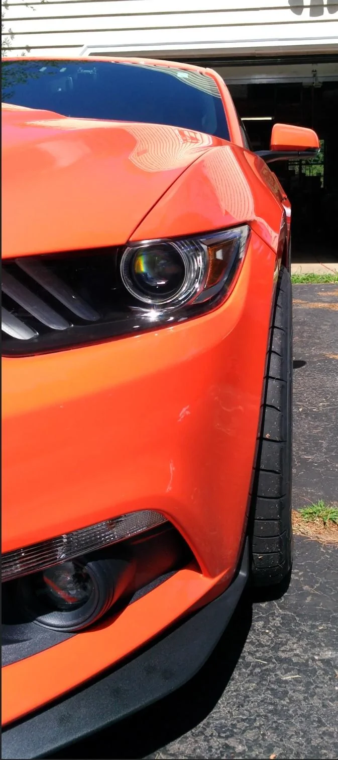

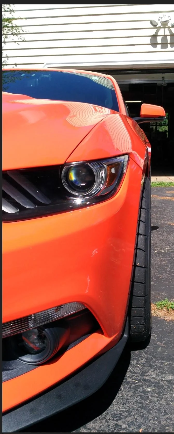

With the Stock PP Suspension the tire sticks out passed the fender a little in the front may be about .25"
