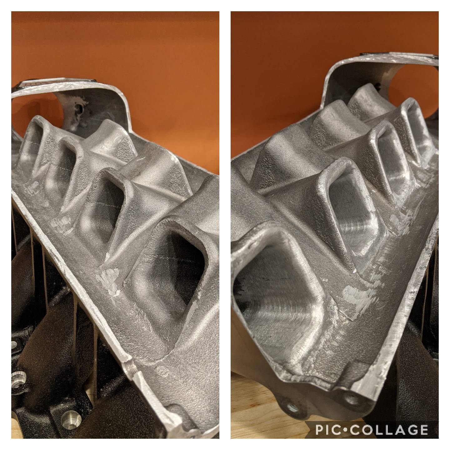

This is giving me horrific flashbacks of having 40+ hours tied up in meticulously porting a pair of cylinder heads....
I have 20hrs or so in this intake haha. Im done with it currently, im ahead of updates by a few weeks.

Lets get them ports at the head cleaned up.

I selected the Edelbrock based on runner length as it relates to my application. Centri blower, 314cid, 4c converter, 3.55 gear, transbrake etc. I figured it was longer than CJ and other billet manifolds, but shorter than 2018 for a good compromise of mid/high rpm performance. Cost was a factor also. I needed aluminum and wanted to run the stock TB, Edelbrock it is. Few pics that helped me with the Edelbrock choice.

Sequence of the porting pics may be off a touch fyi
Yeah, I stopped keeping track after the 40 hour mark mentioned. It was probably double that. Then came the 5-angle valve job....
The heads on this car are CNC ported. Maybe over the winter ill try to port the heads on the fox? Eek, sounds like work LOL.

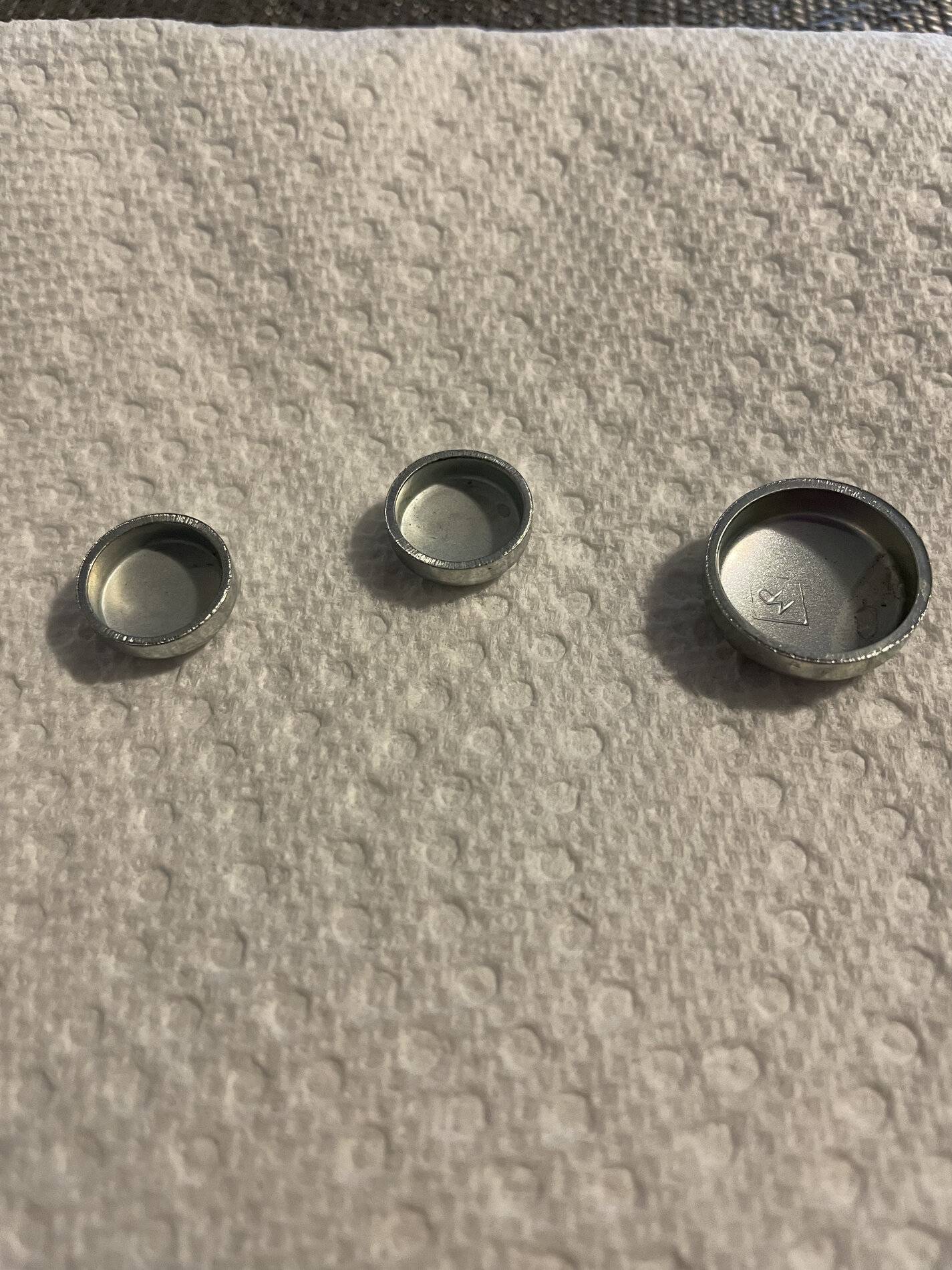

Following this build as I do mine. Quick question on best sealant for oil gallery plugs?

  • #430
Thread locker red

  • #433
Any engine shop can get those also.

Falcon
Thanks...I figured just wanted to check since these blocks don't come with doodads.
