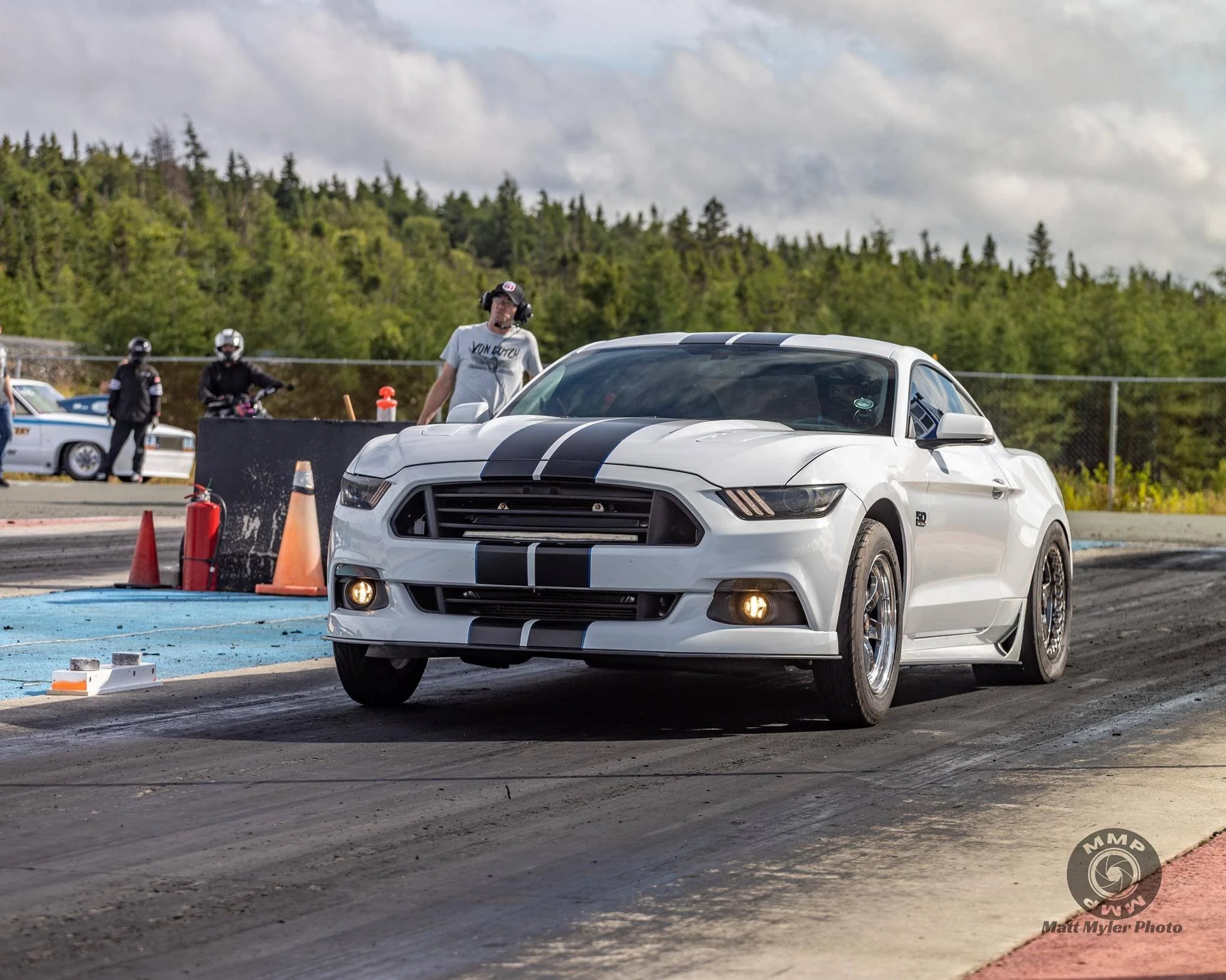

Hi all,
I’m installing my 15x9.33” wheels in a couple of weeks and looking for a 28x10.50 small tire drag radial that will perform well in mediocre track conditions. Car will be leaving on boost via the Boost Leash with C02 and 2-relay transbrake. Mustang is a fully built auto Hellion TT GT. Not interested in a bias ply as I have all adjustable Kelltrac Vikings that I can setup properly for a radial.
I ran 1.54 60’ last year leaving on 0 psi with the transbrake on 2500 RPM with 17” 305/45/17 ETSR’s. The car dead hooked.
I plan on running much more boost this upcoming season and looking for the best drag available for a 15”.
Thank you.
Shaun

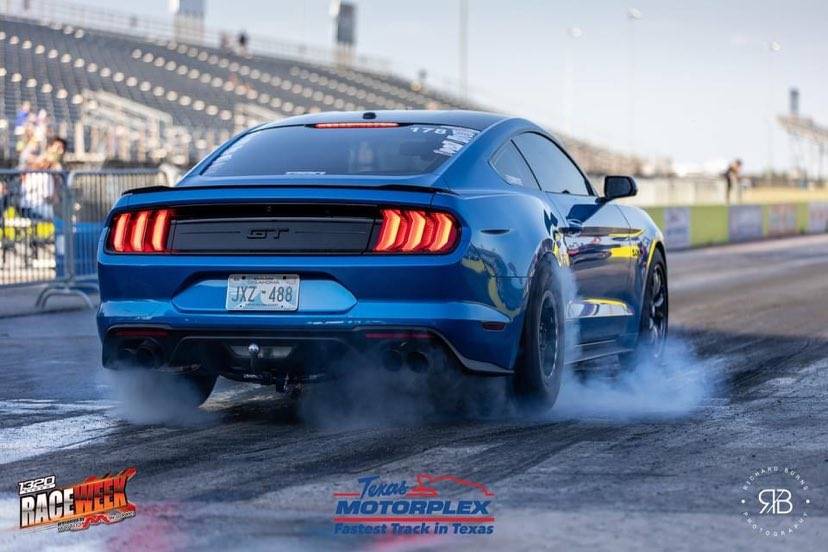

I've ran the following and had success with them all.
325/50R15 ET-R
315/60R15 ET Pro
275/60R15 ET Pro
For a 15x9.33 I would probably run a 275/60R15 ET Pro personally.

That's what I ran for Rockymountain Raceweek this last fall. I ran at five different tracks and definitely never had any issues, of course the car was turned way down to about 800whp to run the 10.0 index class.
