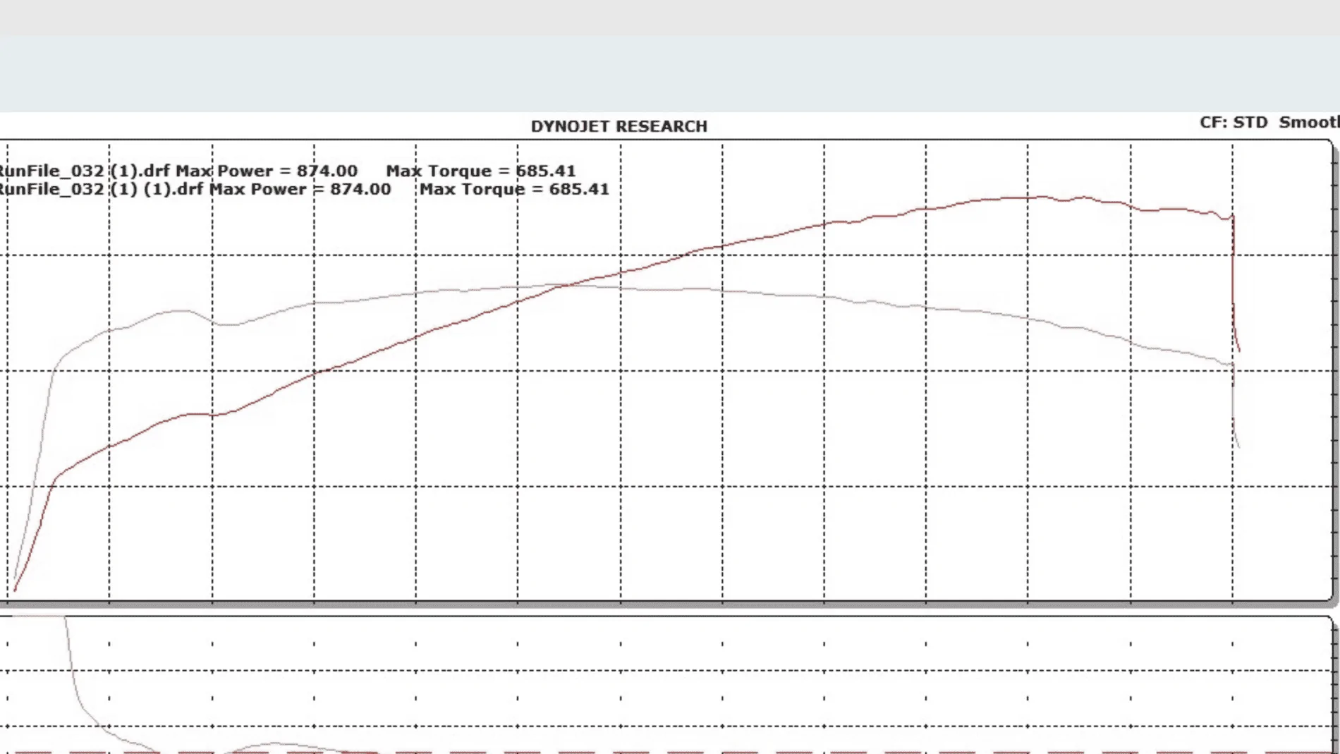

Not quite apples to apples but I have a 2.9 whipple /132 mm TB/E85/triple pumps/ID 1300’s on my RPG built voodoo and with the 3 inch upper /stock lower I am just just under 900 whp
Dyno may be conservative but that’s about the same as I made on my 18 with the Gen 5 whipple/132 mm TB /E85 and same 6 rib pulley
Lund tuned and he wonders if the diamond pistons are actually 12:1 compression as advertised .
I know torque is deliberately lower with the FP but he thinks it’s making power like a 10:1 compression motor .

I do think the pulley slipped up top as load and boost dropped a bit after 7500, so might have made more .
Both cars have stock manifolds /cat delete so long tube headers may be worth another 30-40 whp .
