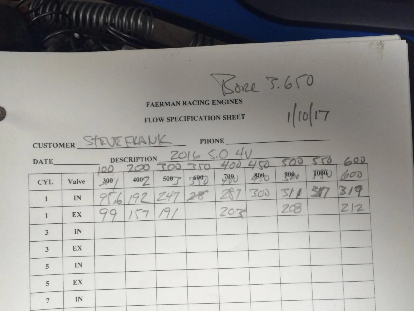

Here are the before numbers for the heads off it

311 cfm @.500 lift. Damn. I have a few sets of old mopar heads that have been touched by the best guys in the industry that dont come near that... lol.

are the flow numbers before or after the port job?

I would assume before, since it says before numbers..

Yes they are the before numbers
I've never seen numbers posted on what these
Heads flow so I figured I would do it
And while I had them off I might as well
Do the port work
I hope to have some after numbers today
