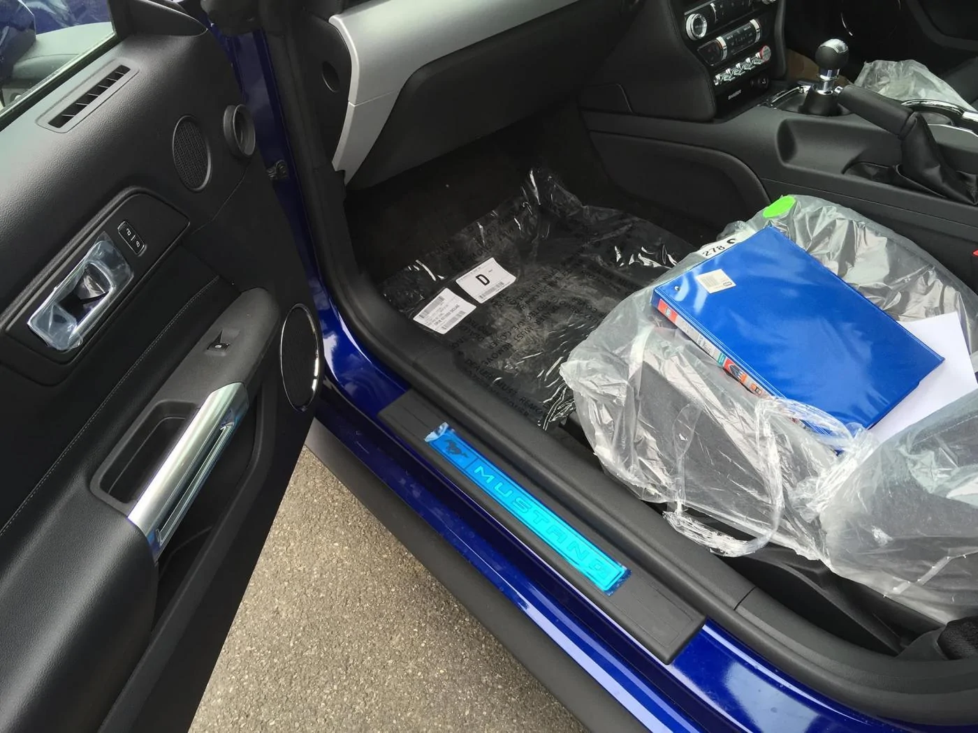

Car wasn't terrible upon delivery, but certainly showed the signs of a long journey.

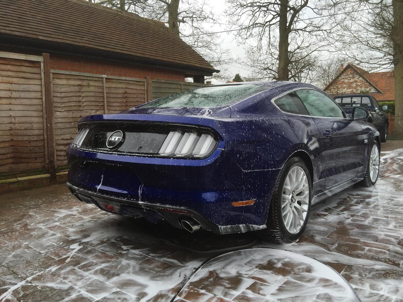

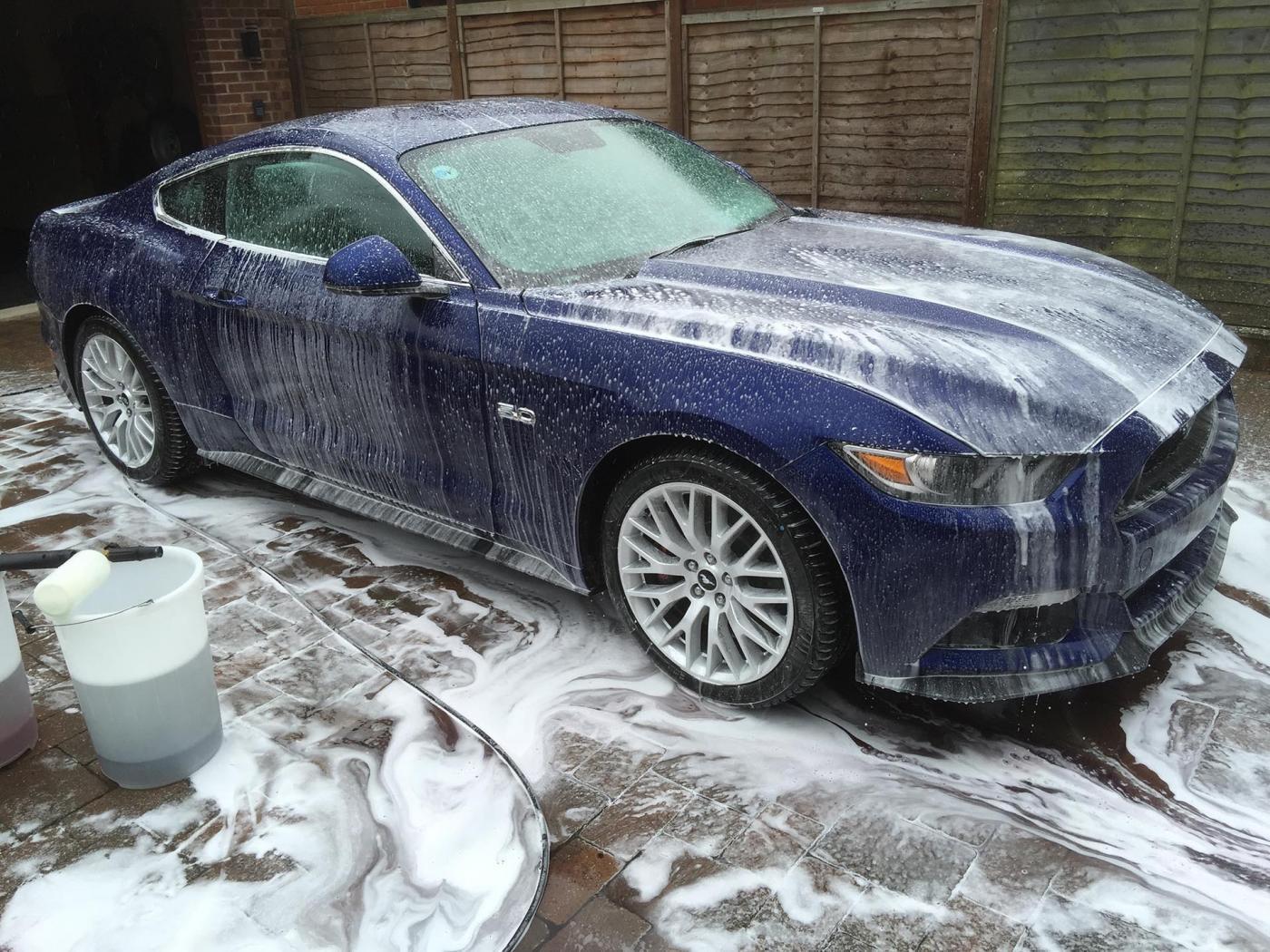

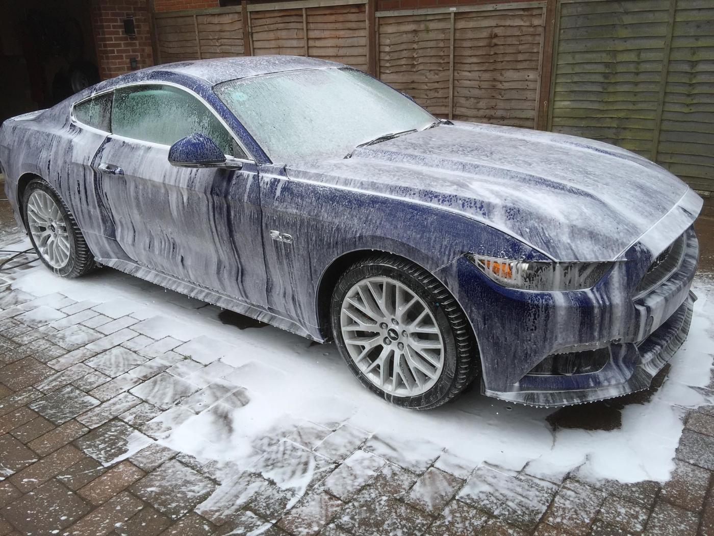

So, first up (after stripping stickers and covers etc.) was a good snowfoam dousing to loosen all the crud.
I have a decent Karcher pressure washer (big sucker) and snowfoam lance. Does the job nicely. Just spray on, leave to dwell and rinse off.
For those interested in product, I use Chemical Guys No Touch snow foam which gives a good foam and little residue.

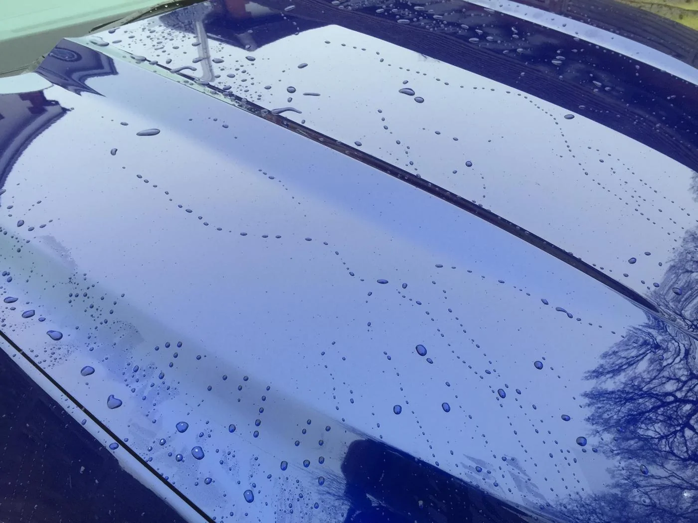

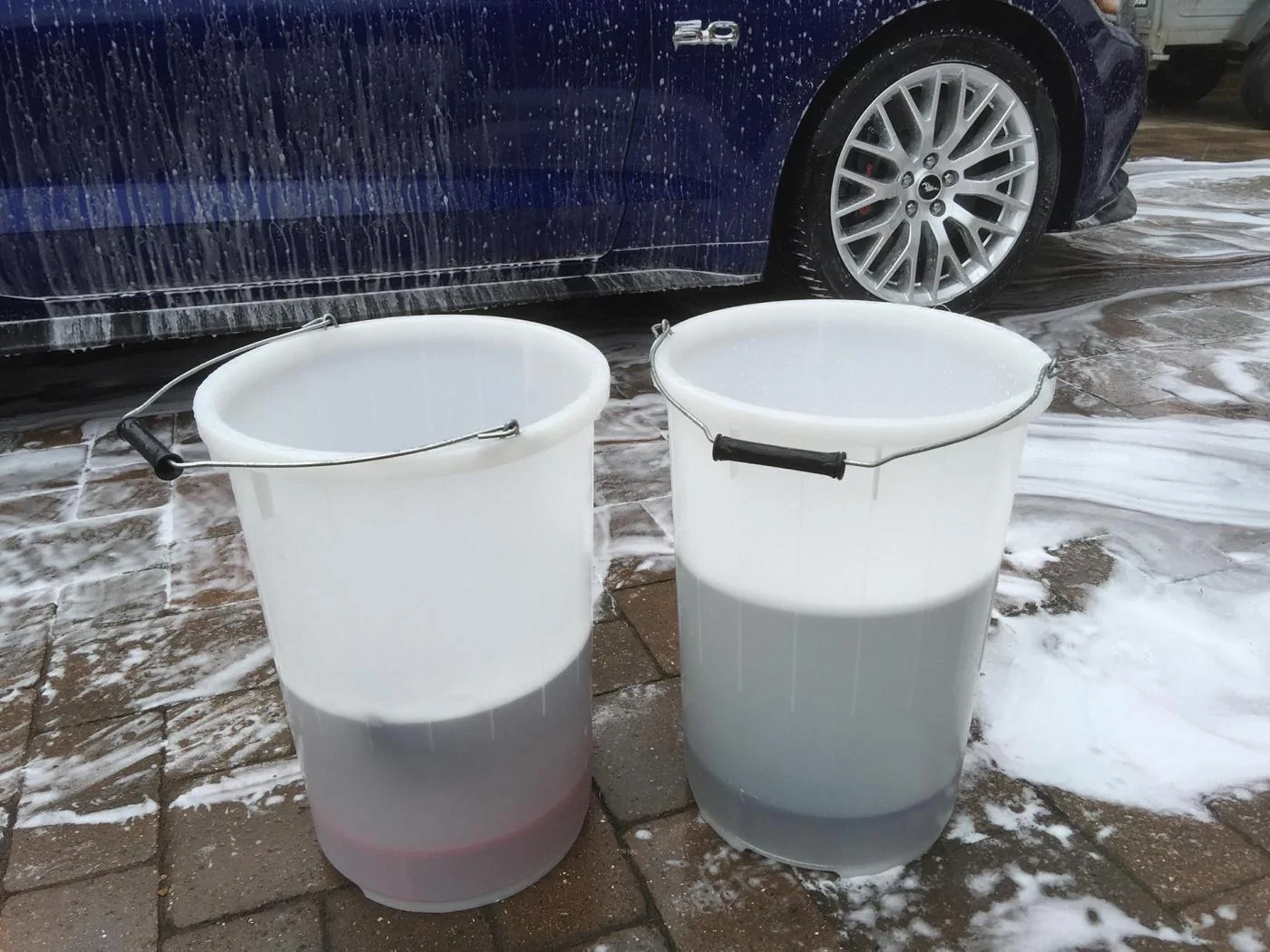

The foam is left to dwell to get rid of most of the crud, then rinsed.
Then it was a two bucket wash with wool mit (and Meguiars shampoo) and dry.
Car has a good deal of polish/sealant on it - so beaded up nicely.

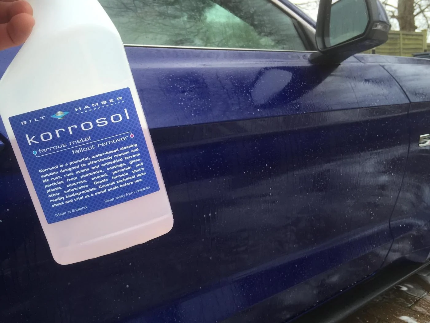

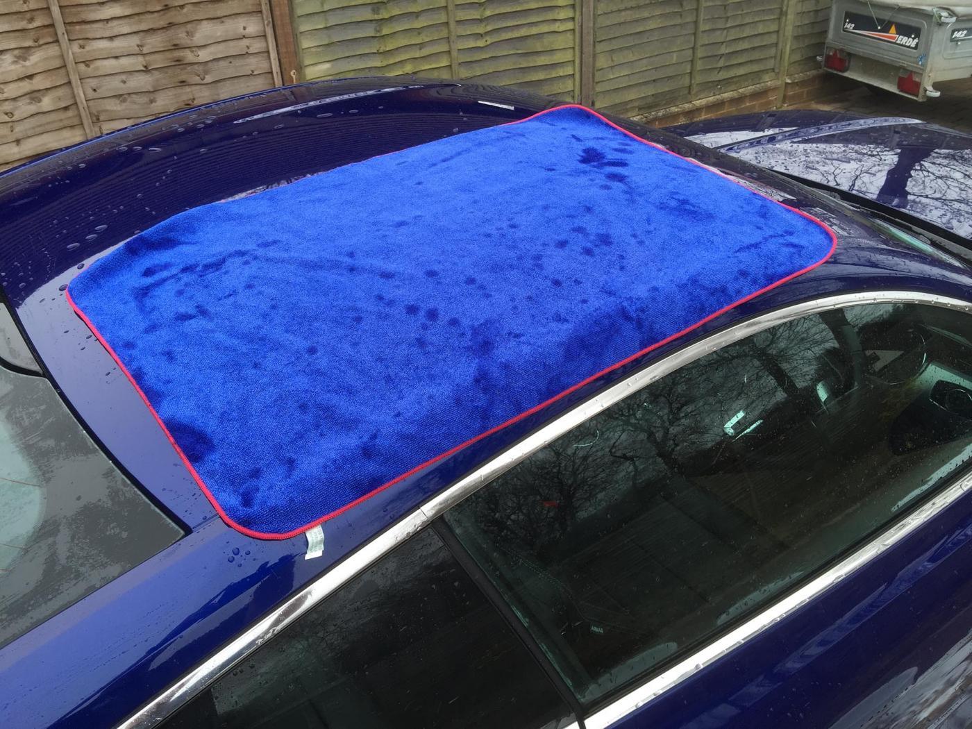

Car dried - I could then apply a decontaminant. This basically dissolves industrial pollution, iron, brake dust etc from the paintwork and wheels.
Amazing how much almost invisible cack there is, but car needs to be spotless and free of contaminants for the ceramic sealant to work properly.
For this, I use Bilt Hamber Korrosol.

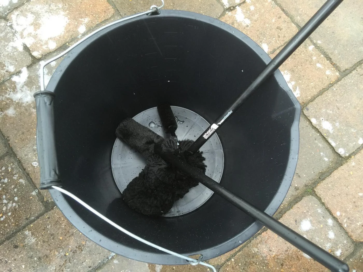

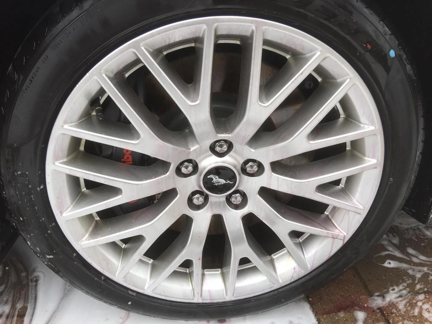

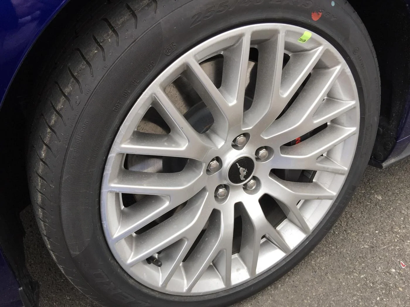

For these wheels, it was well worth investing in some decent brushes. They are a right fiddle to get inside especially around the Brembo calipers - so a decent set are well worth it.

With the anti-contaminant left to dwell for 5mins or so, car was then thoroughly rinsed and a second snowfoam application to make sure all the chemical was gone.

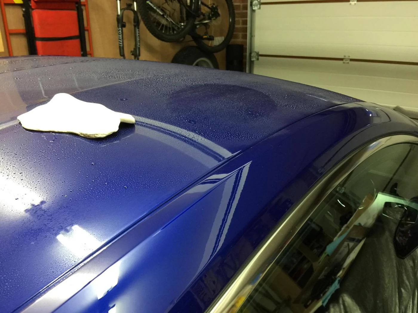

Then into the garage (courtesy of the rain) for claying.

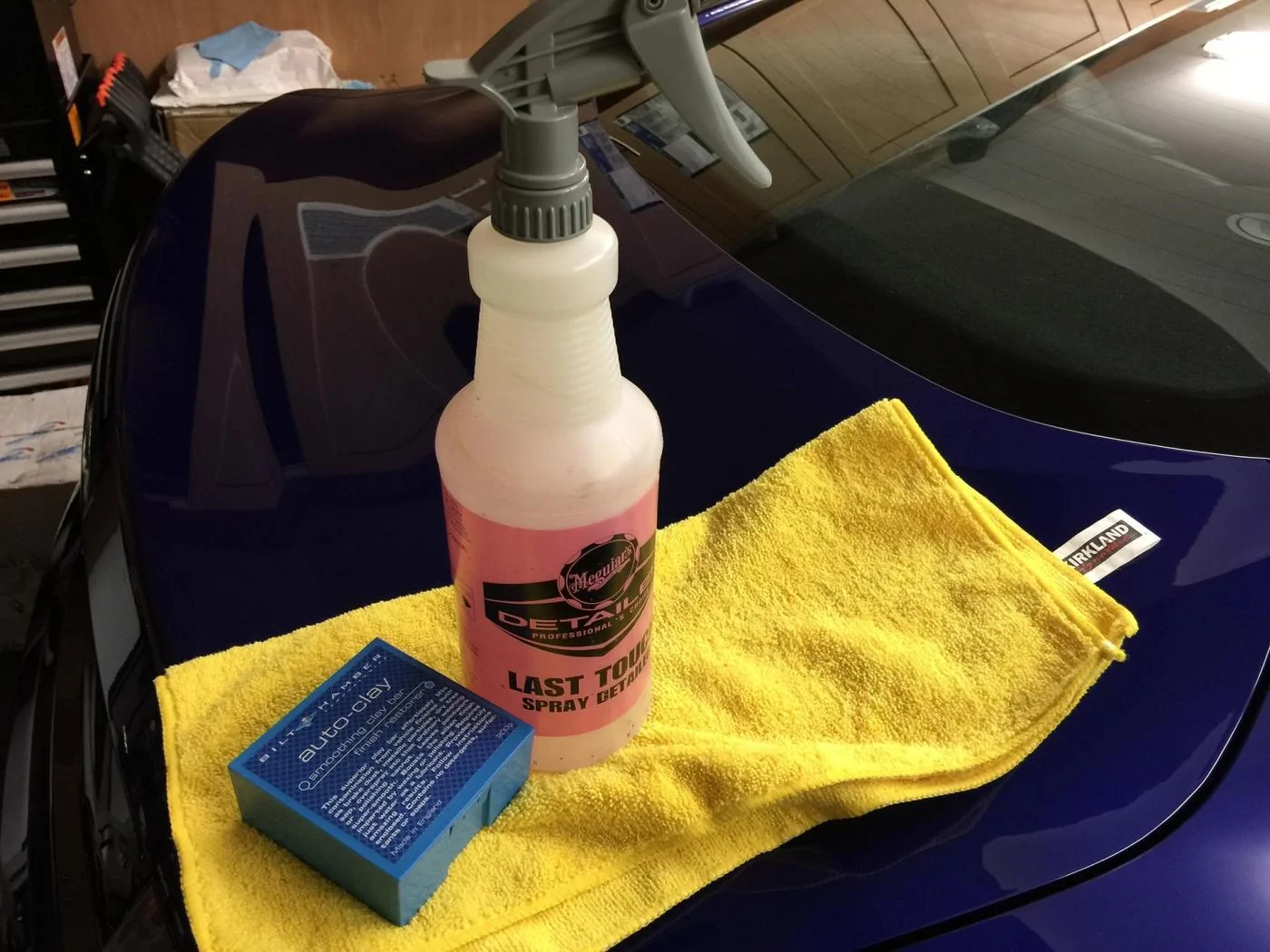

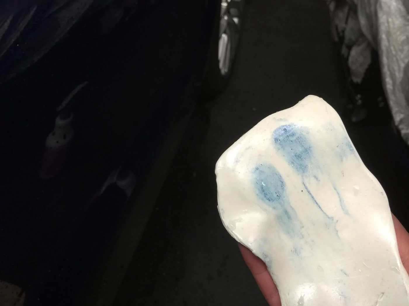

I used a Bilt & Hamber white clay and Meguiars quick detailer as a lubricant. Whilst most surface contamination was gone (courtesy of Korrosol and a good clean) there were a few stubborn spots and some overspray on the drivers door (to the left of the highlight in the pic) that it removed.
There was also an odd oval on the roof? Correction should sort that if the clay doesn't.

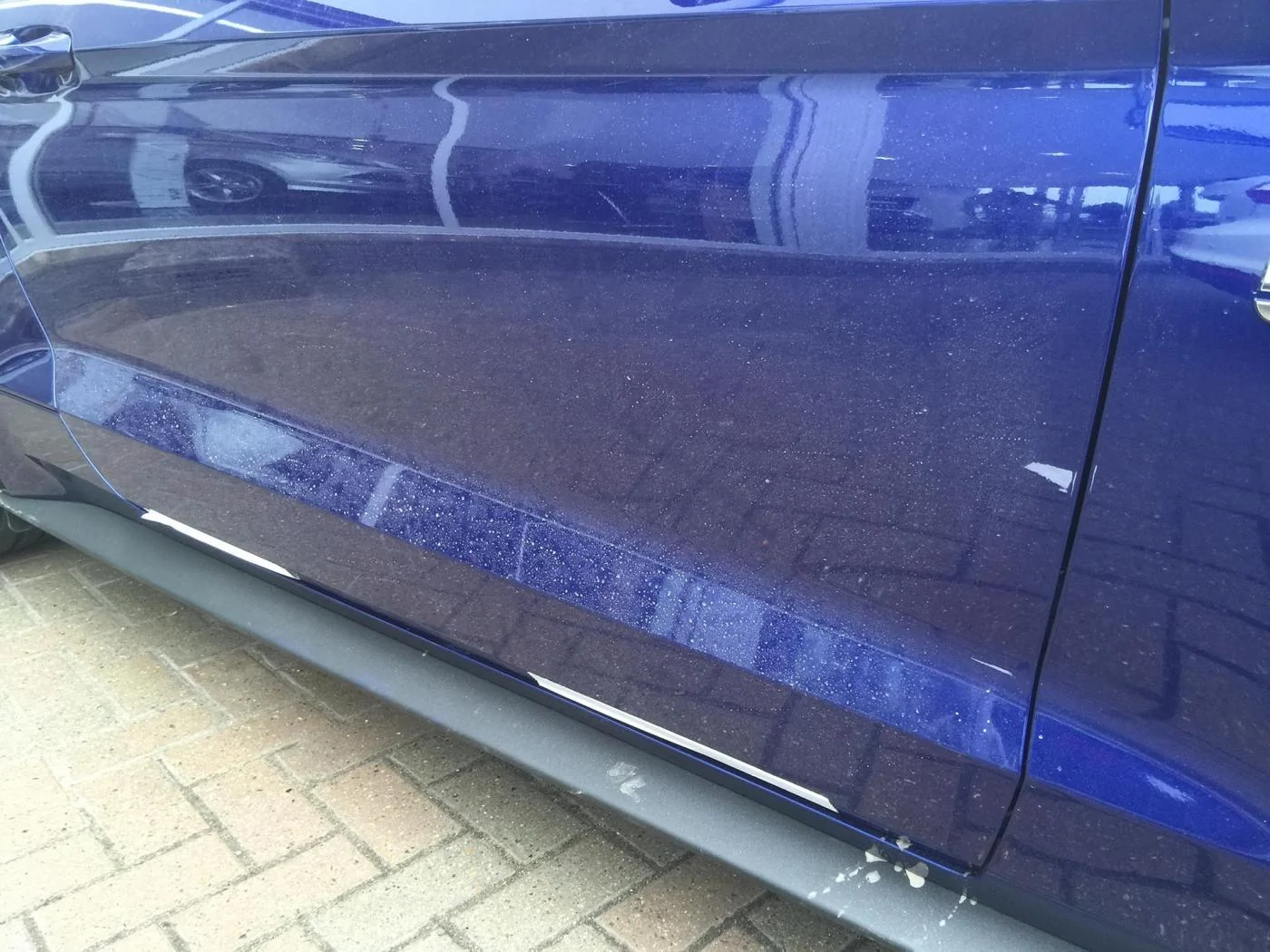

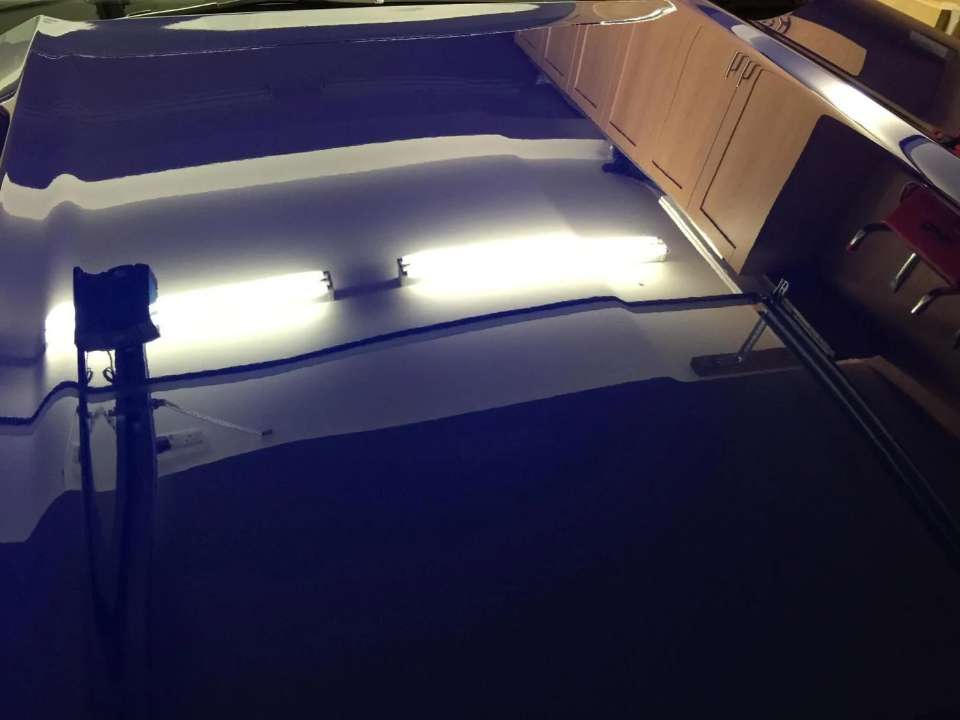

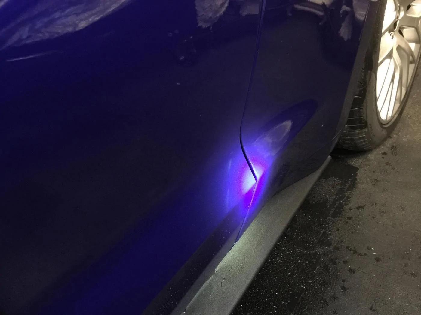

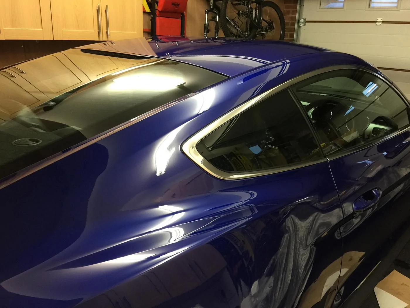

Claying done - it's ready for paint correction (polishing) and sealing tomorrow.
That said, mostly it's in fine fettle. Couple of pics showing the post clayed state to give you an idea. But will get some better ones tomorrow, hopefully outside.

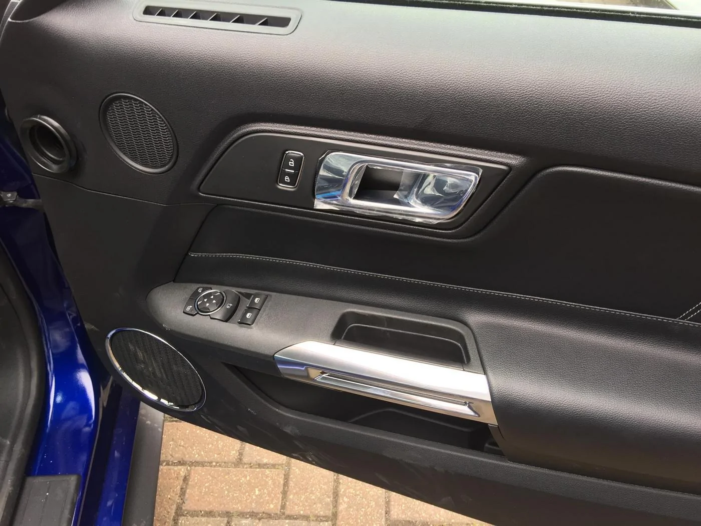

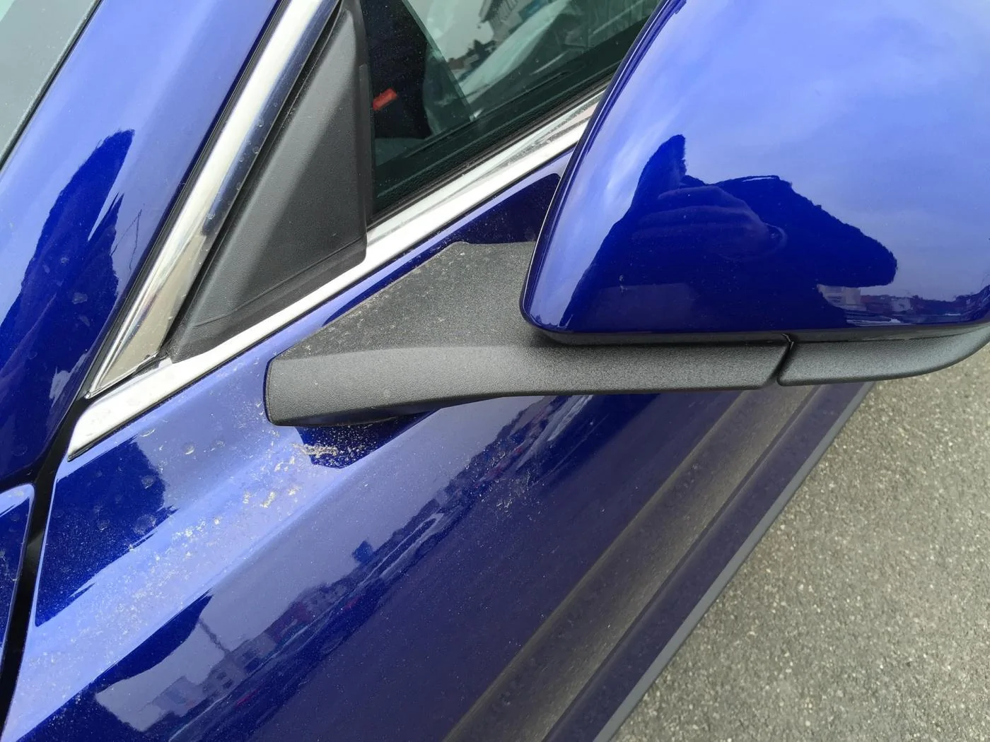

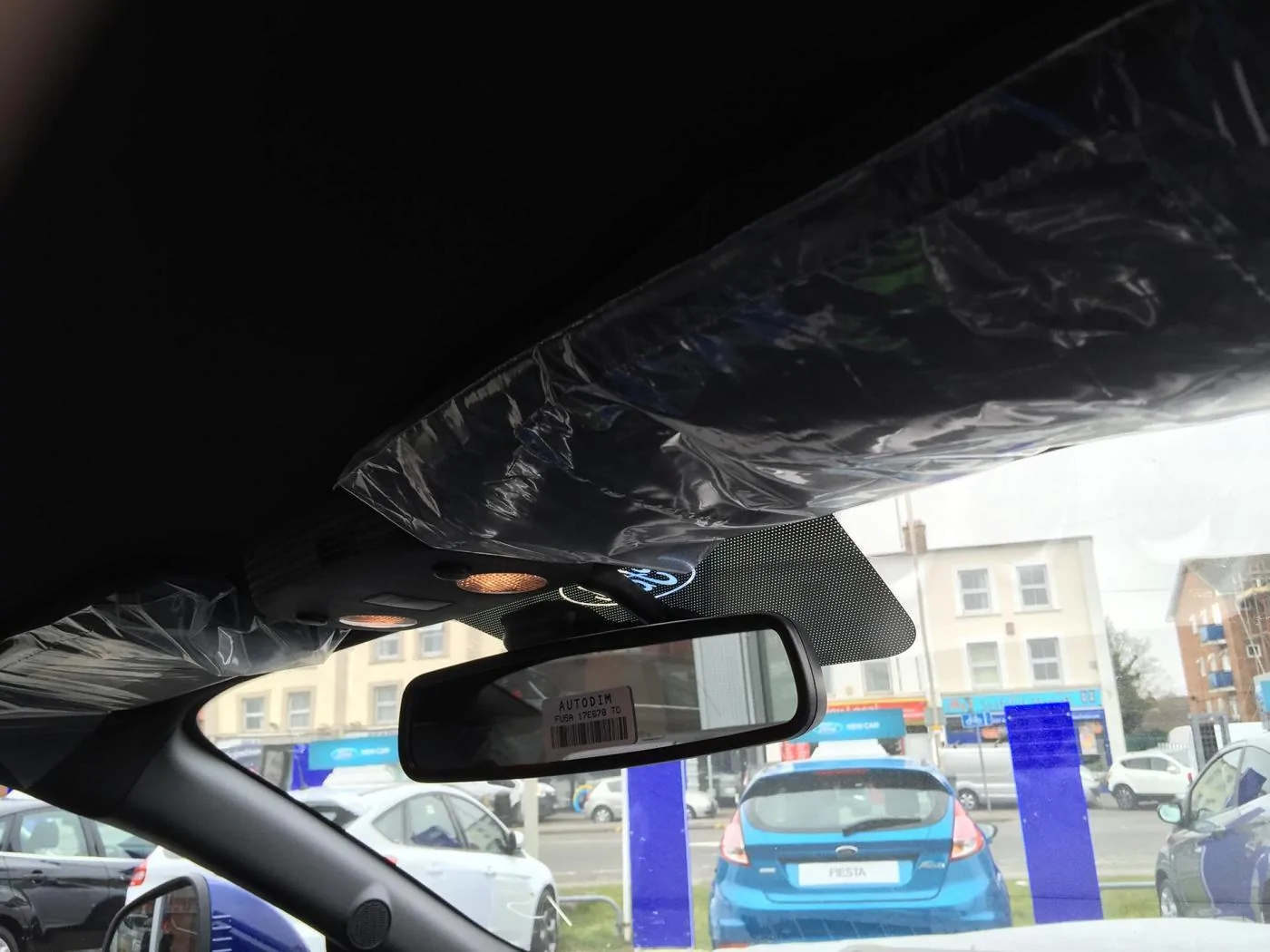

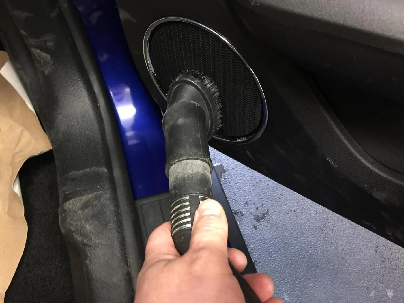

Oh I forgot - for the poster who asked why I prep the car and cited the crud on the speaker grille as an example, here's why ;)
Also forgot to add that all the windows had to be cleaned down with isopropyl alcohol to remove all the glue from the stickers. There's loads of it!

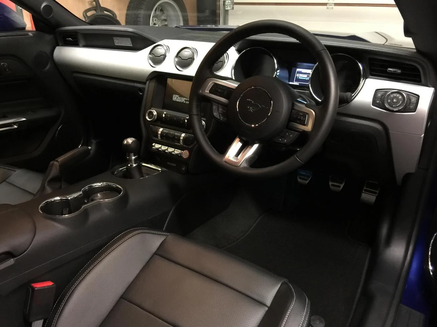

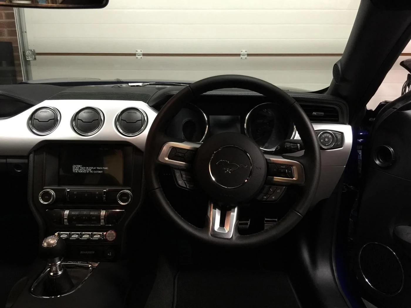

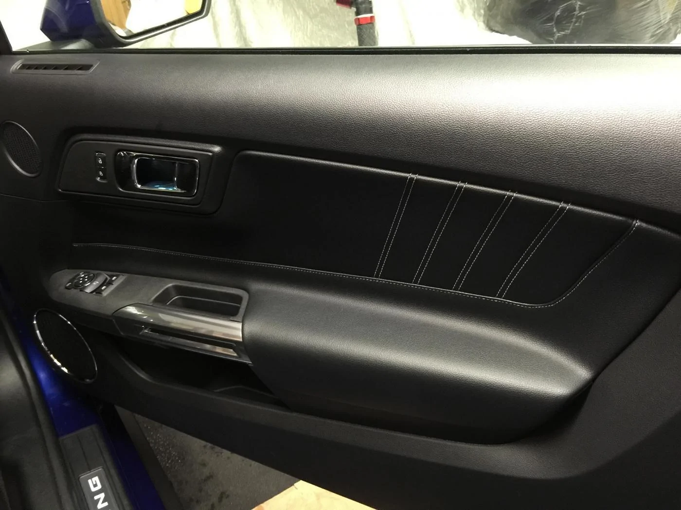

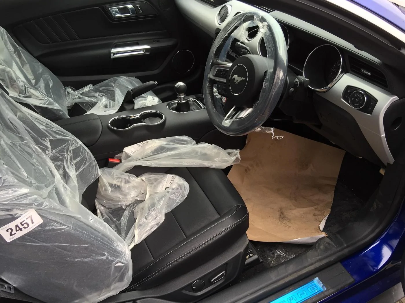

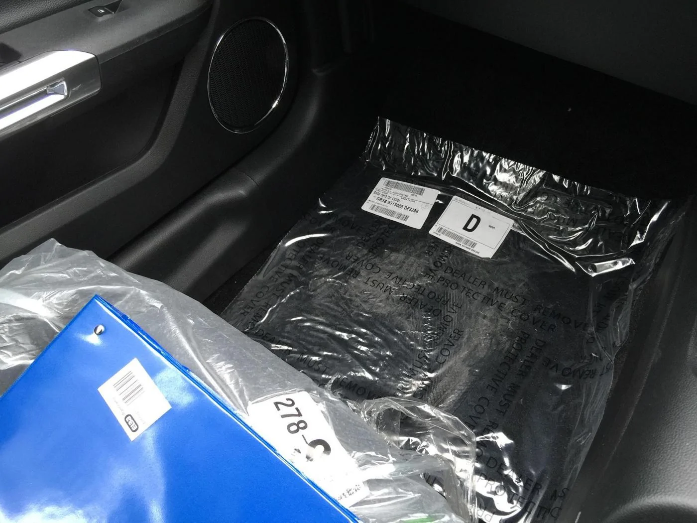

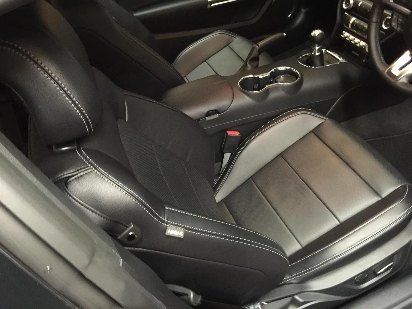

Interior (once stripped of stickers and protective film) just needed a hoover, wipe down, clean drivers door and fit the new mats.
Me I think :)
Very impressed by your knowledge and efforts and looking forward to pics of the finished article.
Still beyond my abilities however, step-by-step guide or otherwise.
