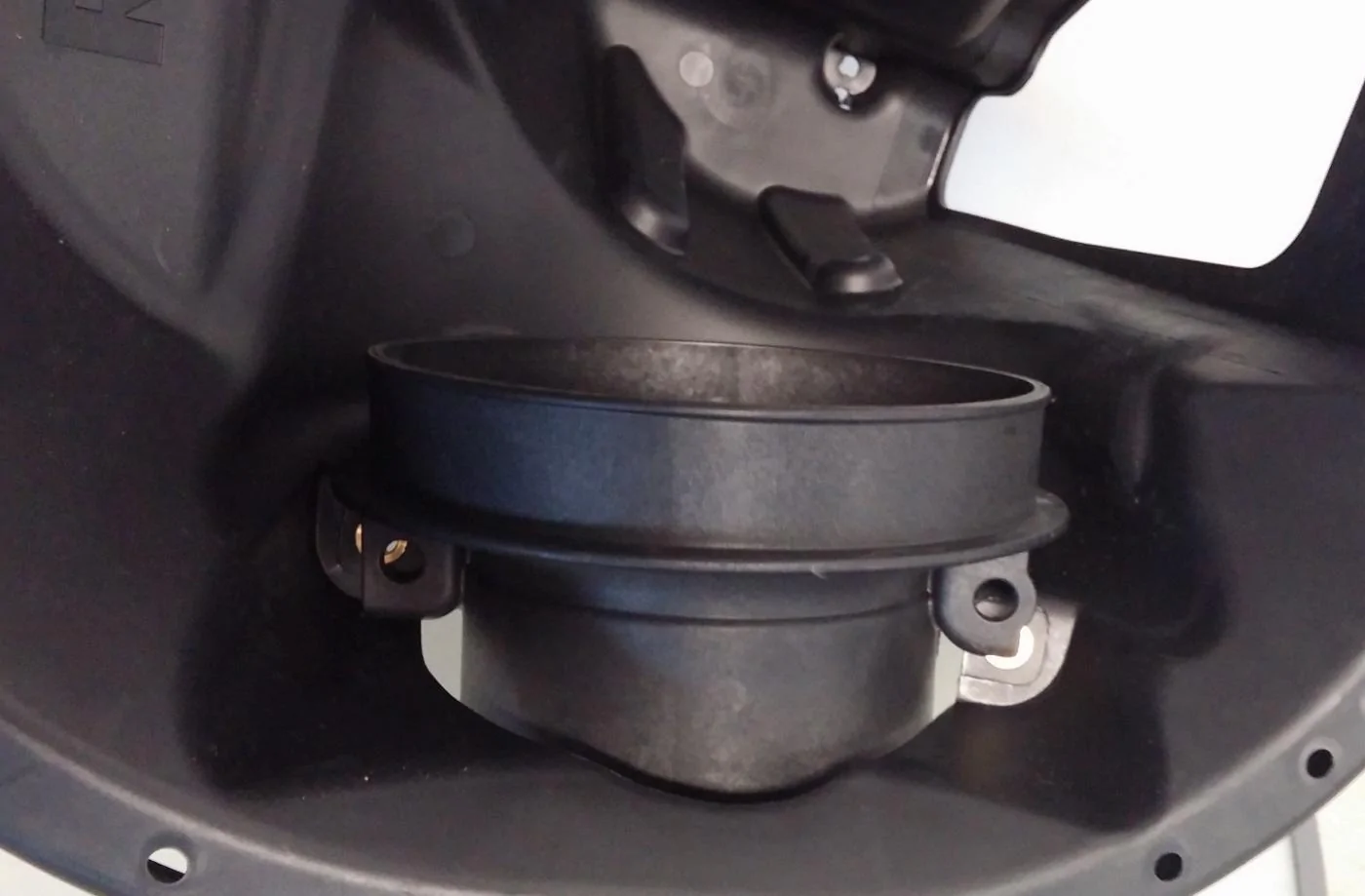

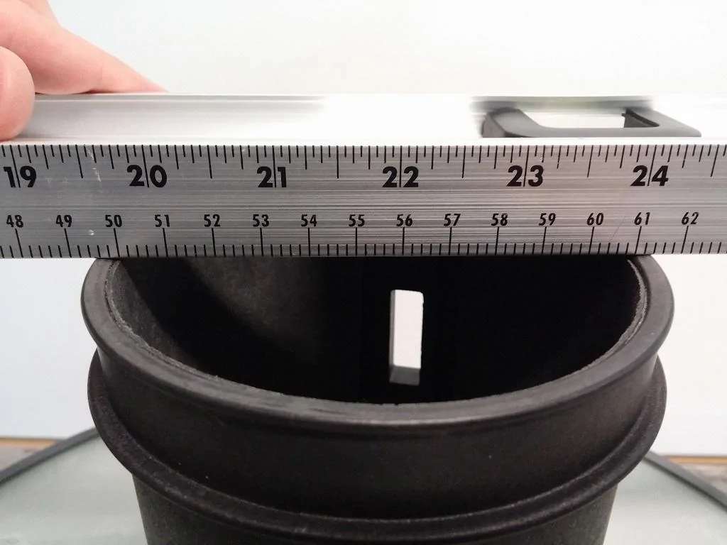

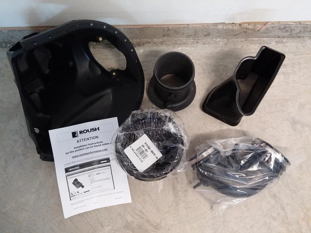

On March 4th, I ordered a Roush cold air intake kit for my 2015 Mustang GT from AmericanMuscle.com. It arrived on March 8th and upon opening the box, I discovered that the kit did not include the 85mm MAF insert tube that is supposed to be present and would allow me to use the kit on my car without a tune. Also, the 105mm MAF tube that was included with the kit appeared to have misaligned mounting holes on the sides of it that didn't even properly align with the holes in the air box itself.
After calling AM and telling them about the problem, they promptly sent me a UPS return label so I could ship the kit back to them. A brand new kit was sent to me this past Wednesday the 8th and arrived today. However, the new kit that was sent had the EXACT same issues as the first one. No 85mm MAF insert tube, and misaligned holes on the tube that was sent. This is INCREDIBLY frustrating to deal with, considering we're talking about a part that costs $365.
On both of the boxes that were sent to me, the ROUSH packing tape was intact and not tampered with. According to the sticker on the side of the box, both kits were "PROUDLY PACKAGED BY" an employee named Chris F. The part number on the side of the box is 421826, which matches the part number on both the AmericanMuscle.com webpage for the product and on Roush's own website for the kit. Something is clearly going on at Roush where kits are being assembled incorrectly.
To American Muscle's credit, they immediately emailed me return shipping labels without question, and this time around, instead of asking for another Roush CAI kit to be sent to me, I asked for a full refund, which was given with no questions asked, so kudos to them. I can't complain about them if they're just grabbing a pre-packed Roush box off a shelf and sticking a shipping label on it before having it loaded in a truck.

1) The entire contents of the kit(s) that was/were sent to me, showing the 105mm MAF tube, but no 85mm MAF insert.
2) Photo of a ruler with the MAF tube, confirming the inside diameter of ~105mm.
3) Photo of the MAF tube inside the filter box, which clearly shows the misaligned screw holes.

Looks like a systematical error in our packaging dept of the warehouse that caused a batch to call for the incorrect maf tube, thus the poor fitment and a tube with no insert.
