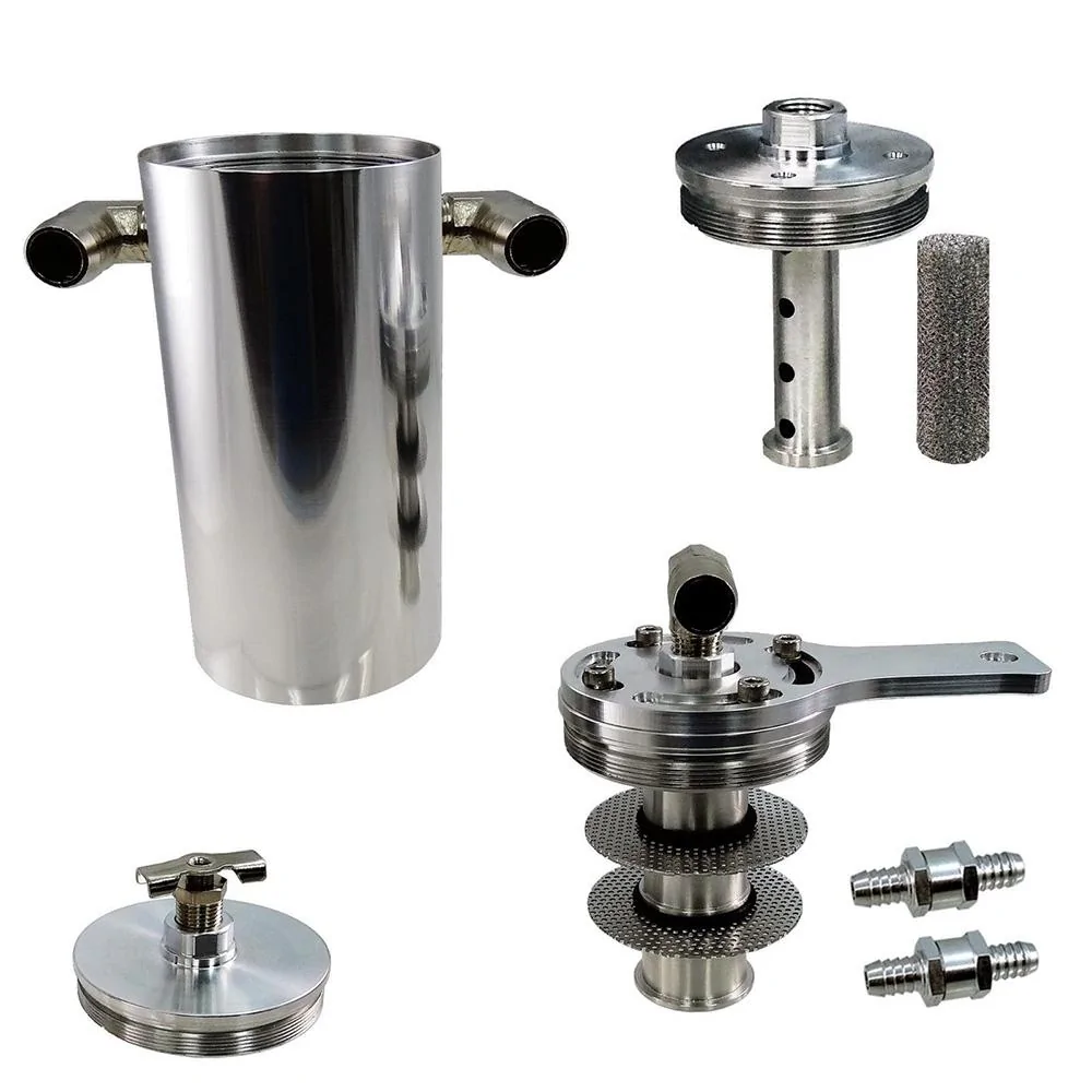

UPR has just released their Dual Valve Kit for the ecoboost mustang, that installs in 15 minutes using OEM Push Connect Fittings for a truly factory look. For those of you that are interested or have any questions please feel free to PM Me or you may place the order on our website.

I emailed UPR but didn't get a response... Does this kit hook up to both the driver and passenger side of the engine? Also, can you provide some better pictures of the kit including what the can looks like inside? The pictures available on your website and UPR's website aren't very helpful.
I will get more exact details tommorow, we are stuck waiting for our ecoboost so have not been able to install one ourselves. I do have some pics, I will get some more in the morning

Thanks for the pictures. I look forward to seeing the rest tomorrow. Do you happen to have the instructions for installing it also? I don't have my car yet so it's hard for me to visualize where everything connects.

Spoke to UPR earlier about the current catch can and discovered that a newer design was being released specifically for the 2015 Ecoboost Mustang. Still accomplishing the feat of correcting the PCV system, but in a design specifically for the Ecoboost Mustang.
There will also be a tandem upgrade available for this setup in the future.

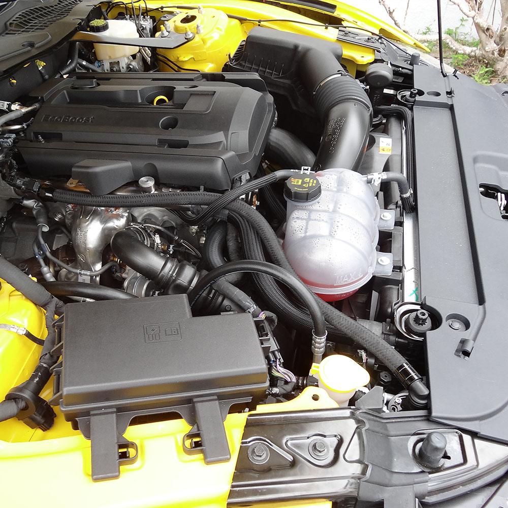

2015 Ecoboost PCV System Function and Flow Direction.
The system has a one directional flow that scavenges the clean air from the passenger side pickup on the intake tube right before the turbo and then get drawn through the crankcase and out the driver side swivel connection right above the starter coming out of the engine block. Then gets hooked to the throttle body to draw through the intake and get burned clean in the combustion chamber as per EPA regulations.
Testing was over 3000 extremely hard miles and testing it in every situation from cruising to flat out every day of testing. The passenger side yielded great results and the driver side stayed bone dry.
Ford has come leaps and bounds on designing the PCV system. But the driver side connection to the throttle body must be protected as it can really move some oil without a system in place.
The guys at MAK will be posting a complete set of pictures I just sent them.
If you guys have any questions as always please feel free to ask here, PM me, or email me.

Did some of that terminology get mixed up? The air goes from just before the turbo into the crank case (to where exactly? The port up top on the passenger side?) then it come out the bottom of the crank case on the drivers side and goes to the throttle body. That makes sense, but then they talk about the "dirty" side goes to some fitting on the oil pan but that was never mentioned as part of the air path to begin with so I'm confused.

UPR Mustang Single and Dual Valve Catch Can Explanation
Did some of that terminology get mixed up? The air goes from just before the turbo into the crank case (to where exactly? The port up top on the passenger side?) then it come out the bottom of the crank case on the driver's side and goes to the throttle body. That makes sense, but then they talk about the "dirty" side goes to some fitting on the oil pan but that was never mentioned as part of the air path to begin with so I'm confused.
The clean air enters on the driver side right before the Turbo inlet and then travels through the crank case eventually getting sucked out the driver oil pan / dirty side through the throttle body to get burned in the combustion chamber for EPA purposes.
So on a UPR Single Valve Catch Can System you would route the dirty line from the oil pan to the top of the UPR Single Valve Catch Can System. Then the clean line would run from the exit of the UPR Single Valve Catch Can System to the throttle body.
On the UPR Dual Valve Catch Can System you would route the dirty line from the oil pan to the top of the UPR Dual Valve Catch Can System. Then the clean line would run from the exit of the UPR Dual Valve Catch Can System to the throttle body.
Lastly the WOT connection would be on the second exit, hence Dual Valve system. This is what will allow the throttle body connection to close under boost so you don't pressurize the catch can. Allowing the WOT / second valve to pull vacuum from right before the Turbo through a second line that has vacuum during Wide Open Throttle to properly evacuate your crank case at WOT.
Hope this helps.
Hope this helps.
Joe
It made sense after I looked at the install instructions and saw that you have to drill a hole for the WOT side. I was trying to figure out where are the lines plugged up to existing places. Thanks for the explanation.
