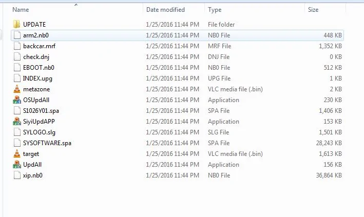

On that page it has instructions on updating the software with using the ZIP file that you can download from that same page. In that zip file it looks to be like files to completely restore the software with an updated version. The pic below is a screen shot of what is in the Zip file....
Now The question I have is it possible that those restore/update files could be used to reprogram the TomTop unit with their files?

I'd have to have a TomTop Unit to experiment with it further to know for sure. Just because it's not the same unit physically doesn't mean it wont work. What matters is that the components inside, cpu, processor, bios/firmware etc are the same.
If it is the same - Looking at the two units seems to be very possible. One discrepancy is the TomTop Shows an ARM A9 Cortex processor while the one you linked shows MT3360 ARM11.
Now, China based products don't always market correctly so there's that. If they're the same units it might be possible to flash it. But you would likely need to modify some of the checksums and possibly vendor information.
