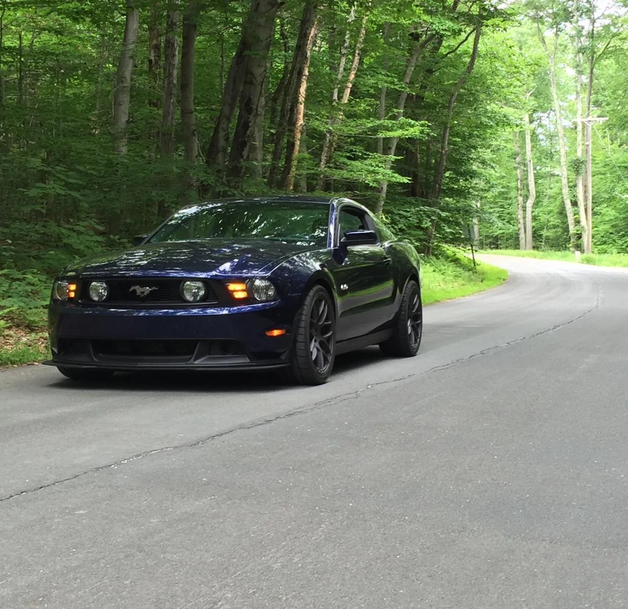

When shopping for tires for my stick-axle antiquated shitbox S197 (just kidding...I still love that car ) I found that with -1.5* of camber and careful wheel offset selection, I was able to comfortably run 285/35/19s up front with no rubbing at all. From what I read, this seemed to be just about the most I could fit without camber plates and more negative camber. I personally think the car looks much better with wide front rubber and the extra grip and (closer to) neutral characteristics at the limit are confidence inspiring.
And yes, I'm wondering if I should keep my aftermarket wheels or if I'll be able to use an even wider wheel when I bring home an S550.
