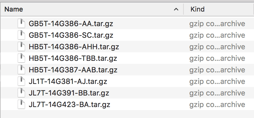

So, I had the same issue with my back-up camera as you. I downloaded 2.2 from the F150 link a number of pages back and installed it without issue. I had my back-up camera replaced yesterday, and installed 3.0 without issue. All is working fine now, but this is the first day, so we will see how things hold up. If I have any issues I'll post them.Thanks for the suggestion @HizliBullet , The last time I did have them leave the new camera installed but because they weren't able to activate it i have a new camera that i can't access :headbonk:
Any body have a download link to the old 2.2 version so I can load that up and have FORD activate the new camera then I'll go back to the version 3.0 :shrug:
