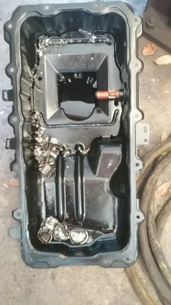

We have had a few in my area, good friend has worked at Ford for 30 years top mechanic. I stopped to visit with him the pic is a stock 5.0 no tune N/A. OPG broke and he has done several at least Ford replaced them with a new engine under warrantyIt's not failing in stock form on the Coyote, I hardly doubt they gonna change anything.

not according to this guy lolOnly OPG I ever seen break on a genII is when you bounce off the limiter like a tard.
Prolly the same guy on facebook bouncing the limiter for a minute straight, posted the vid on FB, then wonder why when his engine went pop the dealer denied warranty cause he.. and get this.. showed them the vid of when it went boom as proof :hail:not according to this guy lol

When Lund retuned my car after the GT350 manifold swap they upped the automatic WOT to shift at 7750. They advised me don't bounce off the limiter and I will be good.Only OPG I ever seen break on a genII is when you bounce off the limiter like a tard.
