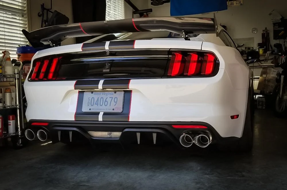

First, here is a before and after shot.

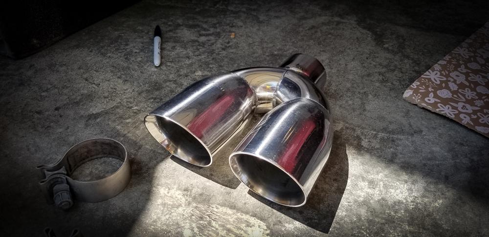

This is one of the tips that I am replacing the SLP single tip with. The cost of this tip is $28.99 with shipping and is sized to slip over a 2.5" exhaust. The only issue I had was clamping it down. It had no relief cuts in the tip to allow for the clamps to compress it. So, to fix that I just made a two 1" long and 1/8th" wide slices on the top and bottom of the flange. No big deal, especially considering the quality and price.

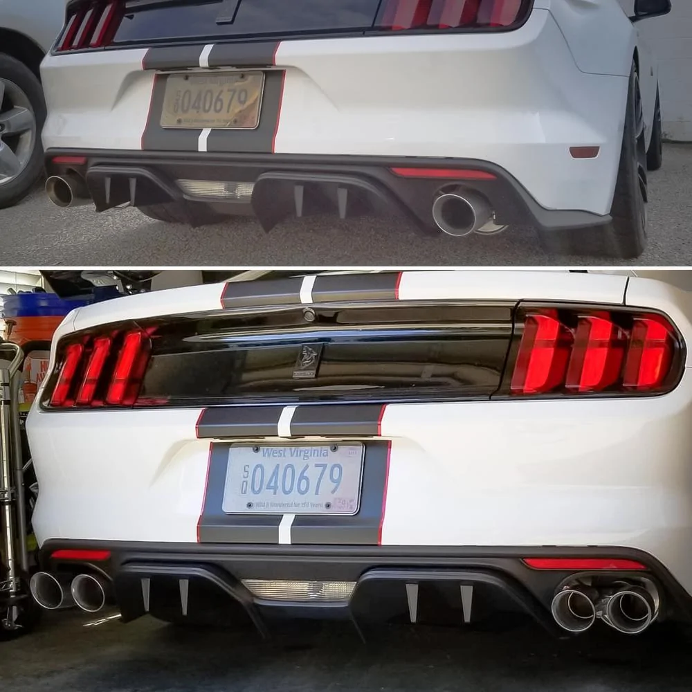

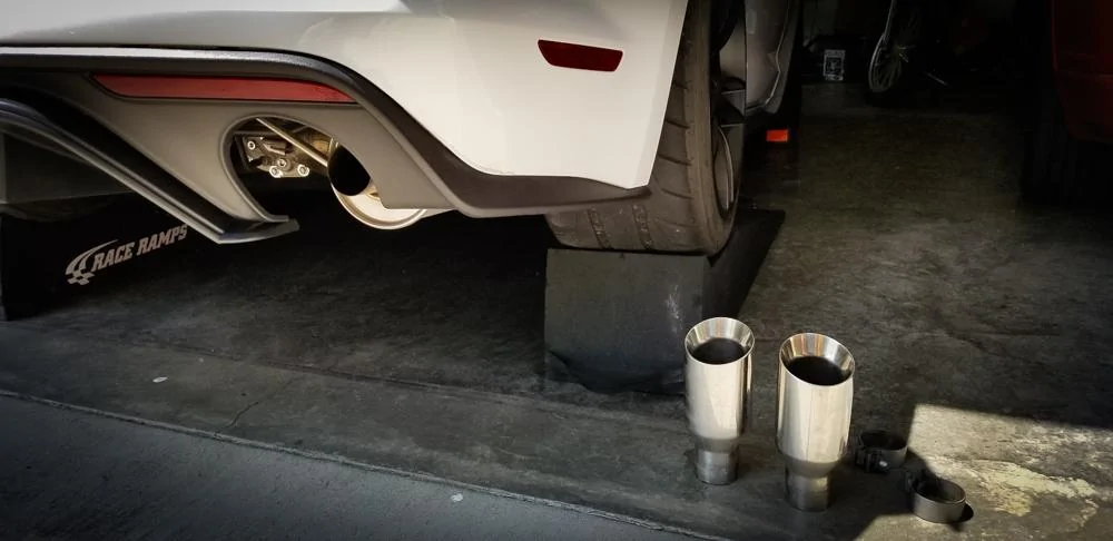

Next up, remove the stock tips.

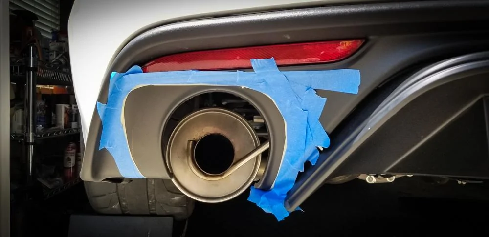

- Now I lined the tips up as best as possible and placed a few reference marks on the valance where I thought it would be wide enough, making sure to not go too large. You can always remove more material, but you can't add it back.
- Once I did that, I freehanded the shape with a sharpie, then taped it off. The tape is to help keep you on the right path as it will help guide the cutting wheel.
- I used 1/8th" wide tape to do the initial outline, then followed up with 1" painters tape to help keep the thinner tape planted.
- Once I had the first side cut out, I then flipped it over and used it as a template for the other side.

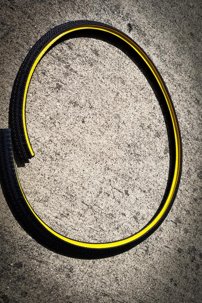

A shot of the trim piece that I used and link to where I found it on Amazon. So far I have driven the car about 40 miles, included about 30 minutes of a standstill traffic jam. There has been zero issues with the trim piece. It should be able to handle north of 250°F of direct contact, and I doubt it will ever see anything close to that.

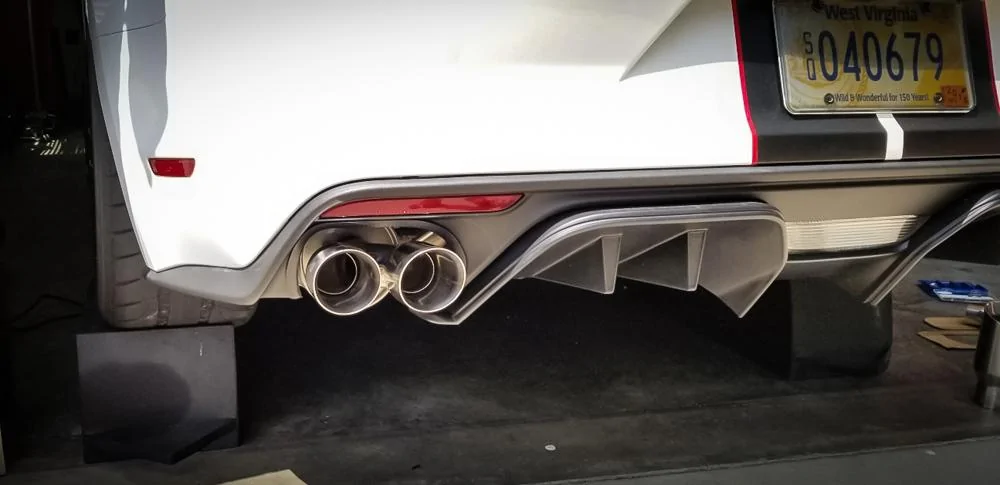

Now install the trim piece and slip the new tip into place for a test fit. If you need to remove any more material, mark it now then remove everything and make careful cuts.
