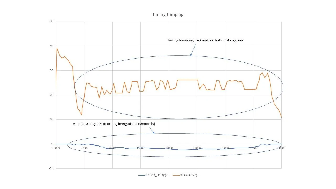

I also had the issue with power limiting while on the road course. It happened in my third twenty minute session. I could turn the car off and back on but as soon as I laid into the power it would do it again. I just practiced my lines with limited power. I went into the flare tool but all my limiting option are grayed out and I cannot adjust them. I opened the tune in hp and loosened up some of the temp related limiting and gave it some power enrichment and it made things better but I could still make it happen if I ran 10/10ths. It seems to be preceeded with a quick hesitation like transition fueling is off and then the car runs fine but will not make much power.
