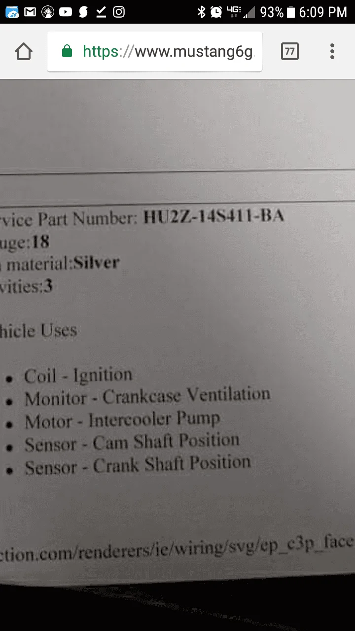

It all came as a kit from ford here is the part number to order. As far as making the adapters I could probably come up with something but I don't know how big the market will be for them or if it would be worth my time since we don't know what the price will do once the manifolds are back in stock. I the manifolds don't jump in price then I may look into it but the pigtails are like $18 a piece and that's just for the ones that plug into the sensors. Buy the time you add the side to fit the factory harness and making the adapters up and ship it would be close to $80-90. Once the plugs and pins become available in the aftermarket it would be cheaper. But right now there is no other option for the plugs I tried for 2 weeks to find other plugs while I was waiting on mine that were back ordered from ford.

I assume you needed to order quantity 2 of these?
What did you do for the 2 pin harness, just plug one in and leave the other?

I would gladly pay you that if it means not messing around with the factory cabling
At first I put one of the old soleonids back on the car and plugged it it. I have it unplugged now with no lights.
