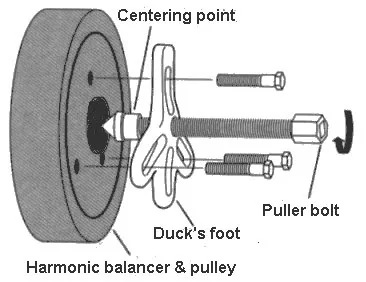

To remove the balancer you can rent a puller from Autozone like the image below. Thread the three bolts into the ATI and pull it off. Reinstall and tighten it all down in one go while you have the balancer heated.

Do you guys know the thread pattern on the long 12 point bolts? I need to get some longer ones in order to use the puller that I have. They aren't quite short enough to grab when they're place through the remover. Guess I'm off to Lowes. AGAIN.
EDIT: Never mind, I went to Autozone and used the puller tool that they have because that's what I did last time. It worked, but because I'm an idiot, I messed up the balancer in the process, and I stripped the threads where one of the AC pulley bolts goes. Also, all of the washers got totally messed up and bent in the process. Not sure how that happened, but at least I got the damn thing off! Also "good news," the stud that I was using to install the balancer is sticking out about an inch and a half, so I should be able to remove that.
