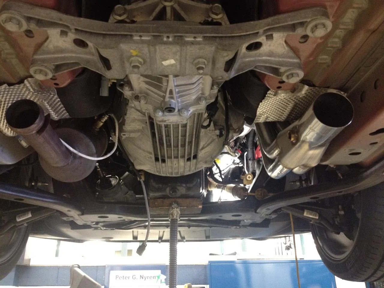

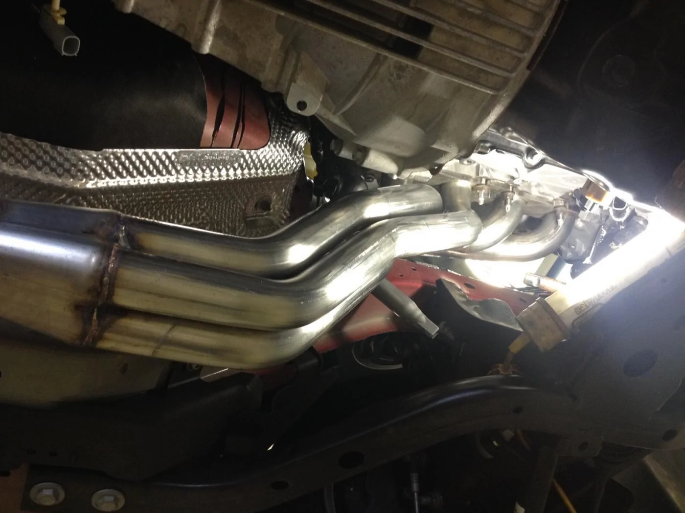

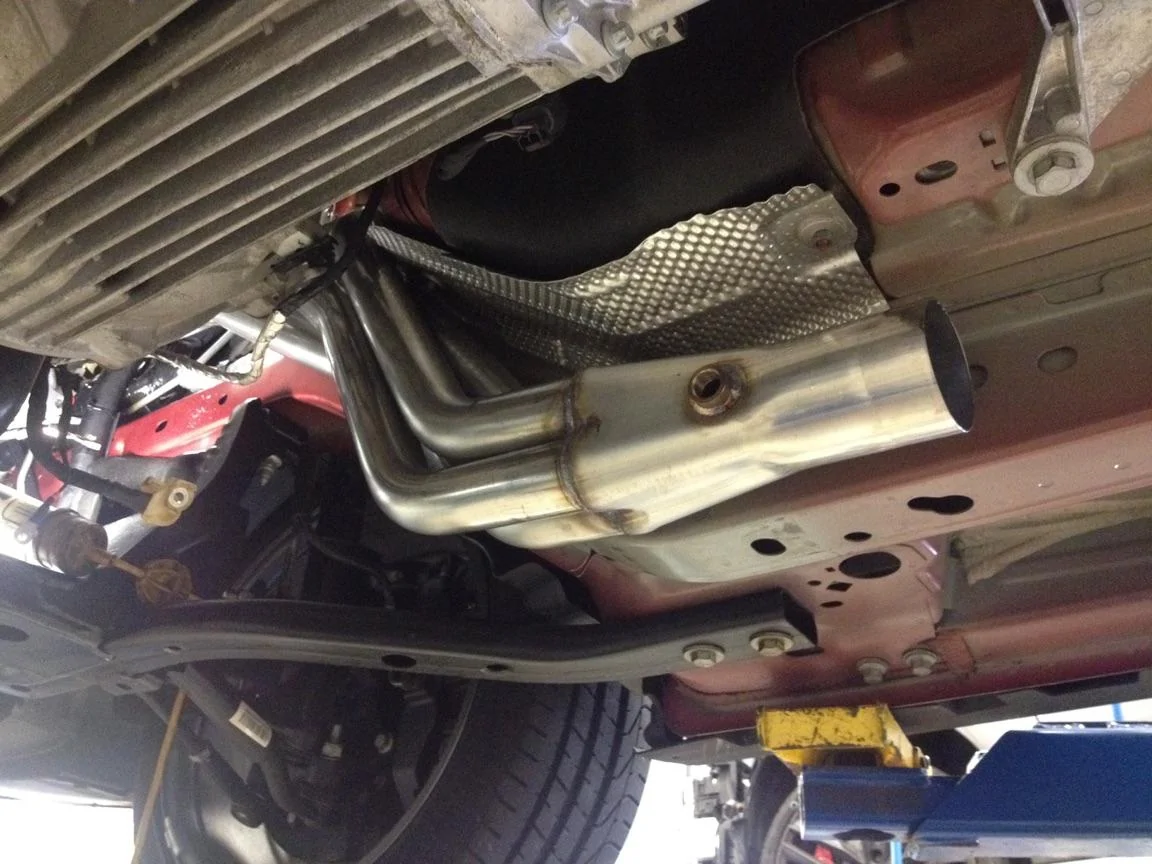

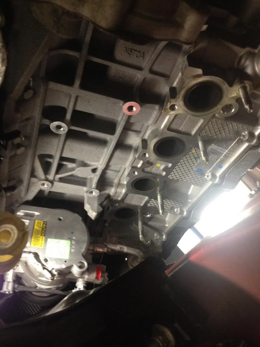

You will break it if you don't it is seriously in the way there are two lines there in the way the one that Unbolts right there in two places especially. My SN197 only had one line and you could bend it out of the way easily without breaking it.Why does the AC line need to be removed
[MENTION=6364]Twin Turbo[/MENTION] can you assist [MENTION=7311]Grimace427[/MENTION] with a password reset please :cheers:
gonna need another video with that ghost cam tune..
Is this for the OBX/TSP headers because I've never heard anyone having to remove it to install SW headers. Right now I'm going back and forth between TSP and SW headers. I'm trying to get whichever one is less difficult to install and has more clearance.You will break it if you don't it is seriously in the way there are two lines there in the way the one that Unbolts right there in two places especially. My SN197 only had one line and you could bend it out of the way easily without breaking it.
this is more of a "being overly cautious" sort of thing since I'm paying for the job to be done perfectly. :cheers:Is this for the OBX/TSP headers because I've never heard anyone having to remove it to install SW headers. Right now I'm going back and forth between TSP and SW headers. I'm trying to get whichever one is less difficult to install and has more clearance.
We broke it trying to get to the bolts on the stock headers the line is in the way badly it doesn't matter whose headers you will want to remove that AC line. There are two lines right there in the way that line worse than the other. On the older SN197 Coyotes you have one line not two right there and more room to move it out of the way.Is this for the OBX/TSP headers because I've never heard anyone having to remove it to install SW headers. Right now I'm going back and forth between TSP and SW headers. I'm trying to get whichever one is less difficult to install and has more clearance.
I'll leave what [MENTION=7311]Grimace427[/MENTION] is charging up to what he might decide to charge others, but it was very reasonable, and I know that since he does this on the daily as a Mercedes technician (ironically i used to also be a Mercedes technician) that he would do an impeccable job.How much are they charging to install!
